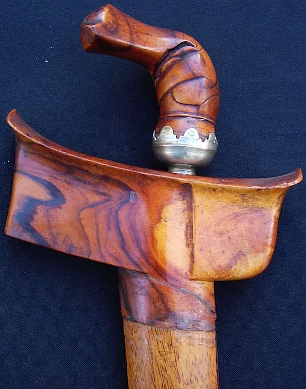

Hello! I purchased what I hope is a high quality keris as a souvenir during a recent visit to Kuala Lumpur. I have been searching for information about it online and so far, I’ve gathered that it is a Bugis style Keris Melayu manufactured in Terengganu. The hilt is the “anak ayam teleng” type. I was told at the time of purchase that the hilt and scabbard are made of rosewood but similar scabbards I’ve seen online are described as made of kemuning. Attached is a photograph of the keris and scabbard.
I cannot identify the pamor and I don’t know if this keris is truly high quality. Does the number of layers on the blade indicate much time and effort to manufacture? Any additional information shared will be greatly appreciated.
Best regards!

Welcome to the forum. From what i can see you have purchased a decent keris, worthy of collection for sure. Keris can be found in many quality levels and i would not necessarily classify this as "high" quality, but it seems fairly well made. What determines a high quality keris goes a bit beyond just the number of layers of the pattern welding. I will leave it to other to speak to the origins and classifications of this particular keris since Bugis keris are a little outside my focus. Better and more detailed photographs would certainly help though.

It does look like a nice blade. I'd second David's request for more pics! Close-ups are really needed to evaluate a blade and also try to narrow down the type of wood utlized.
As already indicated, it would also be necessary to define "high quality" - the highest quality was usually reserved for royalty. Even then, the highest quality for one region/sultanate might not be valued exactly the same elsewhere (and vice versa)... (Same-o with different eras, so period may also be an issue to keep in mind.)

Definitely a nice piece. The scabbard looks very recent (normal for most keris) and the hilt is rather crudely made. But it is the blade that matters.
If it were mine I would only change the hilt. Impossible to attribute an age from a photo and very difficult on visual examination. Few experts can do that. (I don't give you the names as I would not forget somebody....)

If this is a souvenir, you could say that this keris is certainly acceptable and decent. Well done!!
The ukiran is more Jawa Deman. A good Bugis ukiran is more the pistol hilted grip. I would try to get such an ukiran.
But it is a very nice keris suitable for every serious keris collection.

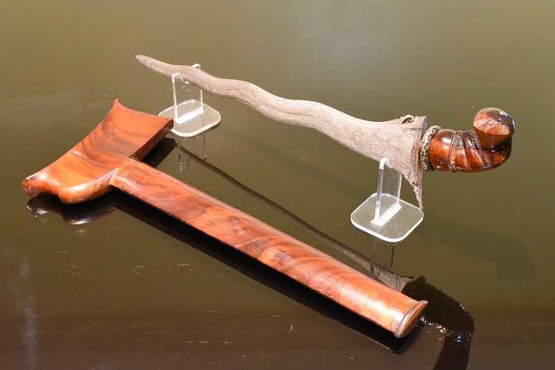

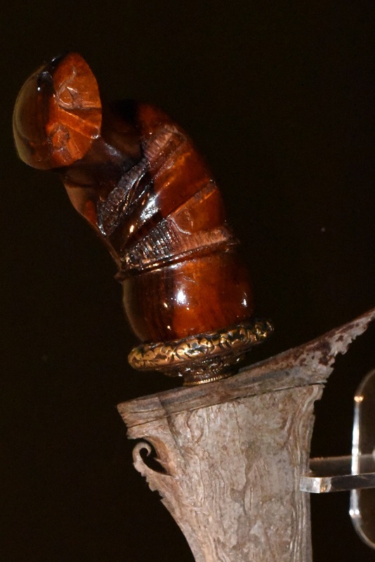

The anak ayam teleng is a JD variant from the Malay East coast. I'm attaching an antique example from my collection (sorry, pre-restoration pic with hilt still turned in non-typical direction).
Note the selut which would be typical for the Terengganu region and more suitable for this hilt type.

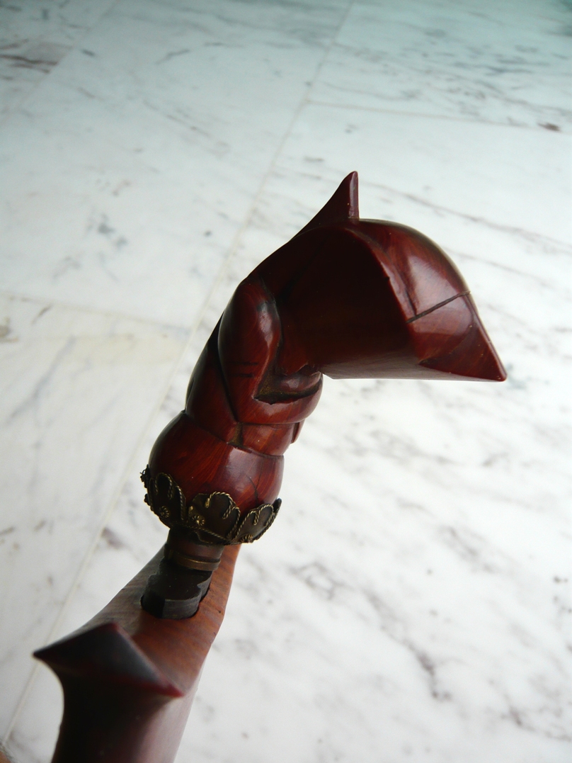

This confuses me Henk. This is a Bugis form of blade, but the Peninsula. As far as i understand it the right Bugis hilt would depend upon the area of origin for this particular Bugis style blade. I have seen many Peninsula Bugis blades dressed with Jawa Deman hilts. The style of hilt you seem to be describing is more correct for Bugis blades from Sulawesi and certain areas of Sumatra as far as i know.

Well, i don't wish to belabor this point much more, but Jawa Demam hilts are also commonly found on Bugis blades from the Terengganu area. Here is one that is not mine, but i have seen the blade and it is clearly of Bugis design. I also have one in my own collection which has not been photographed yet that has almost the exact same dress (hilt, cup and sheath). And i have seen many more like it from this same region.

Just to be clear Laowang, the hilt i posted just previous to your post is what i know to be called "anak ayam teleng". Can i assume you are talking about the hilt in my post? I don't believe the hilt that is currently on the keris in question is that type of Jawa Demam. We can't really see all angles of it, but i do not believe it has the appropriate back "fin".

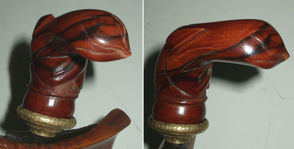

David, my understanding of the anak ayam teleng form below. Taken from the dealer's website.
You're showing the pekaka hilt which is a more northern Malay type, again a variant of the JD form.
The anak ayam teleng type is quite typical for Terengganu though.

"The most important keris form to originate in the Kelantan-Terengganu-Pattani region is the tajong."
This confirms what I suspected, and I thank you Kai for reminding me of SofW.
The word "tajong" is actually the name of a kind of fishing boat, and the form of a keris tajong scabbard is very similar to this boat, so I think we will find that the keris gains its name from the scabbard:- it is a tajong scabbard, and a tajong keris --- just like Jawa terminology:- a ladrangan wrongko, thus a ladrangan keris.
But what sort of hilt is it?
Regrettably the authors of this wonderful book do not give the hilt a name, they refer to it as "hilt, keris tajong" or "hulu keris tajong", in other words the hilt of a keris tajong, so the name tajong hilt is actually a descriptor rather than a name.
Prior to 1936 Gardner wrote this about the hilt now known as the hilt for a keris tajong:-
"The hilt developed a big head with such a long nose that it has been mistaken for a kingfisher; but it is really intended to be human, and there will often be found tiny arms clasped around the body"
It is clear that Gardner knew exactly what he was writing about, and that people in Malaya prior to 1936 did refer to this hilt as a pekakak. It is equally clear that he was familiar with the hilt now known as a perkaka but he had no name for this, he just referred to it as the Northern Type Jawa Demam.
Very clear indeed that Gardner wrote exactly what he intended to write and simply reported what he heard from people living in Malaya at that time. The Two Niks seem to think he was confused, I'm sorry , but I see no confusion.
Gardner did not suggest that the pekakak hilt form was based upon a bird, he was well aware that it was a representation in the wayang art form of a human, what he said was that it was mistaken for a kingfisher, not that it was one.
I do accept this:- at the present time the hilt previously known as the pekakak (pekaka) form is known as the hilt for a keris tajong.
In light of what I read in both SofW and Gardner as well as several Indonesian publications, I cannot justify holding an opinion that this hilt form was never known as a pekakak form in Malaya.
Similarly, I have not previously seen nor heard this Northern Jawa Demam form referred to as anything other than Jawa Demam, however, if at the present time it is believed that the correct name is "perkaka" , I do accept this as correct current terminology. However, looking at this Jawa Demam form and trying to see any resemblance to a kingfisher is totally beyond my powers of imagination.
I note that The Two Niks have used "perkaka". Although Indonesian is a form of Malay, and the two languages are mutually intelligible, I do not speak or write formal Malay, so I needed to go to several Malay dictionaries to check "perkaka". I could not find the word, so either we are looking at a printing error, or an error in the original text, or local dialect, or perhaps a newly invented word constructed to apply to this Jawa Demam hilt form.
About Bugis and Malay hilt form terms.
Again my thanks Kai, Bugis term : Malay term, yes, or course, I did not even consider this, I was thinking in strictly Bugis terms, for, as we are aware, when we speak of the Bugis people we speak of a culture , rather than a geographical location.
What you say about the "perkaka" form being absent from Bugis usage, might well be true, even though it would seem that Bugis keris do exist that use this form of hilt. I was coming to the same opinion as yourself, but there are a couple of pics of hilts in the Bugis book that look like pekaka type to me, but I'm probably wrong, because the camera angle doesn't show enough of the hilt for certainty.
