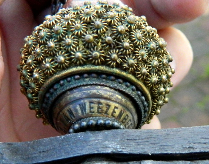

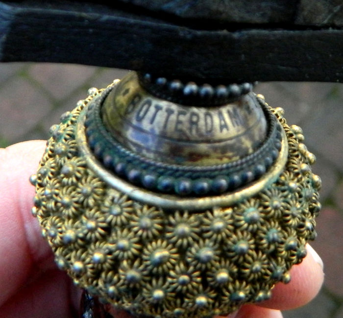

Here are 2 more pictures of the selut/mendak combi.
The selut looks recent to me as well.
And the mendak also looks like construction of not matching parts.
Original sorsorran and meniran . but the part with the inscription looks very western european in my opinion.
I would not be surprised if this was part of an office stamp used at the bank.

Originally Posted by David
Willem, i can only read parts of what is written around the mendak. Could you write it out for us. I see what looks like "Rotterdam" and then maybe "Weezenber" (???) but i can see there are more letters involved.
Hello David,
* VAN WEEZENBEEK * ROTTERDAM
