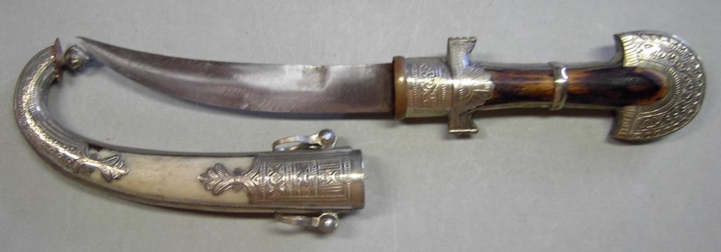

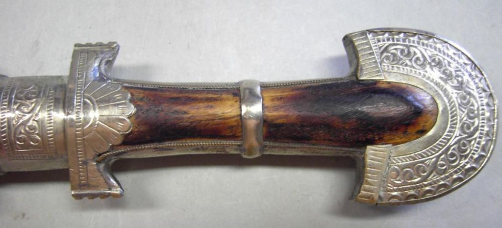

I was lucky enough to buy three koummyas which I'd like to show here hoping that members are able to state how old these pieces might be. The biggest of the three has a total length of 470mm and ist blade is 280mm. The smallest one is made from silver with camel bone in the sheeth. It has 300mm and the blade is 154mm.

Late 20TH C.
Old 19th August 2016, 02:48 AM   #4
Posts: 7,416
Yup!

No sign of wear / use at all.

You have roughly, 3 kinds of koummiya
1/ the 19th ones with a good blade, most of the time a bayonet or a piece of a sword, good grip, good pommel
2/ the 1900-20ties ones with new material such as amber/bakelit
with very often a stamp on the ricasso
3/ the post 1950-60ties like the ones above

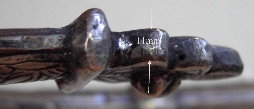

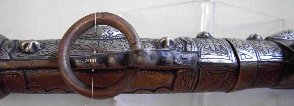

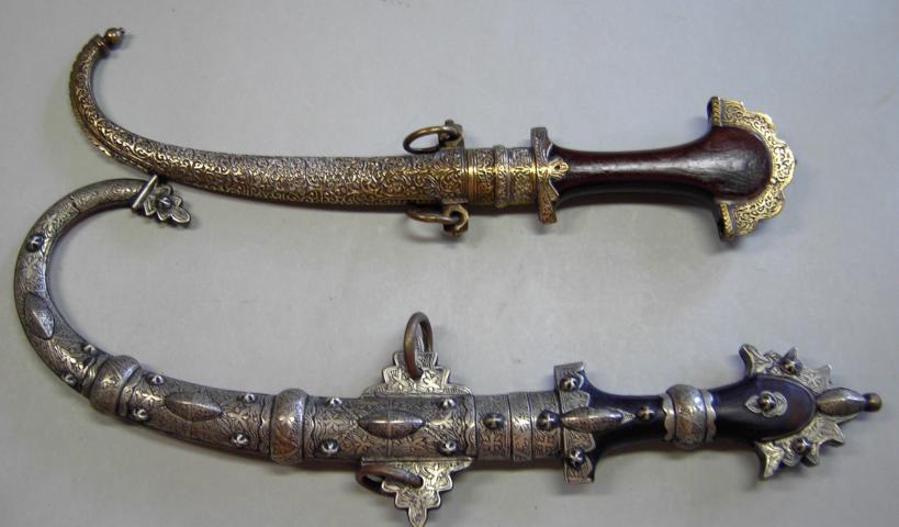

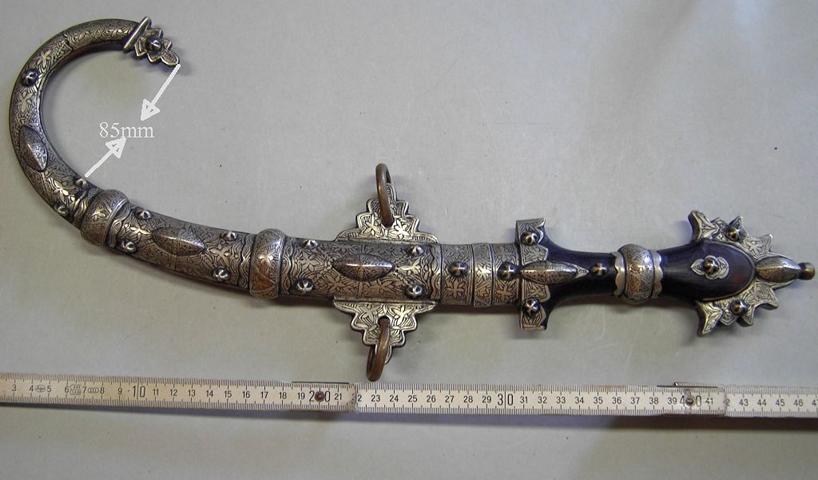

I agree with the two smaller pieces probably made more recently, but I cannot agree with the big one having the same age. This is a very massivly made piece with a weight of nearly 500g, made of bronce (no brass) and iron sheet with an average thickness of more than 1,00 mm.
As Kubur says, " if for example the grooves on a blade were not chiseled by hand but machined with a rotating tool" this would be a sign of modern workmanship. That's ok, but with a normal magnifier one can see the traces of the knife that has cut the grooves in this blade.
Some more pictures - two Fotos in comparison with an old koummya of normal length - may help to clear some things.
