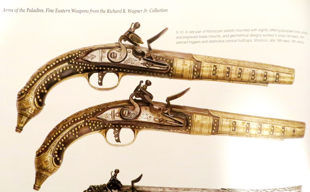

I have seen these pistols in your book.

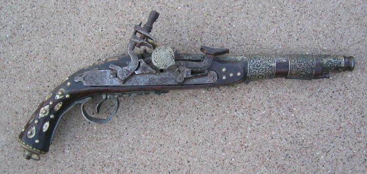

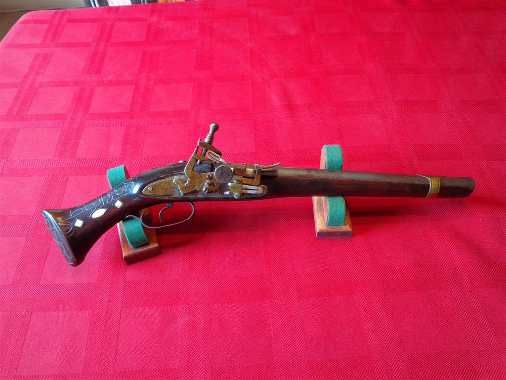

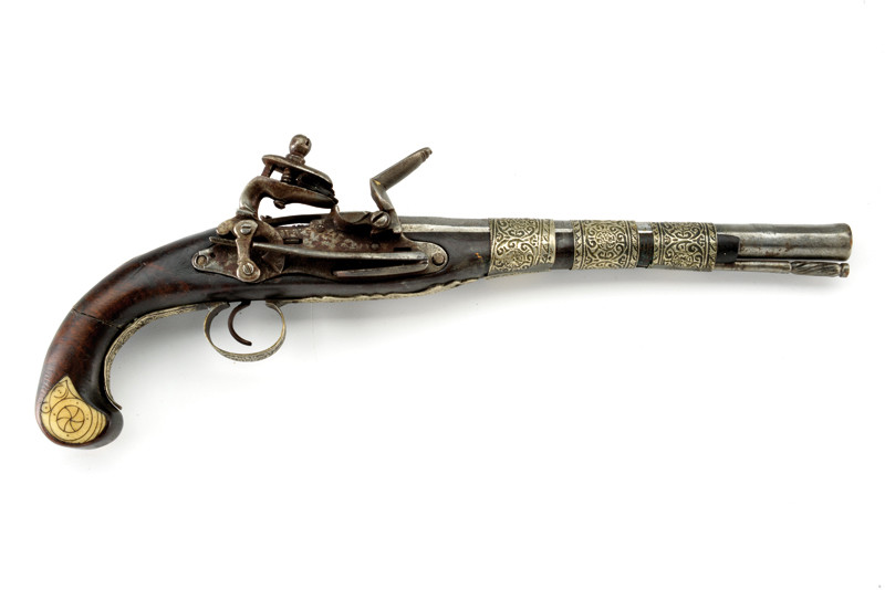

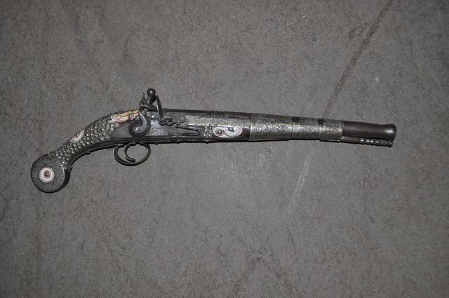

The photos, the first pistol is what you said Oliver, the others are typical Moroccan pistols, 19th c., very similar to those of the Riff and the Moukhala rifles...

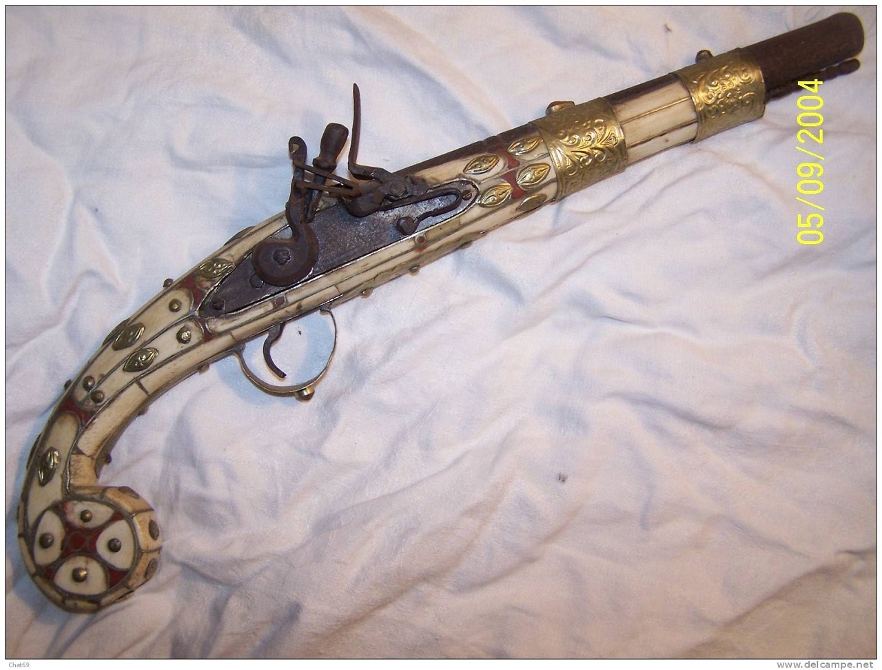

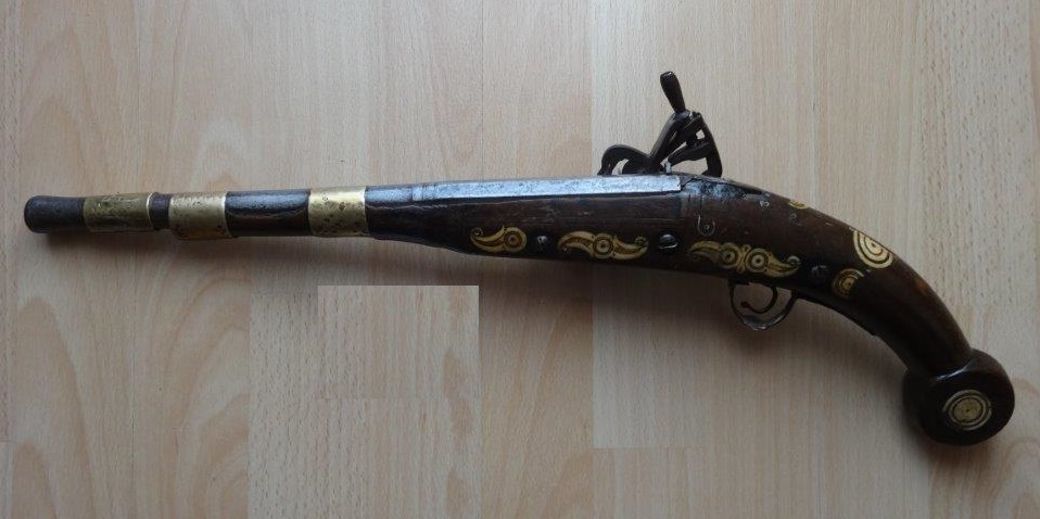

The later, 20th, tourist piece? that I promised...

In order to discuss these seriously, Kubur, better pics are called for. It would be interesting to see additional legitimate forms of Moroccan firearm emerge, however as it stands, none of these inspire particular confidence as to age or "fireability" except the last one in your earlier post, which is not only authentic but quite early-- it retains the original form of the English and Scottish pistols on which it was based, and is certainly datable before 1800.
Authenticity is contextual; one has to take the cultures which produced them and their intended purpose into consideration. For example, as you mentioned, if pistols of this form were made as props to be worn at traditional celebrations, then they may be "authentic" accoutrements, even though they were never intended to fire... and so on. I saw a vast number of these with circular butts in Moroccan souks, as I'm sure other forum members have. Are you able to examine any of them in hand? As for the last piece you pictured, yes, it's clearly contemporary. But that doesn't necessarily legitimize the others. Remember that there have been trinkets for as long as there were travelers to buy them. And that is a very long time. The example you show with a miquelet looks like a reasonable copy of a Spanish pistol, and the one following that evokes Belgian military pistols, but again, it's hard to tell much about their age from the pics. Then there is the question of what constitutes a form, and what is just a local copy.
What defines a tourist item also hinges on perspective: If you and I buy a well made and embellished contemporary dagger from a stall in the Meknes souk while a Berber next to us buys a similar one to wear to a wedding, is it a tourist piece because we bought one, or authentic because the Berber did? Too many factors play into the question, I prefer a simpler approach: Is the object intended to be used as a weapon, and how old is it?
It is wrong, the shape is older and goes back to the Wheelock’s pistols, not only the British ones, may be more familiar to you. More seriously about authenticity, we all know that. May be you didn’t get my point: you have another model of Moroccan pistol who is clearly not the one that you published. The pair that you published is North African, probably Moroccan. The circular butts are more common in Morocco and were indeed reproduced for parades or touristic purposes. I think also that the last one of the first series is older may be 18th c. The others pistols are 19th c. Yes, I showed one miquelet who is a copy of Spanish pistol due to the old relations between the two countries, Spain and Morocco. The miquelet called also snaphaunce for North African long guns. Please, to learn, it is important to listen others and to not be so categorical or haughty. Despite my comments I agree with your last sentence of course!

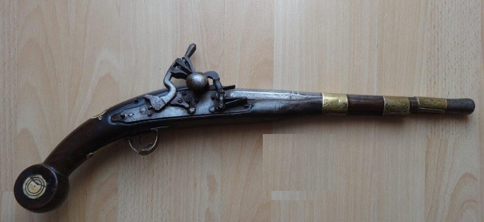

Another Moroccan pistol of mine

Just a pic....
