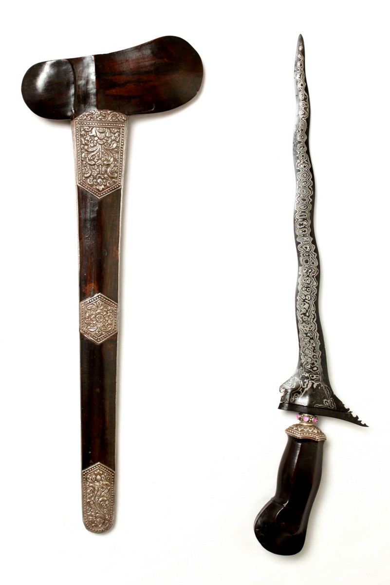

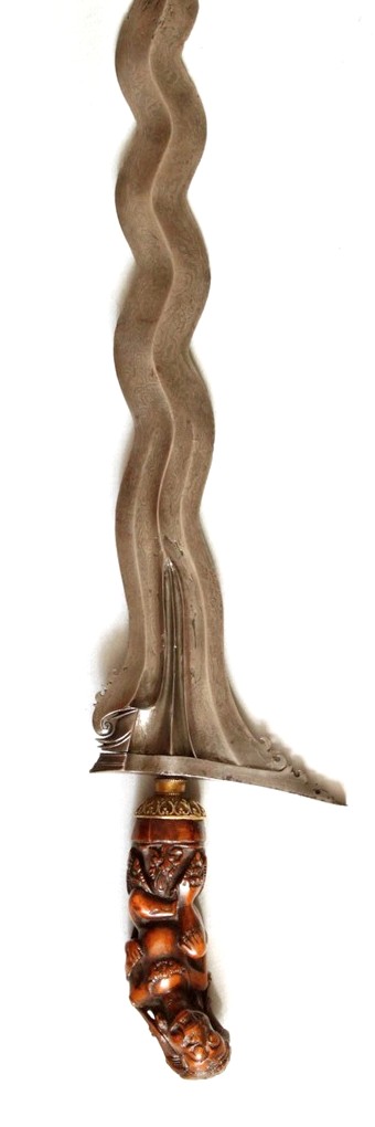

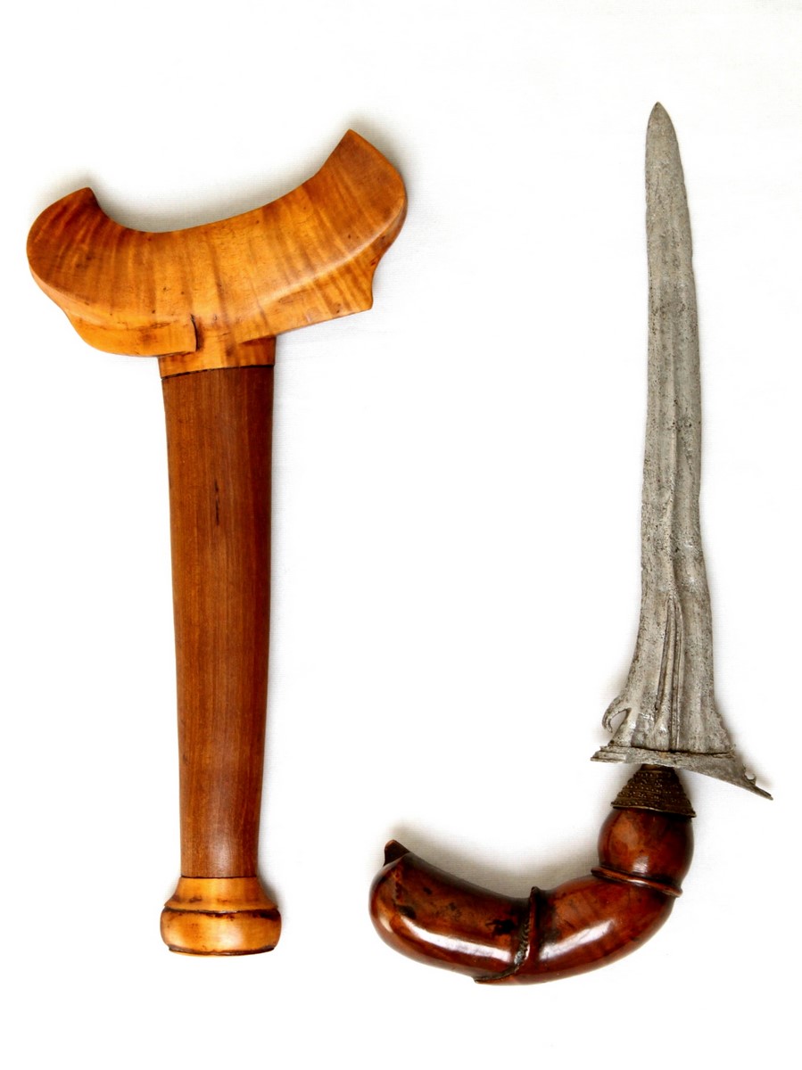

I attach my contribution with 3 unusually sized krisses:

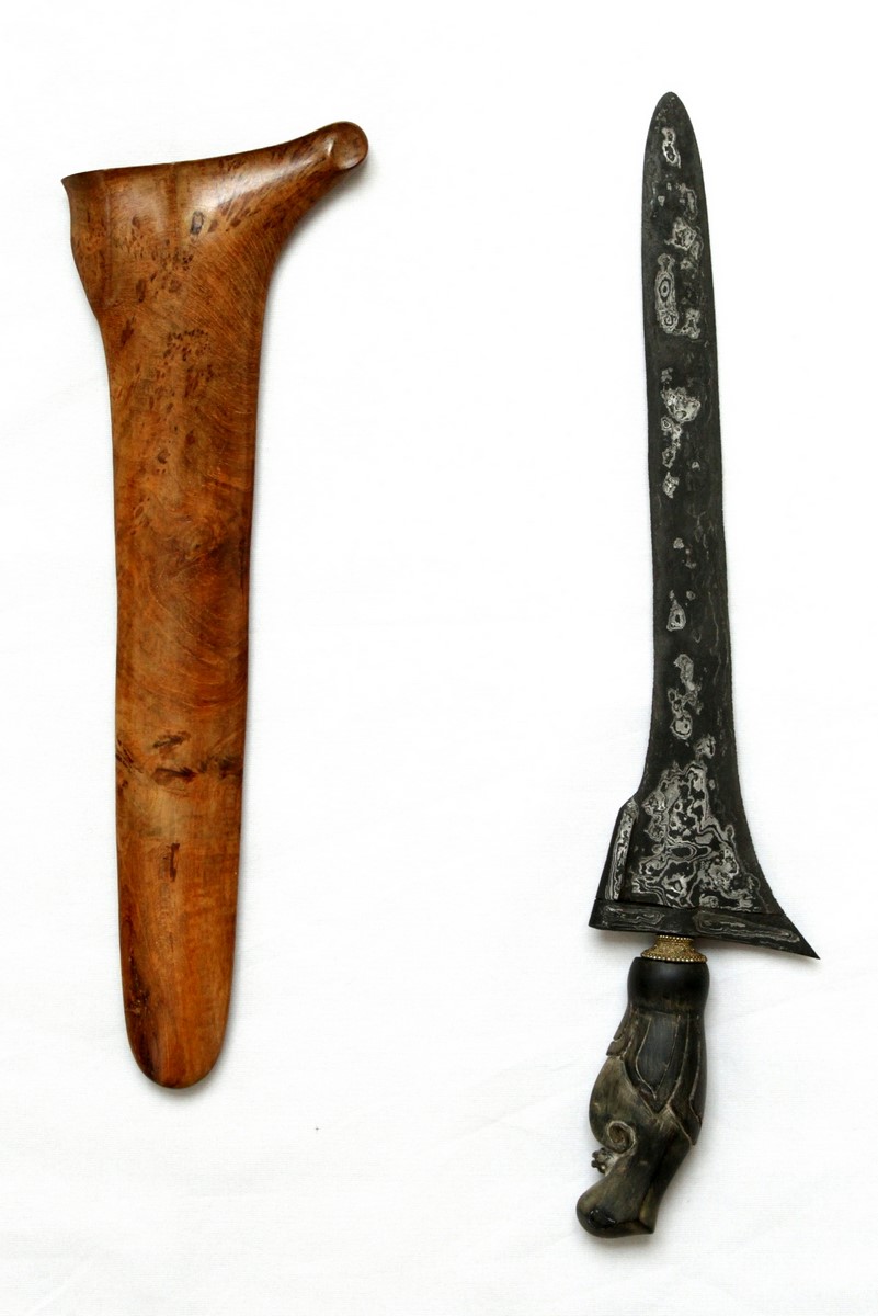

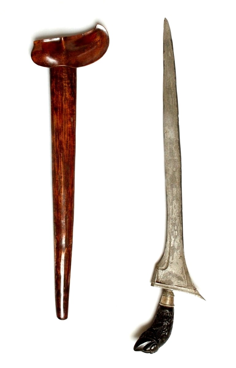

. A typical large kris from Cirebon or the pesisir (blade lenght 47.5 cm).
. A relatively small balinese kris (blade lenght 36.5 cm, it has typical balinese features, however it may have been forged in Java or Madura).
. A small Minangkabau kris (blade lenght 22 cm). These krisses are often attributed to women but I saw several pics of such krisses worn by Minangkabau grooms.

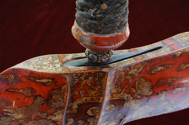

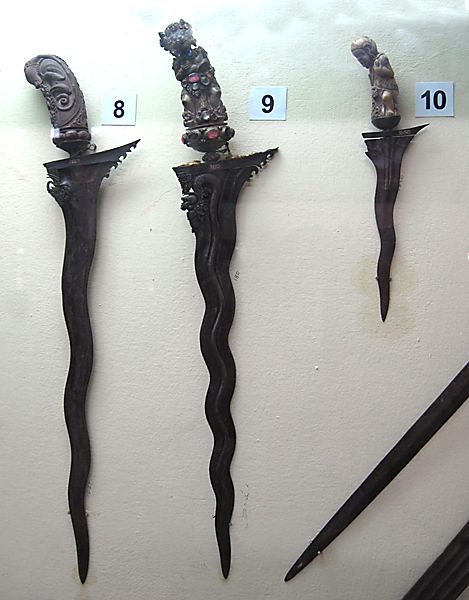

The photo I've posted is of a display in the Den Pasar Museum. You can see a couple of Bali keris of the size that we think of when we think of Bali keris, and another very much smaller keris.
The smallest Bali keris I have is 17.5" (445mm.) overall, and with an 8.4" (212mm.) blade. 5 luk., it is definitely Balinese and definitely old, I estimate probably pre-1800.

My deepest regrets Jean, but i am afraid you're just going to have to trust me on this one. The vast majority of my keris blades i choose not to post in public forums on as a matter of principle. While that sometimes causes me a twinge of guilt when others are so free with their postings, it is still my personal stance on the matter and not one i wish to change at this point. Whenever i have broken this rule i have always had regrets on that decision afterwards. So my humble apologies.
I can show you one image that shows the top of the blade in the sheath, but i am not sure it will satisfy your curiosity. However you might be able to at least see that it is not the meaty Bali keris we are most used to.
If this blade was not made in Bali it is probably from Lombok. It does not look like anything i have ever seen from Jawa or Madura and has clear Balinese indicators.

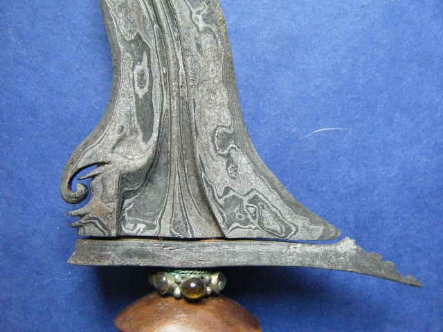

Hi David,
Thank you for your picture and it tells quite a lot actually.

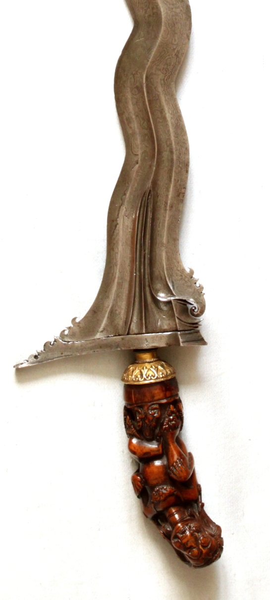

My idea at the moment is, that in the 1500ties there are should be some amount of very big, beefy blades, which are quite impractical as weapons. So I think, I can not agree with the "romantic" idea of big Keris as "Warriors Keris", if this idea includes the practical use of such Keris. As Alan pointed out, Keris Bugis are often normal or smaller size, and Bugis are perhaps the last people, who apparently used Keris as weapon.
During the 1600ties the size of Keris has diminished, and perhaps it could be so due to growing influence of Central Javanese court of Mataram/stratification of society.
Hello Gustav,
Is this big, beefy blade (attributed to Blambangan or Banten?) as old as the 1500ties (16th century) in your opinion?

Could you perhaps also post the dimensions of it? If the blade has been shortened, the length of Gonjo ? From pictures I would say more probably 1600ties and it has something, which let me think of Sumatra (I am speaking about blade only). yet this isn't even speculation, just fully unsupported feeling.
There are more substantial specimens, and the most prominent one is the Keris from MVK in Vienna. The blade is 44 cm long, Gonjo 9 cm long. It is mentioned 1607 for the first time. The blade almost don't taper till the last Luk, if you see or handle it, you have a feel of a Moro blade.
I own a very similar blade, also 44 cm long, Gonjo 10,5 cm long, width just before last Luk 3,4 cm, last luk 3 cm. Comparing to it the blade you posted looks slender.

Hello Gustav,
Unfortunately this blade had been shortened, it is only 31.5 cm long with 9 luks but I estimate the original size at about 38 cm long with 13 luks. The ganja is 9.5 cm long and the width at mid-lenght (luk 5) is 2.6 cm. The hilt depicts a man-eating raksasa similar to one piece shown by Jensen and attributed to Blambangan.

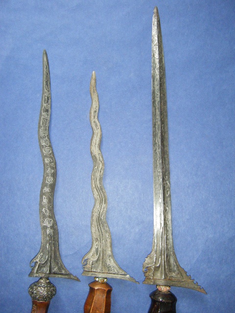

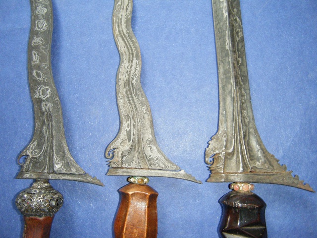

Here my shortest Bali blade, 331 mm long (without pesi), in comparison with a Central Java blade (370 mm) and a normal sized Bali blade (460 mm).
Have some thoughts about blade size but need to think about.

Hello Sajen,
Besides the twin lambe gajah (also found in Java), which indicators make you believe that this blade is Balinese?
Old 9th April 2016, 10:15 PM   #18
Originally Posted by Jean
Hello Sajen,
Hello Jean,
everthing by this blade let me think that it is a Balinese blade, starting by all features, the pamor, the feel and also the pamorless gonjo. At last I found it once on Bali, offered with many other Bali/Lombok keris. The wrangka is original and as well Balines, the gandar is a replacement but again Balinese. But can be wrong like always.
