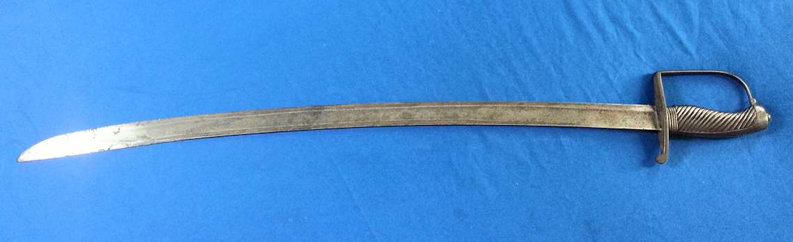

I took this picture of the below sword at the GM on the recent visit, which was potentially carried by Officers of the 8th Assam Rifles, later 6th GR C.1830, is it based on the French sabres of the same period? or another European's countries sabre?
Thanks in advance Simon

looks like a hussar sabre.
Old 11th February 2016, 08:25 PM   #3
ulfberth
Join Date: Jul 2014
Posts: 447
Hi Sirupate,
That model is the French Napoleonic light cavalry troopers sabre .
The French production years were from 1802 until 1819.
They called the variations in the model year 9 of which they produced 26326 Year 11 and year 13 production numbers were 157830
The Russians had them to most of these are around the 1830'ies.
Kind regards Ulfberth

Hi Ulfberth,
Many thanks, I thought it might be a French design, do you think it is possible that the British Officers in the Gurkhas adopted it for use in India?
sirupate is offline   Reply With Quote

Its Always possible that these were taken after Waterloo and used in the colonies, But I don't know on any official record of that.

Ulfberth is of course spot on with the identification on this most well known French cavalry sabre form, and the later adoption by the Russians.
It is indeed most curious to see a French influence rather than the expected British in regions of Assam.
I am wondering, even if tenuously, if the French presence in Indo-China (now Viet Nam) might have in some way contributed to this interesting sabre of Gurkha units. While the British presence in SE Asia was of course well established, Indo-China was distinctly French, thus predominantly influenced Vietnamese swords of military forms and in degree other.
It seems many SE Asian anomalies extended westward to the Indian subcontinent, and I have even seen katanas from these areas and of course Japanese infuences filter into incidental presence in India. Some years ago I recall trying to discover what in the world a katana was doing in a grouping classified from India
The French also had a colony near Assam, Chandernagore (today Chandannagar)
in West Bengal.

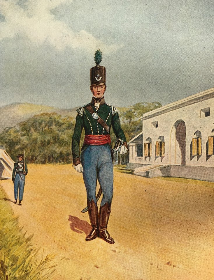

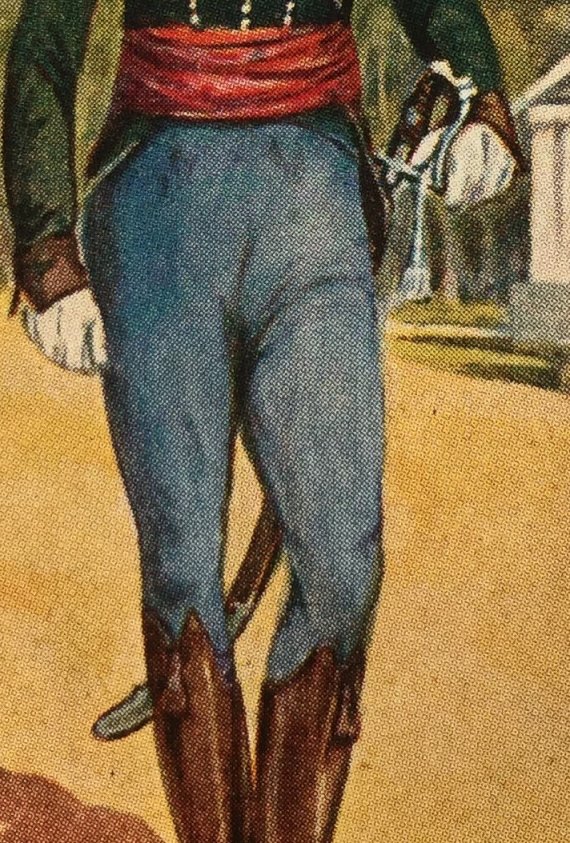

In this picture it appears that the Officer of the Sirmoor Rifles (later 2nd GR) in 1827 is wearing a flankers sword of the 1796 LCS variation
Sirupate
The hilt looks a little more like a 1788 model. I have an interest as I am trying to place a 1788 style sword that is too light to be a cavalry model and also lacks the distinctive cross style langets of the cavalry sword.

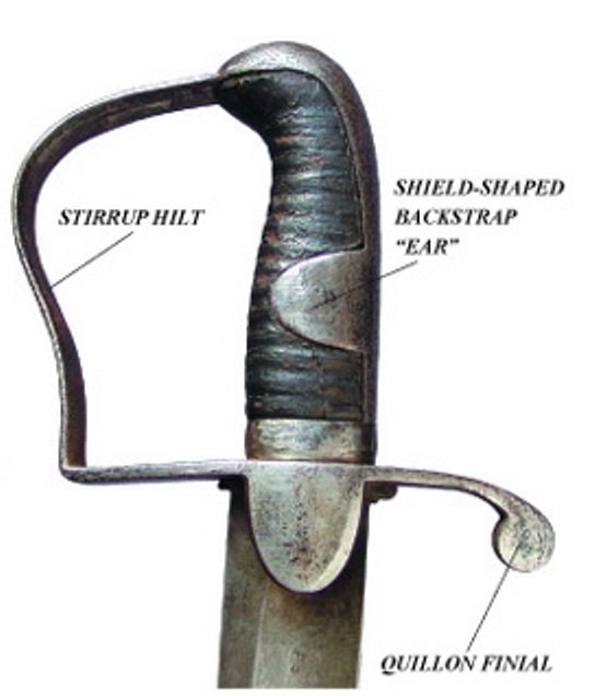

Hi Robert, the handle of the sword being worn by the Sirmoor Officer looks more like this one to me;
