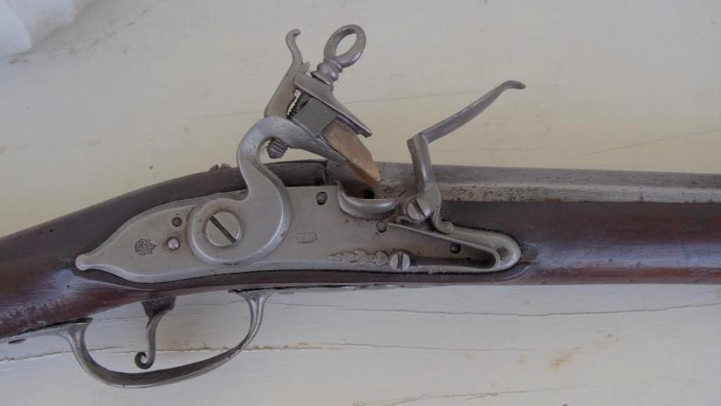

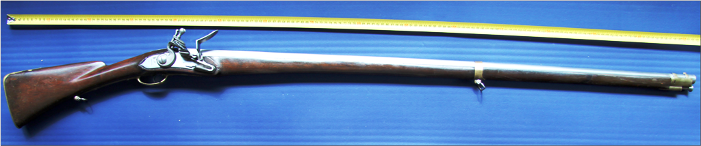

Default Mid 18 th century Spanish military musket for ID.
I have just bought this one few days ago and I still don’t have receive it.I would like to know which model it could be and of course I would like to have more information about this mark on the flintlock ‘ GARATE or CARATE I did no find it in "Der Neue Stockel" yet .
Any comment on it will be welcome
Best
CERJAK

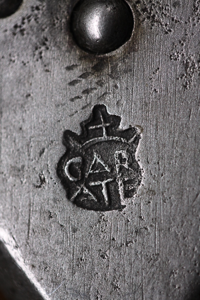

Cerjak
GARATE surname is during 17,18 and 19th centuries.
Efforts should be francisco de Garate, spark (lock-maker) 1722-1740 or Juan Antonio de Garate, spark (lock-maker) 1740 or Juan Martin de Garate, spark (lock-maker) 1745.
Also Juan Bautista de Garate, canonist (barrel-maker) 1806, but the model rifle (musket) is not the same.
-Source Ramiro Larrañaga, "Synthesis of the Basque historic armory", page 214
Affectionately. Fernando K

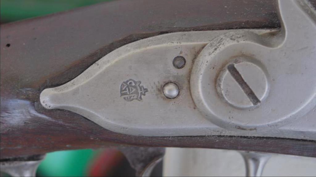

Cerjak

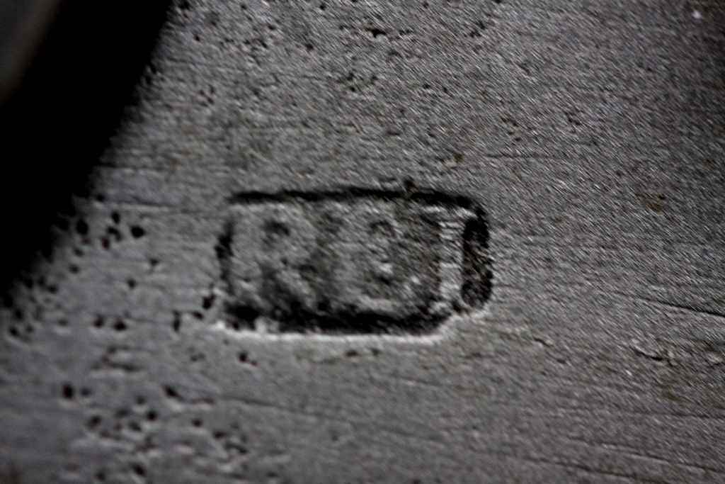

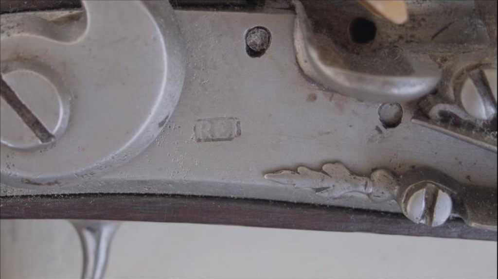

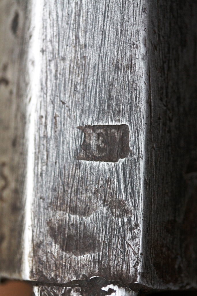

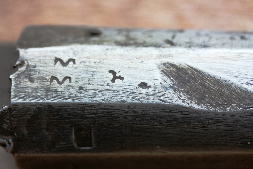

Below the bread, says REI punch? (REY)
Fernando K
Old 10th October 2015, 11:28 AM   #4
Originally Posted by Fernando K
Cerjak
Below the pan, says REI punch? (REY)
Fernando K
Which would mean property of the King.

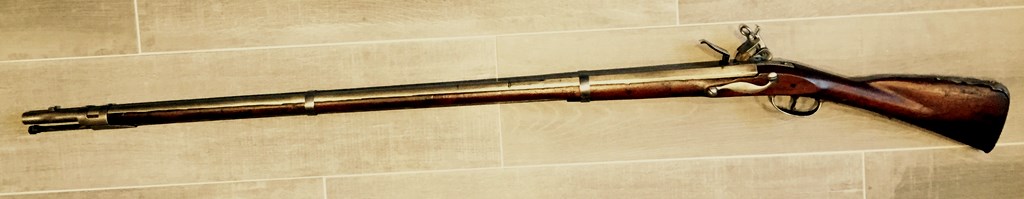

Dear Fernando,
Thank you very much for your inputs about Garate’s punch .

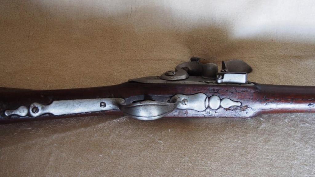

I have took some additional pictures this morning ( I have just received the parcel)
There is a similar Mark behind the barrel ( REX or REY or REI)
So it seems to be a Spanish service rifle with Spanish official punches But which model is it ?
I forgot to mentioned:
Do you have pictures for a similar model ?
Overall 160 cm and caliber around 18 mm
Best
Cerjak
Old 10th October 2015, 01:36 PM   #6
Fernando K
Join Date: Apr 2010
Posts: 672
Cerjak
For me, this is a copy of the French model of 1717 or 1728, for infantry. The rings for the gun holder (musquet) are on the left side, and rear ring was to be placed in the hole is the left side. Regarding the front ring I can not comment because I do not see from the left side of the weapon, which could be located.

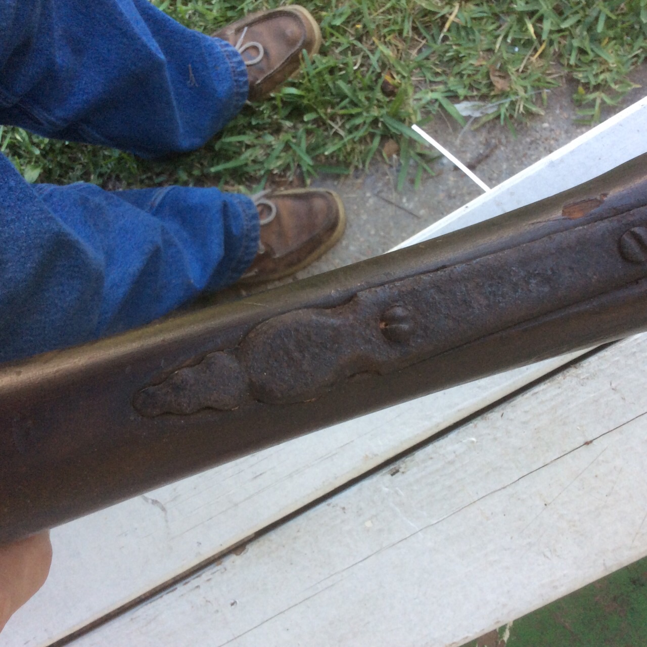

I believe it is 1750's. Form what I have found most Spanish military muskets in the 18th century carried Miquelet locks and had rings as the heads of their lock screws. This one has the ring.
The side plate is very French, as are the trigger guard and butt plate finial. Both are characteristics of late 17 th pre pattern military muskets from France.

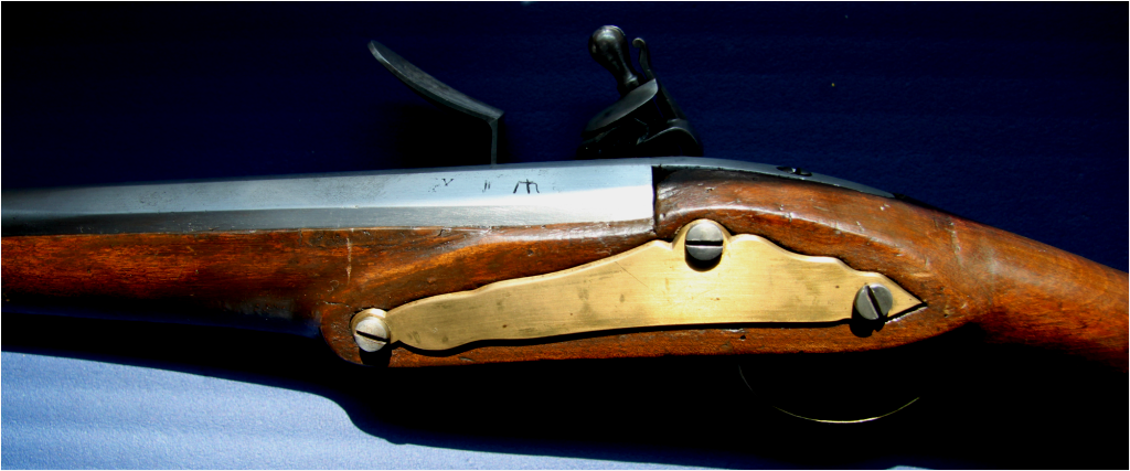

The poor photos below are of a hybrid musket that was cobbled together from Spanish 1754 military muskets and some early Maastricht import musket parts by Godfroi Corbeau (sp) of that city.
From what I've read after this French style musket was issued, the troops using it were not too happy with it as they were more familiar with the Miquelet action.
I believe after this model was phased out Spain went back to the earlier, more familiar system.

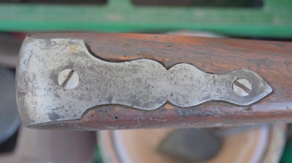

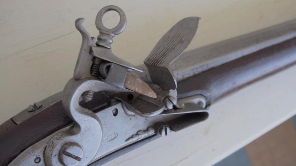

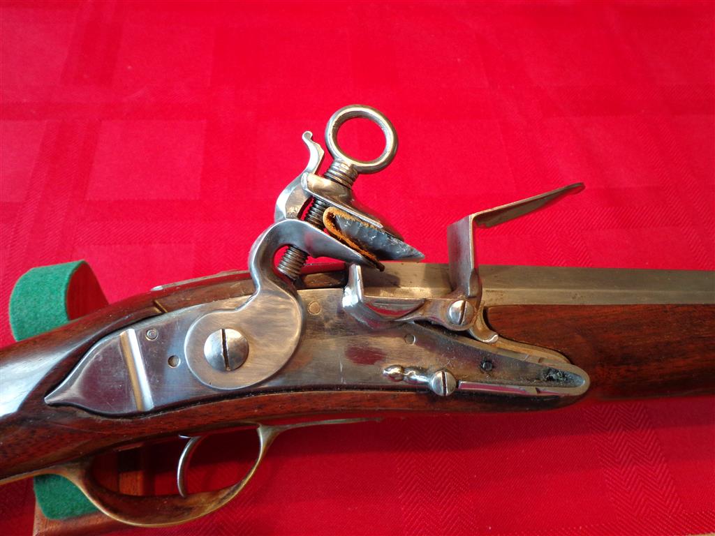

While waiting for Cerjak's reply on the barrel length, I thought I would add some additional observations.
LOCK: This is a variation of the 1752, 55, or 57 Spanish Infantry musket lock. The Spanish used the Miquelet style lock till about 1750, changing to the French style lock. Then changing back to the Miquelet style lock about 1790, believing the Miquelet style lock being stronger and more reliable.
STOCK: The stock appears to be the French 1717 or 1728/46 pattern. Although the trigger and guard appear to be from a 1717 pattern. The butt plate...I'm not sure (?). The side plate is French from this pattern, and missing it's side mounted sling swivel.
FRONT BARREL BAND: While similar to the French band, this appears to be from a Spanish 1752 or 1755 Model, with the longer tail. The bands on the Spanish guns were changed to brass in 1757.
REAR AND MIDDLE BARREL BANDS: I believe these are both French, as the Spanish rear barrel band is different.
It will be interesting to know the barrel length of this gun. Also, if the gun was purchased in from the States (USA) ?
Rick.

Hi rick
Thank you for your imput.
The barrel lenght is 120 cm so more than the french mod1717.
This gun had been bought from France from a old collector who had bought it 1960.
I hope it will help for the identification
Best
Cerjak

So, the barrel length is close to the French model, but with Spanish markings. Very interesting. Hmmmm.
So it appears you have a French 1717-1728 Model musket, with a Spanish 1752-1757 style lock, but with Spanish markings on the barrel. And it appears to have been made this way from a compilation of surplus parts, with Spanish surcharge markings on the barrel. Very neat and very interesting!!
The French barrels during this period were typically .69 or .72 caliber, where the Spanish barrels were .71 caliber. So both very close in bore size.
Rick.

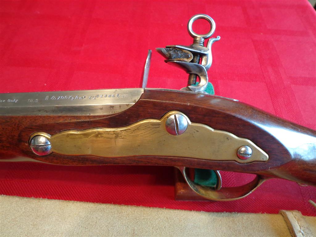

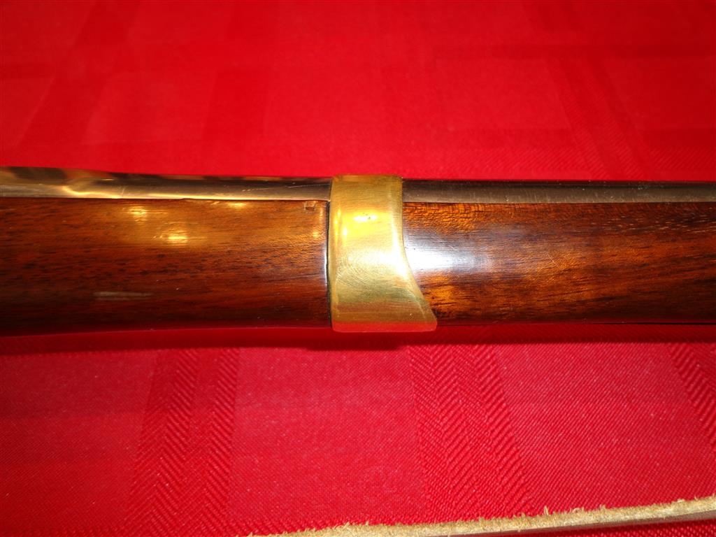

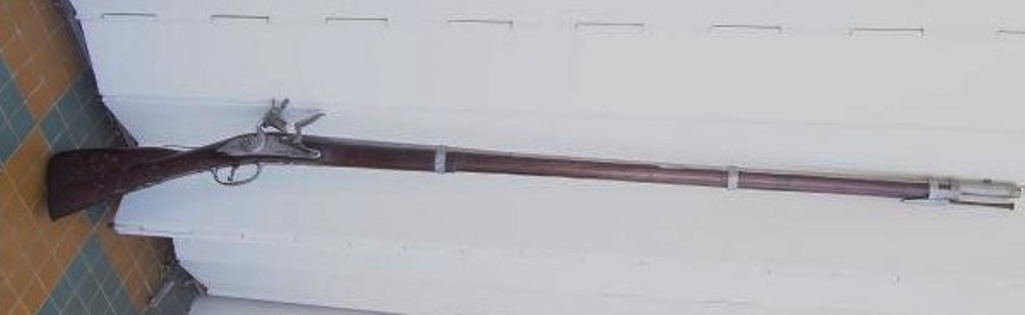

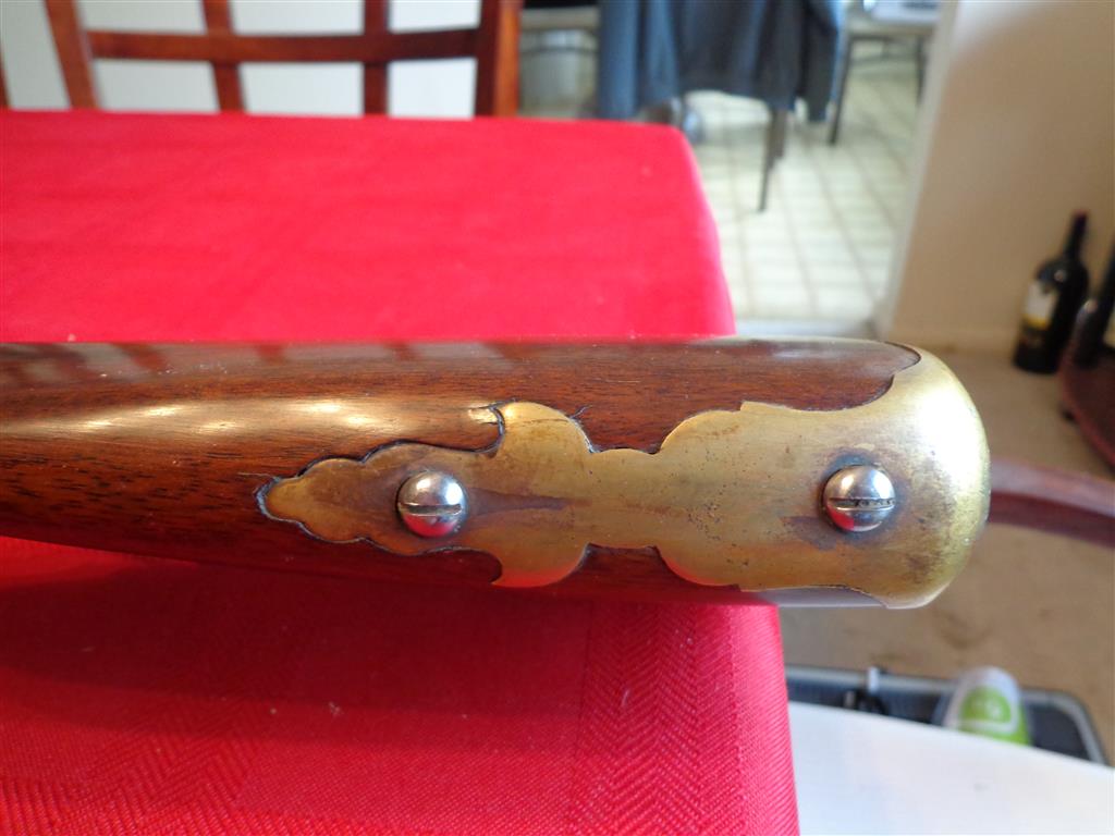

I hope the Moderator will allow the posting of a replica in this case, just to show a comparison.

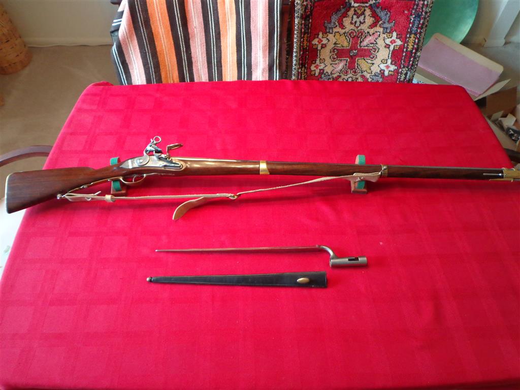

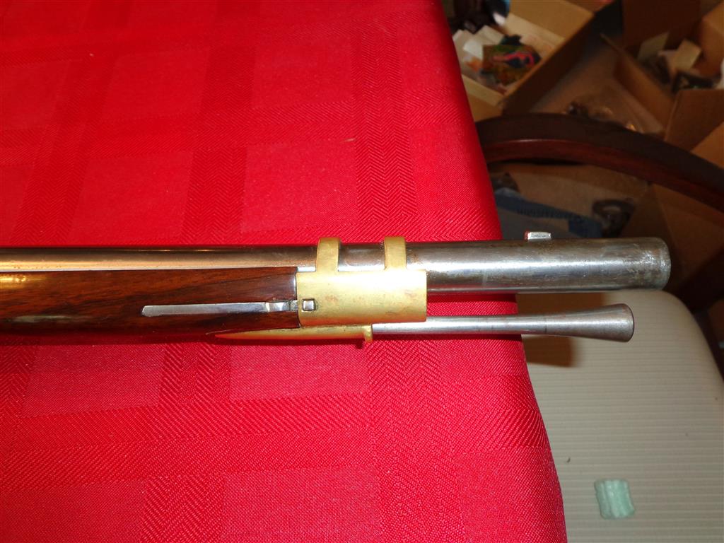

Here is an exact replica of a Spanish 1757 infantry musket. The mounts were changed to brass in 1757. The 1752 and 1755 had the same mounts, but iron. The 1752 was supplied with a wood ramrod, while an iron ramrod was adopted in 1755. Otherwise, the guns looked the same.
Notice the Spanish musket looks very different. Including the screws on the butt plate resting above the plate instead of flush in typical Spanish fashion.
Rick.

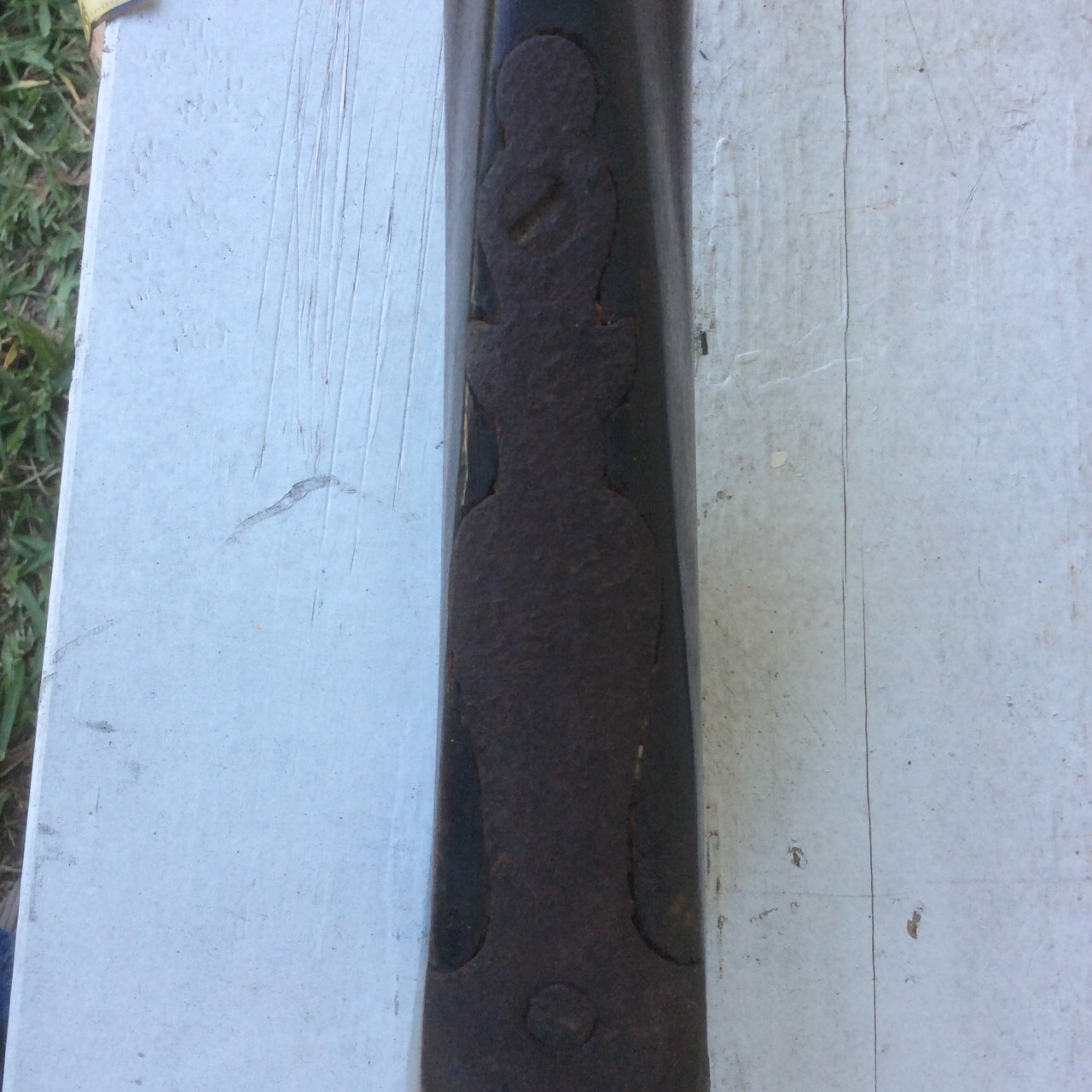

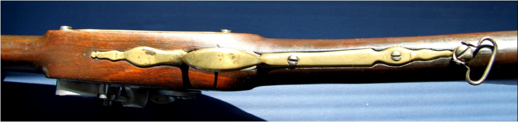

And the side plate...........

Concerning the word REI on the barrel of the musket in discussion, this reassures it was Spanish King property.

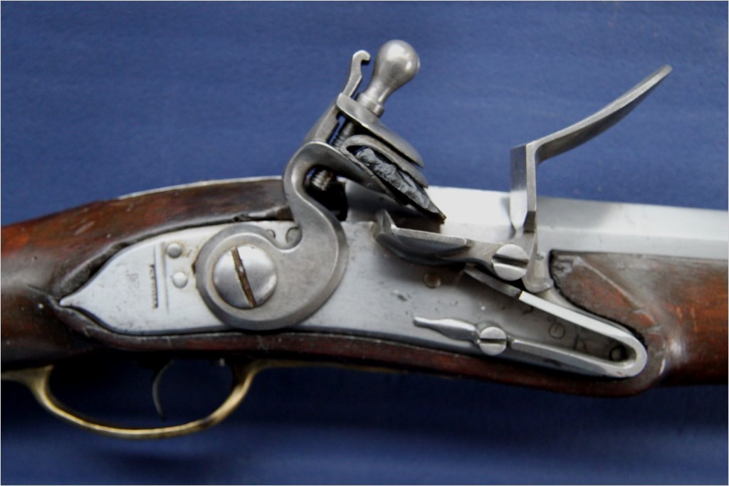

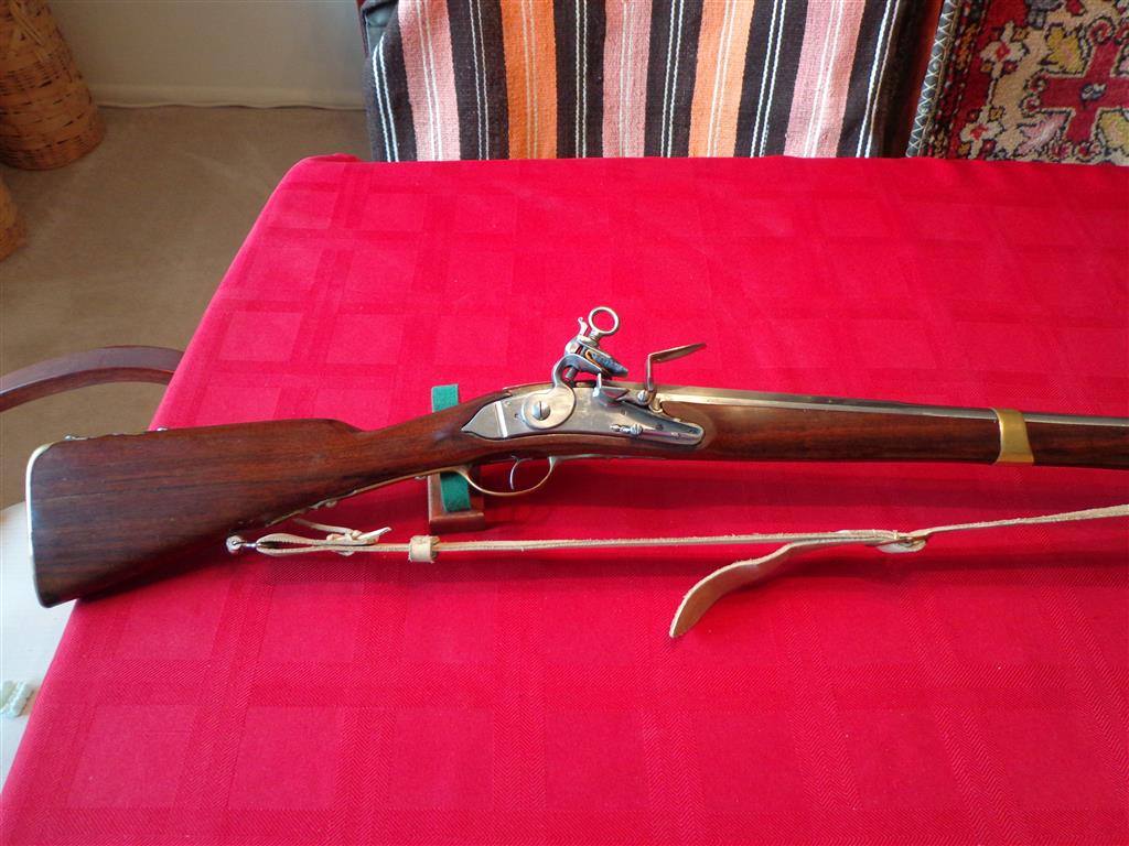

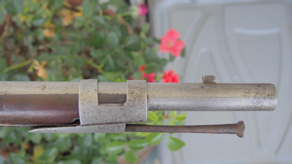

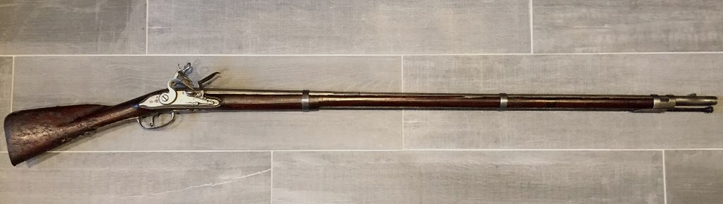

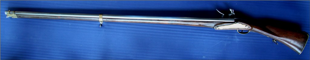

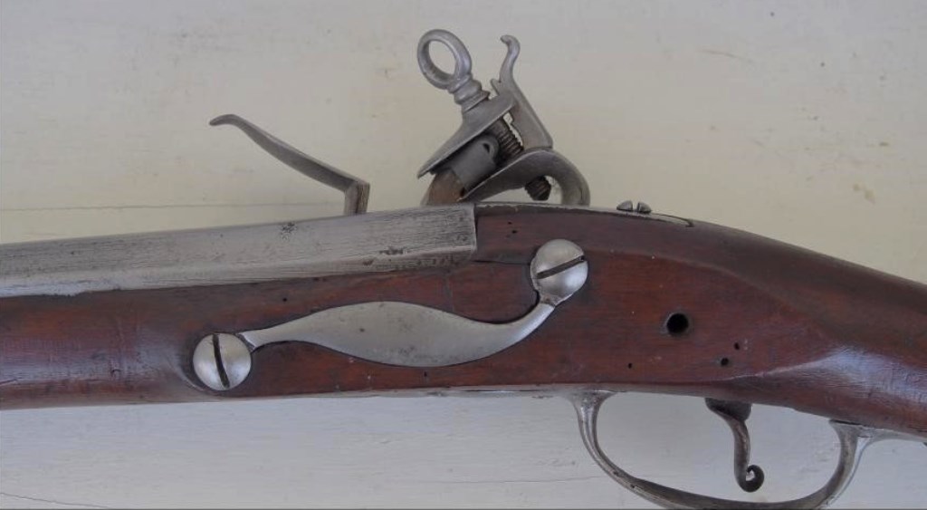

Thank you very much to everybody Rick,Fernando K ,Fernando, I have now all the information needed and even more than expected about this riffle.
here some pictures for one with French style lock that I ‘ve already posted 3 years ago.
Overall 152 cm Barrel 110 cm
Cerjak

Also, service weapon is owned by the Spanish crown, owned by the punch, REI. You can not be a French weapon.
Cerjak
Hi Cerjak.
WOW! Another super interesting musket. Yes, appears to be a 1757 Spanish musket - but with a French lock. Sort of the reverse of the first one posted. LOL Looks like the muzzle of the barrel had been shortened back in the period. Possibly due to muzzle damage or for civilian use. The lock plates on both the French and Spanish guns were almost interchangeable.
Two very neat muskets Cerjak. Thanks so much for posting.
Rick.

Supposedly, the internal and external bribles were added to the French lock in 1722. The 1752 Spanish musket was the compilation of the best features of both the French and Spanish guns. And as you note the "ring" on the top screw is a carry over of the earlier miquelet locks.
An interesting side note: From my own personal experience, I can say that the round ring on the top screw does in fact make aligning and adjusting the flint in the jaws easier and faster. Which is the likely reason the Spanish retained this feature.
Rick.
