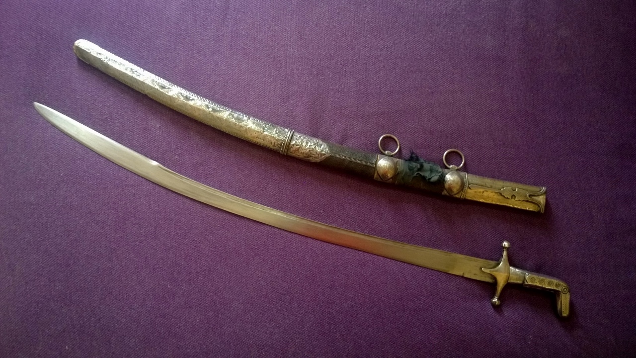

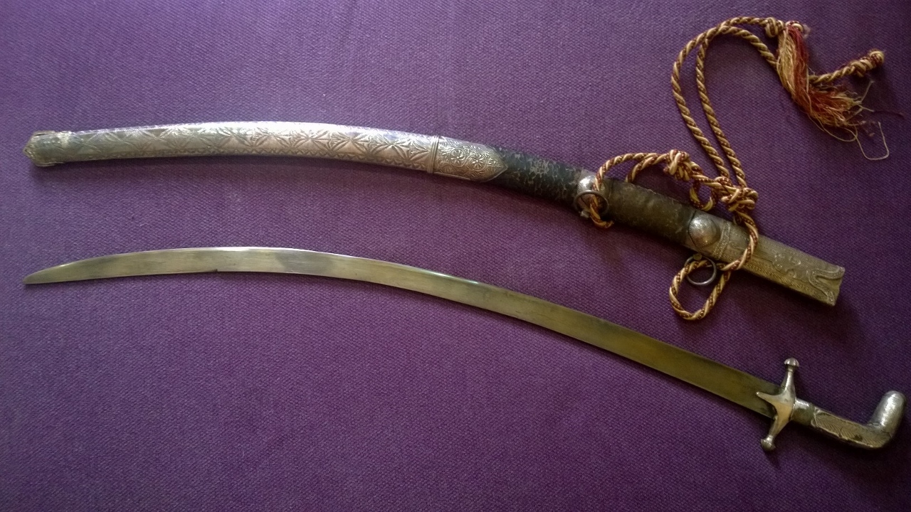

Here are two. Although I have seen others in Saudi museums (King Faisal swords) and others owned by collectors in KSA.
Both blades are wootz.

Thanks
They are not Pala.
They are Indian blades with Arabian hilts.
Kubur

Yep I posted these as examples of saifs with Yelmans and not palas, as its obvious that am looking for such examples with pala blades.
