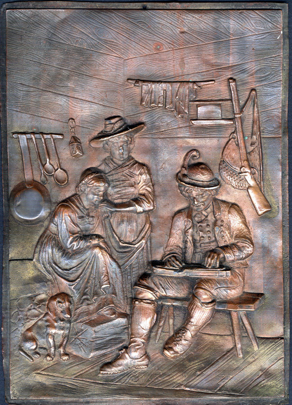

Antique Bronze Relief Sculpture
This decorative bronze plaque depicts a man seated on stool and playing what appears to be a zither. Nearby two women and a dachshund are listening attentively. The scene is set in a kitchen and one of the women is perched on the hearth with her feet resting on a log. A pot and spoons hang on the left wall near a lamp. On the opposite wall towels hang from a rod next to a flintlock rifle and hunting bag which are hanging from a nail. The roof, upper portion of walls, and well worn floor appear to be made of knotted wood. The lower portions on the walls appear to be cover with plaster.
The plaque measures 8 5/16 x 6 1/8 x 1/4, and weighs 8 oz.
I would speculate that the plaque is German, and that it dates from the mid 19th century.
Have you seen a antique bronze relief sculpture / plaque like this one? Can you tell me more about it? What do you think the item depicted between the towels and flintlock is?

As a professional metals restorer at work for over thirty years, I've seen a number of these reliefs.
Most of them are BRONZE FINISH, not solid bronze.
Basically a casting is lightly finished and then plated in the manner that baby shoes used to be done. A relatively thick layer of copper is electroplated on to the zinc base. It is then scratched brushed, oxidized, and scratch brushed again to relieve the finish.
They are common.

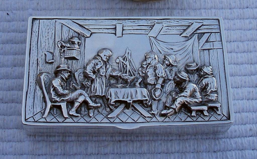

Posts: 6,436
Also a popular form of decoration on snuff boxes .
They are common.

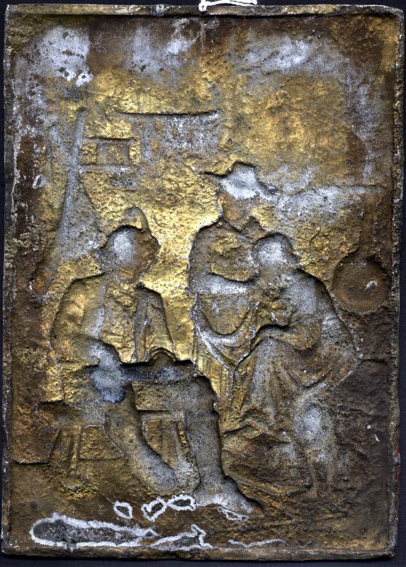

Here is a look at the back of the plaque. A close look at scratched and (oxidized?) areas leads me to believe that Shakethetrees is right and the plaque is plated. Maybe you can tell if it is "electroplated on to the zinc base" from the photo Shakethetrees.

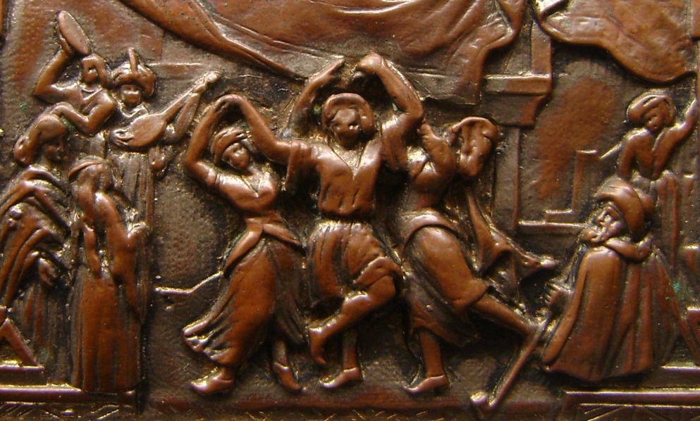

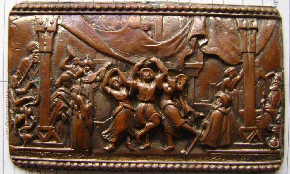

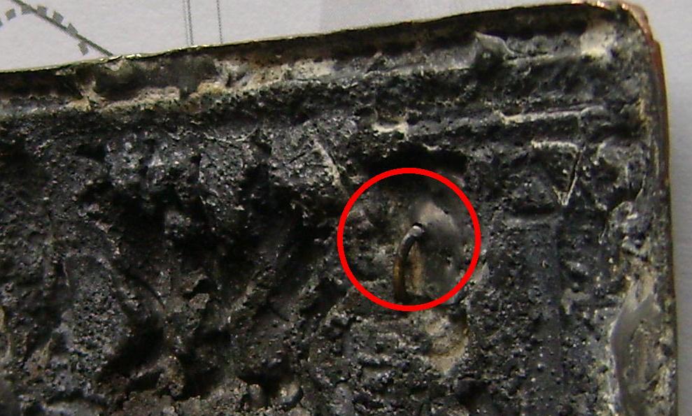

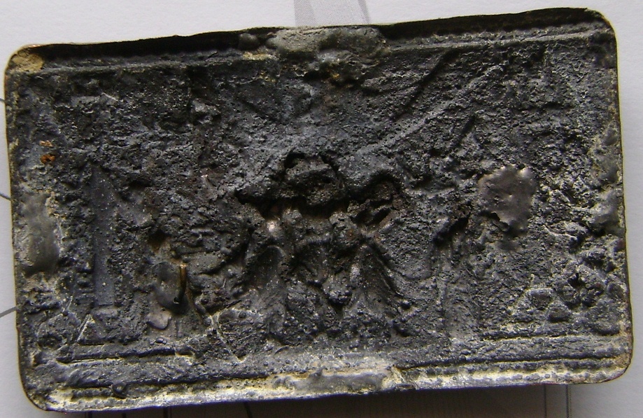

I never knew what mine is. It has the dimensions of a belt buckle (9X5 cms), but not necessarily that.
Made of copper. The back has some signs of having been hooked to something, i wonder what.
The characters depicted are obviously non European ... and neither is the scene.

Posts: 6,436
Or European done in the Oriental style which was quite popular .
Yes, that is exactly what the reverse of the ones that I've seen look like.
It would have to be electroplated.
Simple plating by the electroless immersion process produces a coating that is called a "strike". It is so thin that it is used only as a prep for the electroplating process. The electroless strike is immeasurably thin, maybe 1/250,000 of an inch thick or less.
Before the mid 19th century, decorative objects were rarely made of zinc alloy as it just isn't attractive in its natural state.
When electroplating was refined into a commercially viable process in the 1840's, it was a gamechanger. Zinc objects are best manufactured by casting as it takes exquisite detail with much less care and trouble than other more durable metals. The marriage of electroplating and the ability to easily make detailed duplicates brought fancy goods within reach of the masses.
Silver, copper, bronze and gold plated wares were produced by the boatload, for sale inexpensively compared to hand wrought, one off pieces. The busy style of the Renaissance as interpreted by Germans and Dutch both lent itself to the new mass production AND appealed to the early Victorian romanticism of the day.
Your plaque falls squarely into this period.
Fernando, I believe your plaque is either a box lid mount or a mount for some other unknown type of utilitarian object.
Stylistically the "Orientalism" (meaning anything from the Eastern Mediterranean to the Pacific Ocean) was popular from the third quarter of the 19th century until the 1920's.
The manufacture appears to be done by a process that in the day was called "galvanoplasty", today known as electroforming.
In it a mold is prepared to a finished state and painted with an electrically conductive coating (such as graphite or very finely divided copper or silver powder) in a binder. Electrical current (DC) is run through the surface while it is immersed in a copper rich solution. As the copper is deposited, certain areas are masked off by varnish to slow the deposition, as the current is not running through the whole piece equally. This is how an even thickness is maintained. Periodically it is removed from the solution and scratch brushed. This consolidates the surface and contributes to the structural integrity of the finished piece. Every so often the polarity is reversed, rendering the anode into the cathode and vice versa as this also contributes to the adhesion as the metal is built up.
The reason I believe this is an electroformed piece is that there are always minuscule beads remaining in the details that are a hallmark of this technique. If there none of these beads, then it was struck from steel dies from thin sheet.
Either way, once it is trimmed to shape it was filled with 50/50 solder to preserve its shape and give it some durability.
Both techniques were available at the above mentioned period, but I believe the likelihood is that it was electroformed.
A lot of "museum copies" of high style Renaissance armor were made by electroforming in the 19th century. If a great piece of armor becomes available for a too good to be true price and it is copper, this is what it is - a 19th century museum copy, nothing more.
I think this plaque dates from the earlier end of this period.
