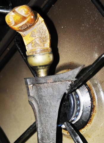

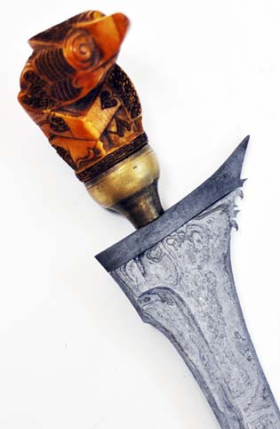

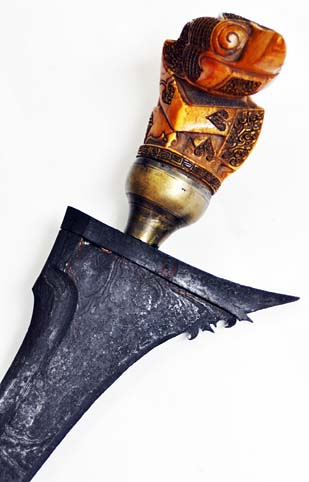

I have a problem with this Palembang keris and hilt. All I want to do is to clean the black-rusty blade with "kelapa" (coconut) husk. But unfortunately, the hilt is fixed firmly to the pesi. Too firm, and not possible for you to open or even to turn the hilt with your bare hand...
What would you suggest me to do: (1) Must I open the hilt first (2) but how to open such firm fixation? Or (3) just submerge all -- blade and hilt -- to the "blandongan" full with coconut husk? (4) Or clean the blade, without unfix the hilt? How?
Thanks in advance for your advice,
GANJAWULUNG

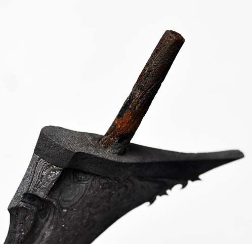

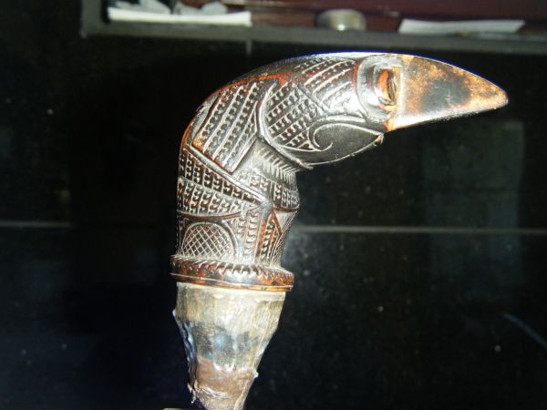

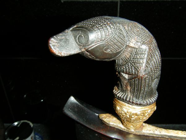

Thanks Detlef, Moshah and Kai,

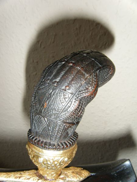

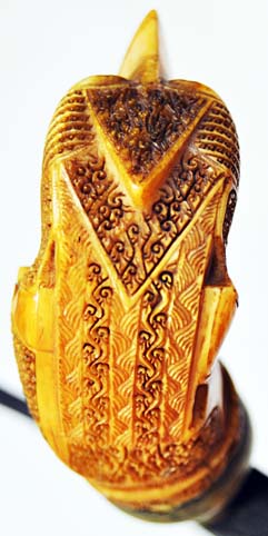

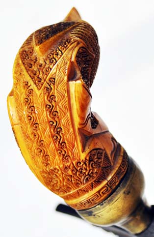

For this time being, I still keep it like it is. With the hilt firmly fixed. IMHO, it is not ivory but "duyung" or dugong hilt. You may look at the different brownish and yellowish colour of it. Images below, are different views of this hilt. The size, it seems bigger than usual...
I will try the last step to open the hilt. Then, what would you suggest the way to clean the blade without unfixing the hilt, please?
GANJAWULUNG
Old 15th May 2010, 11:27 PM   #6
Posts: 7,228
Pak Ganja, removal of a firmly fixed hilt is not usually a problem.
If you use a candle or small kerosene lamp for the heat source, there is no possibility of doing damage to the hilt, provided you are reasonably careful.
I suggest that you should work with bare hands, so that you can feel how hot the blade and hilt become during the process, this will safeguard against over heating.
I can understand your caution with attempts to remove the hilt on this keris. I have had two Palembang tangs break while attempting to remove a rusted on hilt. I suspect that perhaps the adhesive that they used to use in that area may have had a corrosive effect.
If this were my keris I would try the heat first, but I would not exert excessive force in trying to twist it off.
If you are bound and determined not to remove the hilt, the blade can be cleaned by repeated brushing with a mild acid, and rinse with water. Freshly squeezed lime juice will do it.
It would probably be a good idea to coat the selut with nail polish, and to wrap the hilt with plastic cling wrap before you start. The nail polish will come off easily with acetone, when you finish the job.

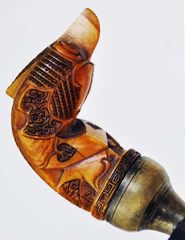

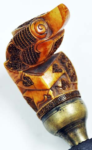

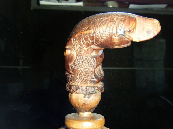

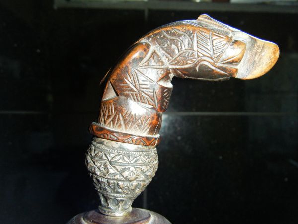

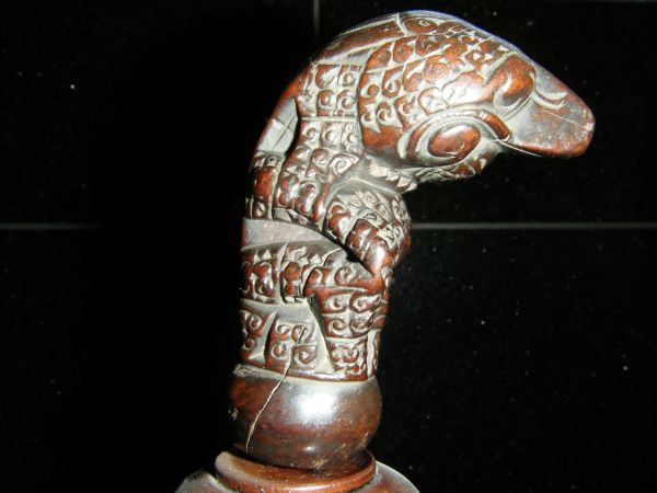

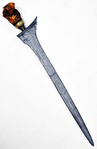

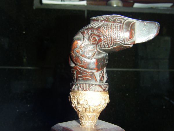

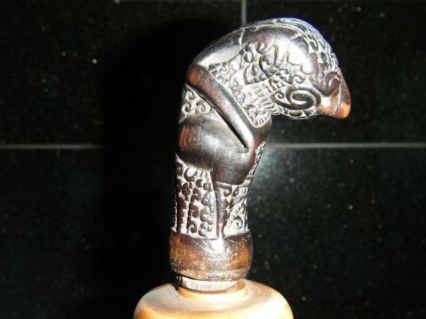

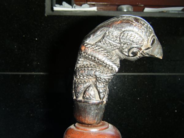

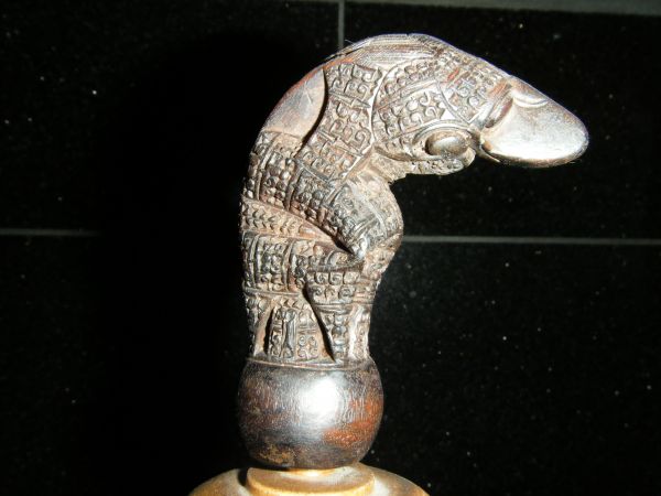

Default More display

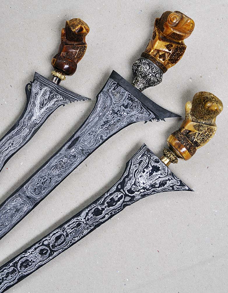

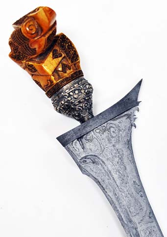

More on Palembang hulu and keris...
Old 6th October 2011, 08:50 PM   #12
Hello Ganjawulung,
very nice handles and blades! Are the pendokos on the left and right old or new ones?
