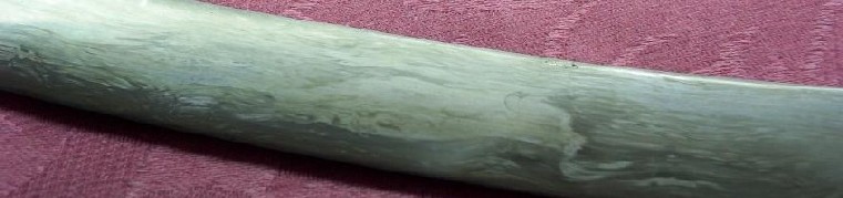

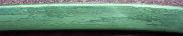

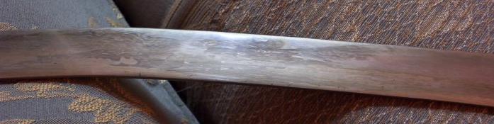

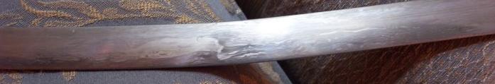

As we know, Dr. Verhoeven does not consider sham to be true wootz, however many collectors do. And as it's relatively easy to recognize network and ladder types, it is difficult to make a clear distinction between stripy, water and wavy patterns, as all three can be labeled as sham (just look at the multitude of individual opinions from this post:
http://www.vikingsword.com/vb/showthread.php?t=38
So here are two blades. Both have longish threads, more evident on Sword_One, with one particular thread looking like a half-circular brush stroke (see second picture). I even thought it was painted when I saw it first time. The second sword has similar, but less wilder threads. Both can be seen as sham, but considering relative high contrast could one see them as wavy/water type? And how do you make an informative "guess" which is which?
P.S. Glad to be joining so many dedicated and knowledgeable people at The Forum. This is my first post. Looking forward to learn and to share. Alex

Nice blades. A definitive way of characterizing/naming patterns still needs work as it is so objective and different parts of a blade often shows different patterns..some tight and some more wavy. As for Sham...check out my reply on the other link.

the sham pattern can be produced with both hyper and hypo eutectic steel.... ofcourse.... my idea of a sham pattern is where the waterings are very straight... the pattern is controled by how the igot is drawn out.... if you want a very straight pattern... simply use hammers with very flat faces..... it takes longer to make ...
now for real interesting waterings.... you forge the blade out with round face hammers.....and do lot's of fullering to draw the ingot out.... ... now the drastic deformation of the surface helps the waterings to become much more chaotic..
its really more about pattern control and forge techniques.....
however....i'm not sure about the swoopy patterns.... i've gotten weird pattern when i etched blades that weren't totally degrease.... but that a different matter..

There is a very wide variety of opinions about the classification of wootz, what is wootz, how do you classify, etc. I think it can even be split into technical aspects and collector aspects. Speaking from a collector aspect, Sham wootz is most often associated, again from a collectors perspective, with Turkish or Syrian wootz or shall I say that this pattern of wootz is most often associated with those regions. I believe Sham is another word for Syrian. As Greg points out, the sham pattern is mostly recognized as long flowing lines without circular distortions, partial rungs or full rungs. I am afraid I am away and am unable to post an example to illustrate.
It is hard to tell from your example but it appears that your first example has some dead spots or inactivity in the patterning most probably due to a failure to control the heat during forging. In the sections where the pattern is visible, it seems to not exhibit the typical sham pattern. The second example also does not appear to be an example of sham.

I thought sham meant plain steel that was etched to look like it was wootz/pattern welded?
To photograph patterns in steels, it is often easiest to get a uniform reflection by taking the photo with the blade outside, positioned in such a way as to reflect an overcast sky - you get a very clear shot of the pattern if the blade is lit with uniform, diffuse light.
The parallel lines (to the right) in the middle photo indicate that blade might be pattern welded steel, but the photos are indistinct enough to make any attribution a guess.

What a wonderful welcome to the Forum. Thank you all who responded. Now I have more questions than before... and it's a good thing
Greg:
Your reflection on the wootz/sham issue is one of the brightest I have ever came across (well, after Ann's, of course ). And I can not agree with you more. It sounds so logical - it's either wootz or mechanical !!! ... (or am I way off changing the conventional wisdom on my second post??).
Rick:
Very short and sweet description of sham pattern. And I'll keep wootz pictures coming. It's the ONLY thing I collect, and amazingly know so little about Also, the pattern on my blade looks more Chunky than Stripy, and if Manfred Sache categorizes Stripy damask as Sham, should the Chunky be qualified as such, IF AT ALL? (Ann, any comments?)
MORE IMPORTANTLY: If it's not Sham, what do you think it is?
Jeff:
I did not think it's a mechanical pattern, and even with all that "chunks" and blank and empty areas I inclined toward stripy (sham) wootz, but now I am not sure. Perhaps someone will be able to identify it despite low quality photos (still can not get them right with my Kodak 3MP).
OK, now we're back where we started. The One who said: " Wootz is an amazing and magical thing" was right.
Also, Rick - do you know where can I get Manfred Sache English edition? All I could find is German one on Amazon. Thanks to all!!!

yes....currently my thinking is leaning towards being historically accurate..... after all, why should we make new standards for crucible steel when there were already some in place...
i realize that what i'm trying to put forth is against the grain but something has to be said for crucible steel.... from what i understand, wootz/poulad was crucible steel made in the middle ages tradition.
I believe this post to be important to collectors, also !!!
-can you imagine if your shamshir, tulwar, kilij, with fabulous waterings... truly wonderful crucible steel...... if it was tested for carbon level and was found to have .8%....... under the current definition it would be declared " Not Wootz/poulad "
-- the value would be much less.... but yet....it still is an excellent steel, strong enough to do well in combat.... beautiful to look at.... and has interesting waterings
-yes....it is abit troubling..... so this is why we have to ask questions when scientists come up with subcatagories and redefine materials.
-from what i've been reading and rereading... the ancient catagories of crucible steel was about the surface waterings (color, pattern, region etc)
maybe i'm over reacting.... but it is definitely worth looking into
Greg
those blades are strange.... sometimes you can have some non-patterning surface decarb... and this will etch into black blobs.... but can be ground out...
- it maybe that the etch was off...... sometimes the etch will do crazy things
- lastly...... this is a long shot...... but it maybe that these blades were roasted for a very long time dissolving some of the dendritic network.....
i've noticed in the past that long roasts will give you a larger and wandering pattern..... much the opposite of the dendritic look..
so...it maybe that....but i'm truly reaching here..... .. way out !
Gt Obach is offline   Reply With Quote

The new photos make me think it is not mechanical damascus, too - looks more like crucible steel to me. I'm thinking the blobs are probably decarburized areas as well, the patchy look (sharp transitions & shapes that are random, not streched out or tied tightly to the blade geometry) is consistant with a decarb layer that was not fully removed in the finishing process.

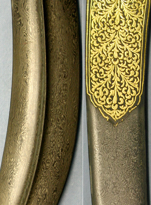

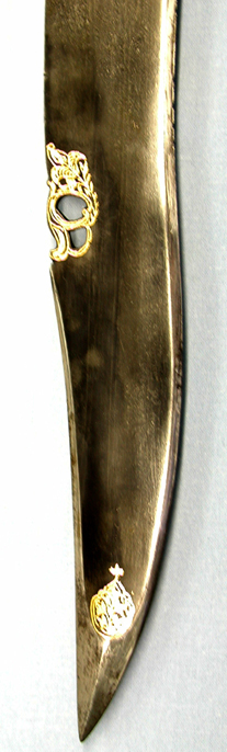

What would you call this?
Old 26th January 2006, 04:07 PM   #21
Jens Nordlunde
Jens Nordlunde's Avatar
Location: Europe

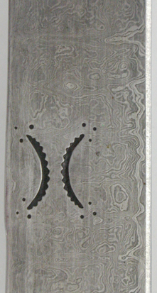

Posts: 2,718
And this?

Lovely blades you post there. I will take a crack at these speaking strictly from a collectors viewpoint. The first example has the very tight, fine, low contrast pattern most often associated with India. In the next picture, the two swords to the left exhibit the high contrast, high activity patterning that is most often associated with Persia while the final example to the right is what I would call a classical example of Indian wootz. Tight, fine pattern with low contrast.
RSWORD is online now   Reply With Quote

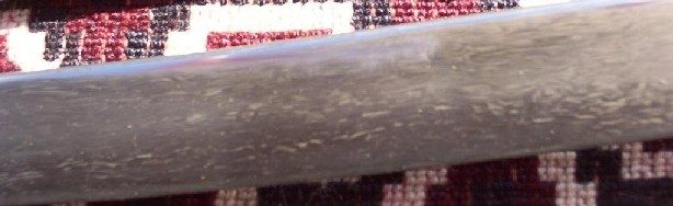

The reason why I show these three dagger blades is be course the first one has these dark blobs as well as watering, but the others don’t.
What are thise ones then? They are from tulwar blades.

The last two examples you post are examples of mechanical damascus or pattern welded steel. The example on the left, with the widely scattered pattern, is according to Figiel, from peining the blade. Perhaps he means tapping on the tang will create these distortions. The example on the right is a good example of an active watering that is the result of pattern welding.

Hi.. I have seen those exact blotches on some of my first blades ... .. i'm not quite sure why the pattern is like that.... it may need to be re-etched ... or may have been a problem with the last stages of lower temp heat cycling... (some spots may have been overheated abit.... and need some cycles to repattern )
-- in past experiments.... i kept etching till those spots start to pattern....but the problem is that the other places where the etch was initially decent ...now is overly etched and looking cruddy...

On the patttern welded blades, the left has a low number of layers, the right a high number. Unevenness in the surface from hammering (that is later filed out) results in more layers being exposed on the surface, which is what Figiel must have been referring to when he spoke of peining.
Another factor which influences the way patterns show up on these blades is the state of hardness of the metal - A blade or area that has been fully transformed in the hardening process will etch more slowly than an area that was not hot enough or cooled too slowly to harden properly.
