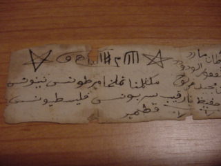

Default Islamic Text Found in a swordhandle

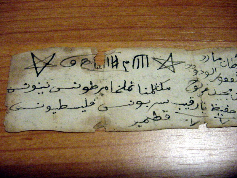

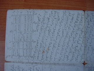

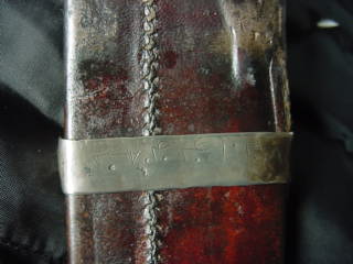

Can anyone tell me if a name from the owner is on the paper
Old 6th March 2006, 01:12 PM   #2
Dajak

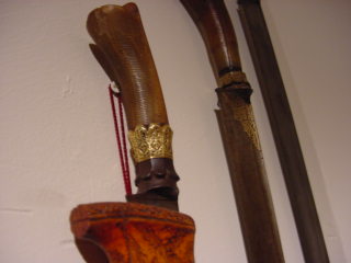

Dajak's Avatar
Posts: 952
on the scabbard

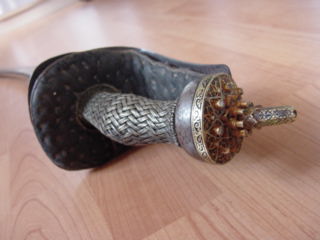

Hi it is a peduang from sumatra that has enter the Netherlands in 1850
the papers was hidden in a bag made from cloth that was
put inside the handprotector
the story about this sword is that it was used bij a high placed men that was very close to the sultan off Atjeh between 1650 and 1700
Old 6th March 2006, 11:50 PM   #6
Posts: 4,734
Dajak:

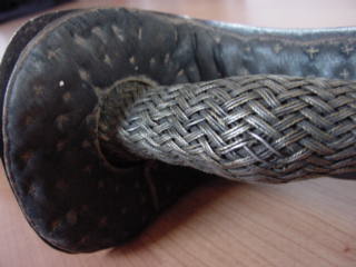

I can't help you with the Arabic translation, but I'm looking at that scabbard and it appears to be a late 19th C or early 20th C piece, perhaps modeled on the Dutch military klewang scabbard of that period. Certainly not original to the sword, if the sword is 17-18th C. in origin.
I'm also skeptical about the paper and writing being as old as the sword is purported to be. Given the way it was stored, its appearance is remarkably pristine and well preserved. An analysis of the paper and ink could reveal a recent origin.

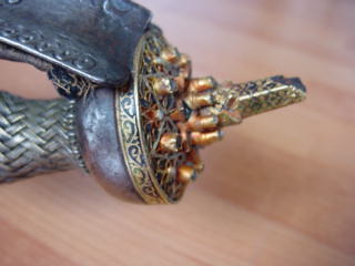

Nonetheless, a very nice hilt. Any chance we could see the blade?
Ian.

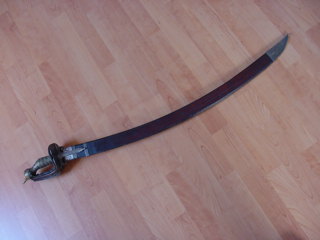

Hi this is an copy from the original
the original is very thin
The scabbard was on it when it entered the Netherlands in 1850

Default Talismanic Papers

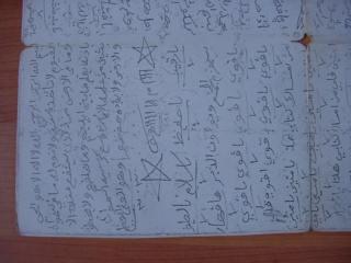

The text is a bit small but from what I can see, I'm assuming the papers are actually what is known in the Malay archipelago cultures as Tangkal, a form of talisman. Maybe if you can enlarge the scans a little bit, or perhaps just one of them we can read a bit more.

Posts: 135
Raja Muda is right about the papers being a form of talisman, also known as azimat or zimat. I see a familiar pattern or two and such azimats are common with some of the Bugis I know.

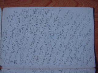

Old 7th March 2006, 06:05 AM   #10
Dajak
Dajak's Avatar
Posts: 952

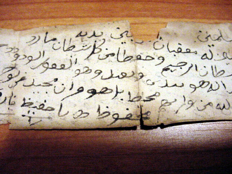

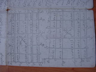

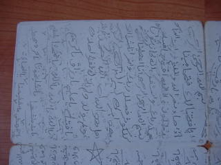

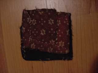

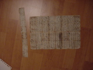

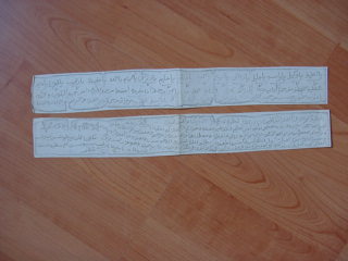

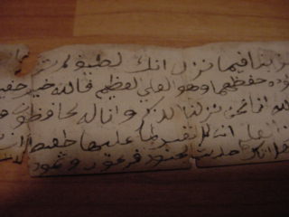

here a pics from the original papers you can see how big it was in the little cloth bag
Old 7th March 2006, 06:07 AM   #11
Dajak
Dajak's Avatar
Posts: 952

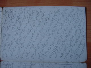

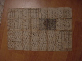

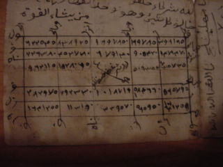

Original paper

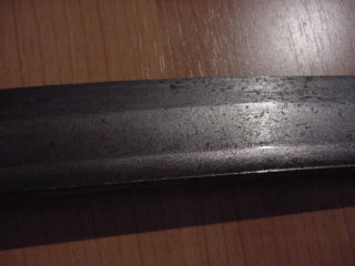

Old 7th March 2006, 06:15 AM   #12
Dajak
Dajak's Avatar
Posts: 952

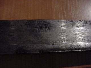

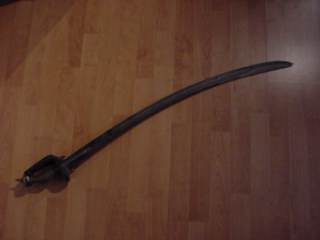

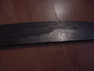

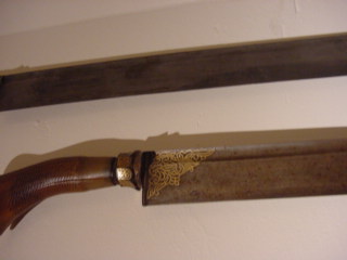

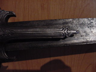

Hi here are pics off the blade

nice sword! was this a recent acquisition? in all accounts, it's still a nice looking sword.

Default The stars portion...

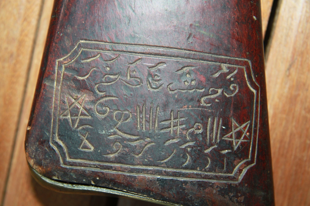

This is indeed a talisman, (tangkal or azimat/zimat or jimat). This type of talisman, once opened, the "strength" is gone. The azimat is 'void'.
The portion between the 2 stars is known as "Khatimus Sulaiman". It's purpose is to protect it's wearer against "black magic" and evil spirits (god's willing).
It is a combination of a number of azimats mainly for protection against supernatural elements.

Nice to read this Ian that makes that the scabbard is the way it has to be
and not influenze off the dutch
The scabbards for the peudeueng peusangan with a hulu meu apet are usually wood covered with leather. Some are adorned with silver banding . Scabbards for a peudeueng peusangan with a hulu tumpang beunteung and the peudeueng panjang are of wood and can be found both ornate and plain

Dajak that is a wonderful example of a peudeueng peusangan with a hulu meu apet. I have never seen a better one and only 2 as nice. I know of 2 of these for sale now ( at least they were available the other week ) but both are priced beyond a firefighters salary. One that is also a royal sword is listed as Indian and I cannnot convince the seller otherwise. Congratulations and thanks for sharing. May I use a picture of it and the talisman in the article on these swords you saw referenced.

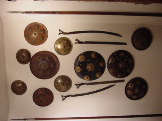

Old 7th March 2006, 06:35 PM   #20
Dajak
Dajak's Avatar
Posts: 952
Hi John no problem to use it if you need better pics or anything just ask
Is the artical from you
I know the grand daugther from genaral van Daalen she was on Sumatra visiting the museum overthere and get a map with copys from the museum overthere pic enclosed
The sword comes from an very old collection from a famous collector that is not more with us but is known over the world
here some other Atjeh weapons

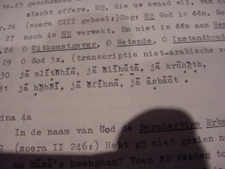

Default Contents of Azimat
Hi Dajak,

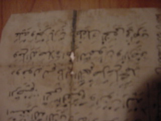

Thanks for the enlarged pictures of the tangkal azimat. I believe it contains snatches from Quranic verses. But what I find most interesting is the second piece from the top, as the inscription below the two stars are the names of the Seven Sleepers, whom I believe figures in the Quranic chapter Surah Al-Kahfi, as well as Byzantinian Christian traditions.
As the story goes, they were a group of young men who were persecuted for their early Christian? beliefs and escaped to a cave. They fell asleep and awoke a few hundred years later, though they thought they've just spent a night in the cave. One of the members went to the nearest town to purchase food and amazed the locals since the money he carried was stamped with the face of a long dead monarch, who persecuted the monotheist believers a few hundred years ago.
I'm not sure what the magical/spiritual significance the story holds for the sword. Maybe someone can make the connections.
Raja Muda is offline   Reply With Quote

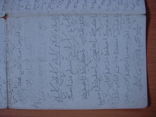

Old 9th March 2006, 11:39 AM   #25
Dajak
Dajak's Avatar
Posts: 952

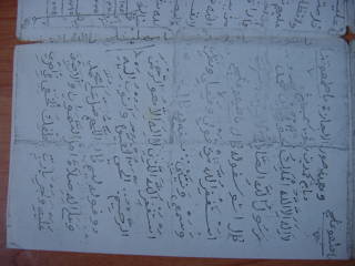

Hi Raja Muda
Thanks for this interesting information

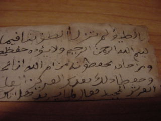

I have a Dutch Translation with it but not al is translated
and there must be 2 persons have made this Talis man

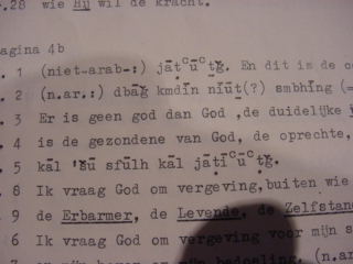

I am looking for the meaning for the not arabic writing on it
It is translated qur ang parts from J.H. Kramers De Koran Amsterdam 1956
I like to know what is between the stars
Here a some they can t trans late

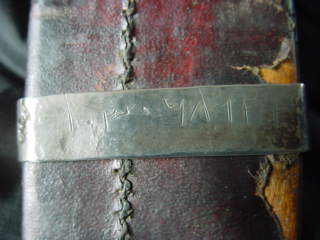

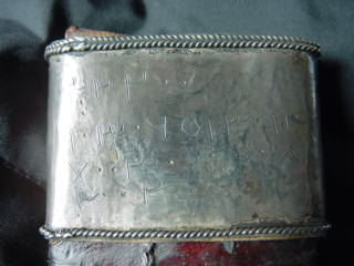

There are also 3 dates on the silver bands 1690
1739
1752

Hi Raj Muda kan you read those strange words

Hi with all the papers I did get there is some information that this sword date back to 1650
there are a few date s on the back off the silver one off them is 1690
