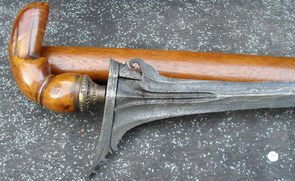

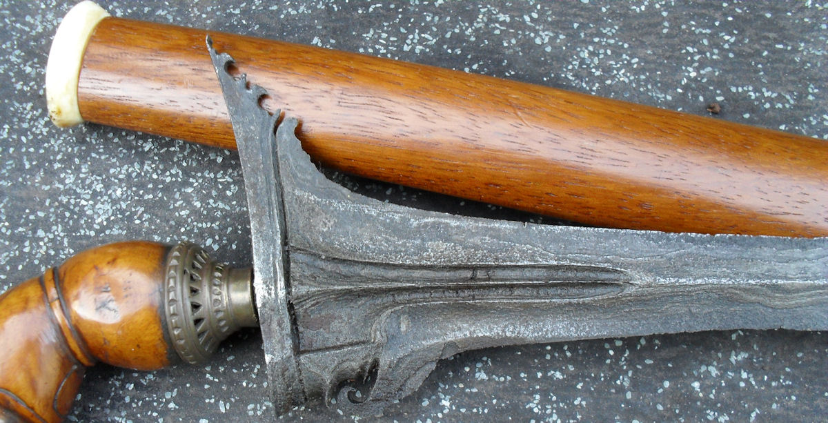

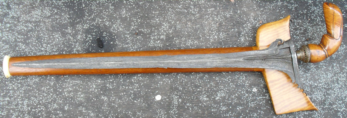

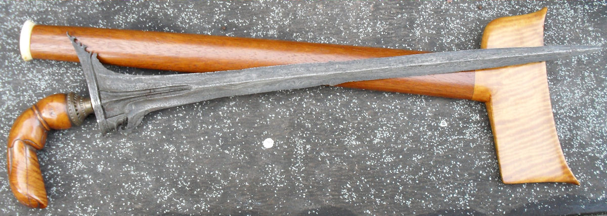

At least that's what the original collectors notes call it (in Dutch).

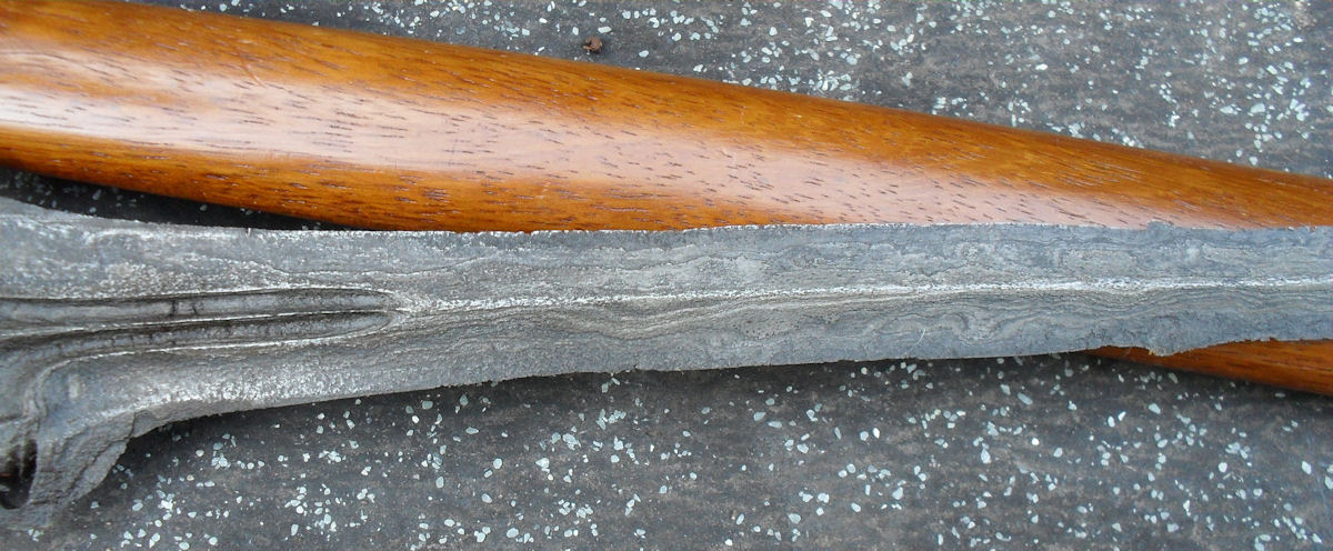

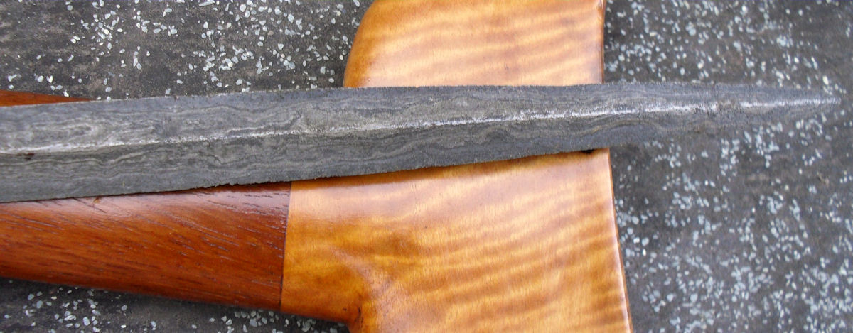

Blade looks to have been etched and restained many times.
Interesting 'lugs' like a harpoon.
Overall length in scabard 51cm. Blade a fraction under 43cm.
The largest Bugis Keris I've ever had I think.
Help and comments appreciated as always.

It looks like an older Lombok blade in a refurbished (or new) Sulawesi sheath. Buntut is most probably new.
Hilt is an old one.
The somewhat exotic term "Executioneers kris" is mostly applied to panjang type blades.

It looks like he has found the sheath in "just sanded and repolished" condition. I see nil signs of patina on sampir, contrary to hilt.

Absolutely. In hand it looks like it was made yesterday, but the hilt does seem to have some age.
I get the feeling he was sourcing this stuff for a long time so he may have had people 'restoring' or even finding it for him and doing some 'tarting-up' prior to selling to him.
It's all a good fit though. Is the blade an interesting one?

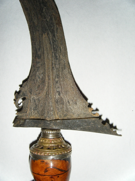

Hi Gene,
very interesting piece. Gustav is correct, the blade have a Lombok touch. Can you provide a picture how the blade fits inside the sheath? Pendokok look like a Sumbawa one. See here: http://www.vikingsword.com/vb/showthread.php?t=11474, look posts 2, 5 & 6. Never have seen a blade like this with harpoon like hooks.
Old 26th September 2012, 01:00 AM   #8
Atlantia
Atlantia's Avatar
Join Date: Jun 2008
Location: The Sharp end
Posts: 2,928

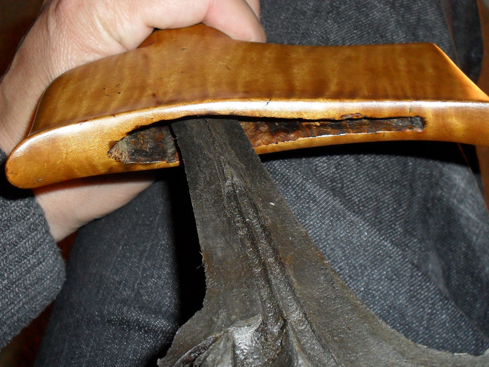

Originally Posted by Sajen
Hi Gene,
Hi Detlef
Ah yes, I see.
Here are the pictures

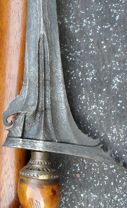

Originally Posted by satsujinken
very fascinating to see such unique keris like this
wonder how the harpoon like tip worked ...
as I logically think that harpoon like tip will be effective as stabbing weapon, but will not be so easy to pull out
or perhaps it is the actual purpose ? to create larger wound ?
I don't think that this feature necessarily had a practical purpose. Given the amount of edge deterioration i'm not even sure this feature is original to the blade...

Hi mate,
seems to be a dress made for the blade. And not a recent one like the dark inner patination shows. I would guess that the sheath was overworked or restored.
Would like to read opinions from our members from Southeast Asia.
Old 26th September 2012, 05:28 PM   #12
Posts: 6,436
The blade is quite ragged looking; I think any edge features that may seem unusual are a result of corrosion through etching and age .
It is not uncommon to see a blade from one island in the dress of another .
The fit of the blade in the scabbard is not quite what I'd like to see .
Maybe an older wrongko with a newer gandar and buntut for a scabbard .
I thought that originally, but the shape although ragged through etching seems uniform and deliberate.
Only two barbs and they are symetrical.

Gene, i was implying that the "barbs" might have been added at a later date, and therefore, yes. deliberate...they could be original though, really hard to tell. I wouldn't exactly refer to them as "barbs" however. More like "bumps", but it is possible they were pointier once. Again, hard to tell.
As for origin, i would say this is most certainly not a Bugis keris and i agree with others who place it in Lombak or Bali. The sheath may have been made for the blade or it may have been re-fitted from an old sheath. As Rick has pointed out, it is not that unusual to find keris from one region fitted with a sheath from another. Certainly not an expert fit.

Could you specify any characteristics which support an origin from Lombok (or Sumbawa), please?
I can see your point but am not fully convinced yet...
I have seen blades with a somewhat similar profile from the Riau archipelago; the greneng may better fit with the suggested eastern origin though.
Same-o with the selut which Detlef attributed to Sumbawa which IMVHO doesn't look close enough to the examples mentioned to ascertain this origin...

Re those "barbs". To me this keris looks like a robahan, ie, a keris that has been altered from its original appearance. I've seen a lot of keris that have had the original form altered and turned into something strange, this particular keris would be a very mild example of this. If it is original, it is most certainly something that I have never seen as an original.

Hello Kai,
have a look to this selut/pendokok.

The innermost ring in Gene's example is indented while it is kinda raised/granulated (more similar to the outermost ring) in Detelef's example. I won't quibble though until we have more of these with sound provenance.
Old 12th October 2012, 05:01 PM   #28
Originally Posted by kai
Yup, similar indeed.
Did you got your example from Hartadi, Detlef?
Hello Kai,
yes, my example is from Hartadi.
I have a second similar example which was from Alam Shah identified as well as Sumbawa selut.
