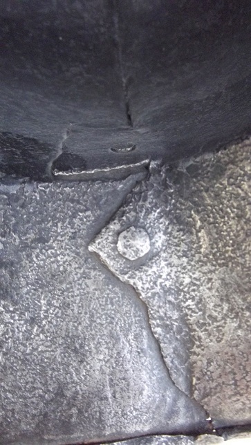

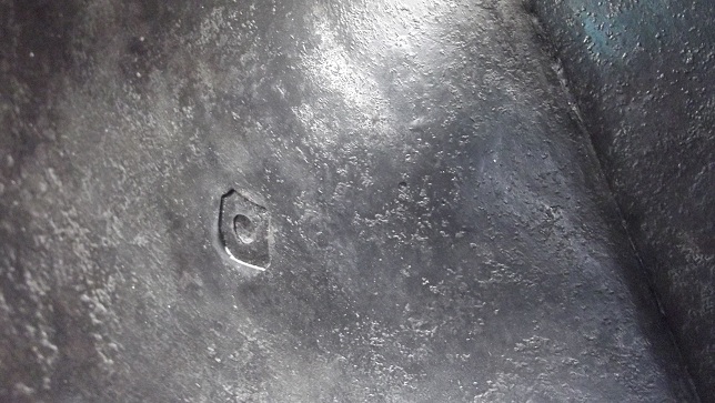

Hi at all,

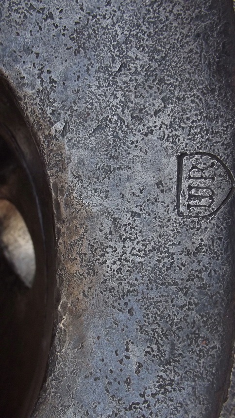

I would ask at forum's collectors if is known this mark ? it is in a riding helmet ( I can not post full the helmet's photos becouse not my propiety and I dont known if the owner agree at full photos, mark no problem ... but it was offered me and Im thinking abaut ) , the helmet is a classic riding helmet from 1600 .
thank you for help .
BerberDagger

Hi Berber Dagger,
Please do understand that definite responses based just on the grounds of one single close-up are not exactly valuable.
Tentatively I should dare say though that this does not look anywhere near any maker's mark I've ever come across. Possibly an iventory stamp, if ever.
Michael

Hi Matchlock,
I can ask tomorrow to the seller if agree with post of entiere item ... but the mark is clear so if known I think it can be recognize olso with a photo like this ...
I hope tomorrow to post the entiere helmet....
becouse you think an inventory mark ? I see a similar mark with WD and RC in horseman helmets from 1600 but never WR.
REGARDS

Sorry but this was my one and only guess.
Let's hope some armor experts will produce more substantial replies.

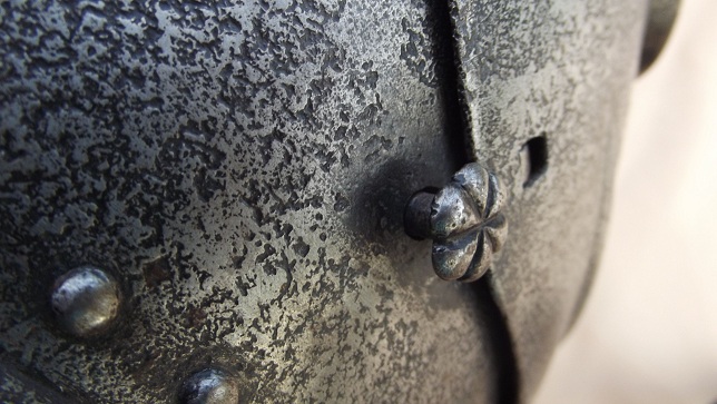

Default others photos owner agree.

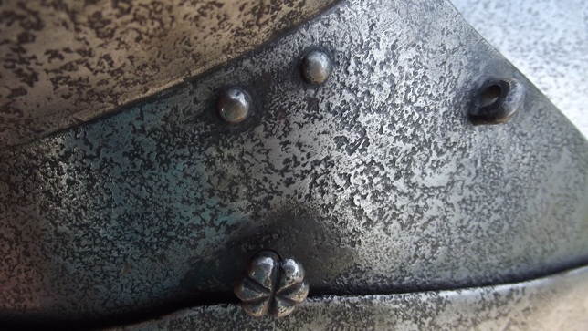

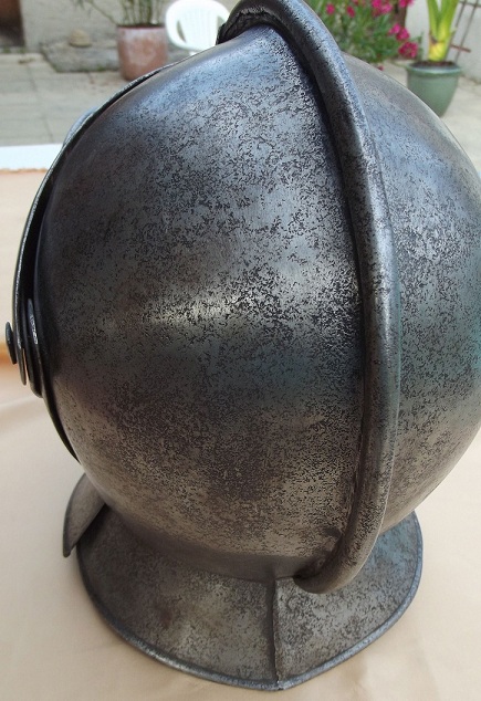

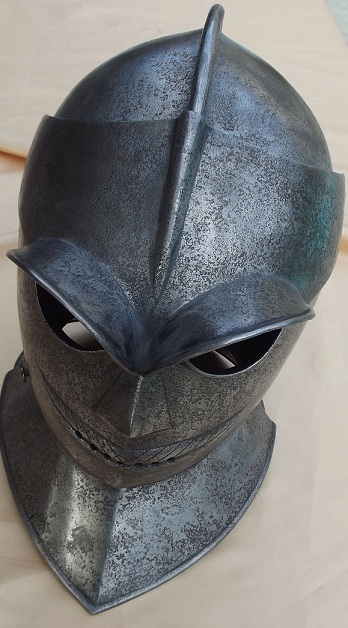

Hello, here pictures of the entiere helmet , the helmet weight is 4165 gr . regards BerberDagger

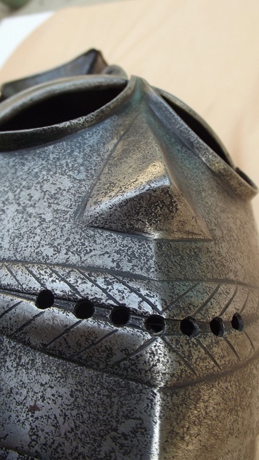

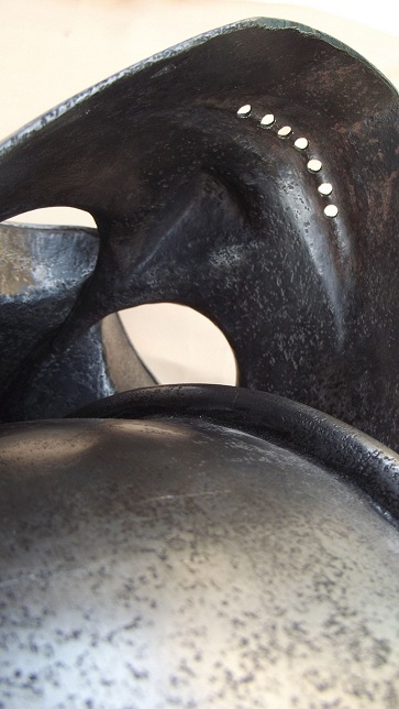

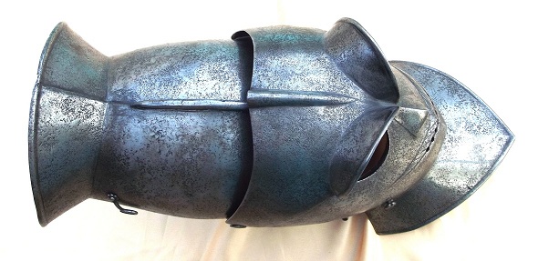

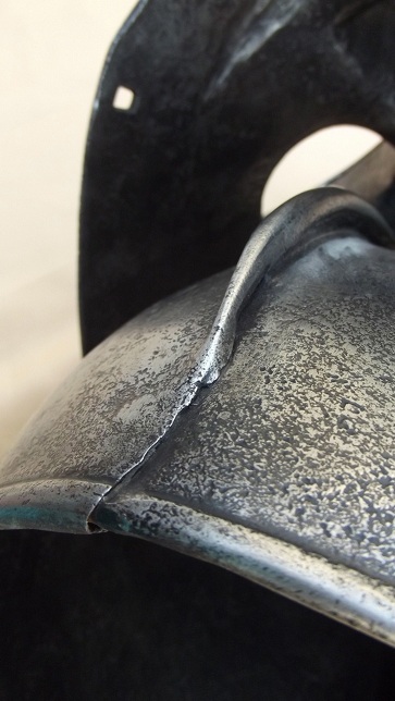

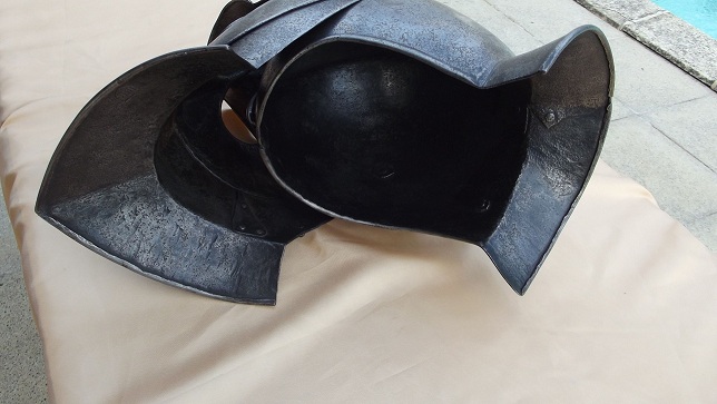

others photos. Best

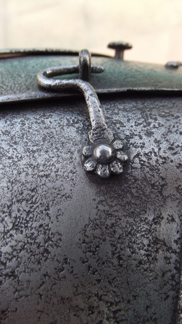

While I cannot help you with the mark, what you appear to have is a very nice example of a 17th century " savoryard " style tottenkopf curassiers helmet. This is a much more finished example of what could sometimes be very crude mass produced helmets for the average trooper ( the very defitintion of " munitions " armour ). The bowl is constructed in two halves which are joined along the crest via one half of the crest being slightly longer than the other, rolled over the shorter and crimped ( an increasingly common technique in the second half of the 16th century, and very common in the 17th ) and the halves overlaping front and back and being riveted. The details of the visor are especially nice. Based on the construction details from the pics I would say this is a nice upper end ( perhaps an officers ) 17th century curaissiers helmet. I am envious!

Thanks for the valuable information Senefelder, in fact I wrote a classic riding helmet , but in fact is a Savoyard with human face mask ....
Thank you very much for the analysis in the construction, in fact the other exemple in my possession is much more crude and in burnished iron and olso more heavy abaut 4,5 kg ....
The mark or the inventory number could be a later addiction ?
I m not able to find in any of my resources a similar mark ..... probably Matchlock is in the right....
Berber
