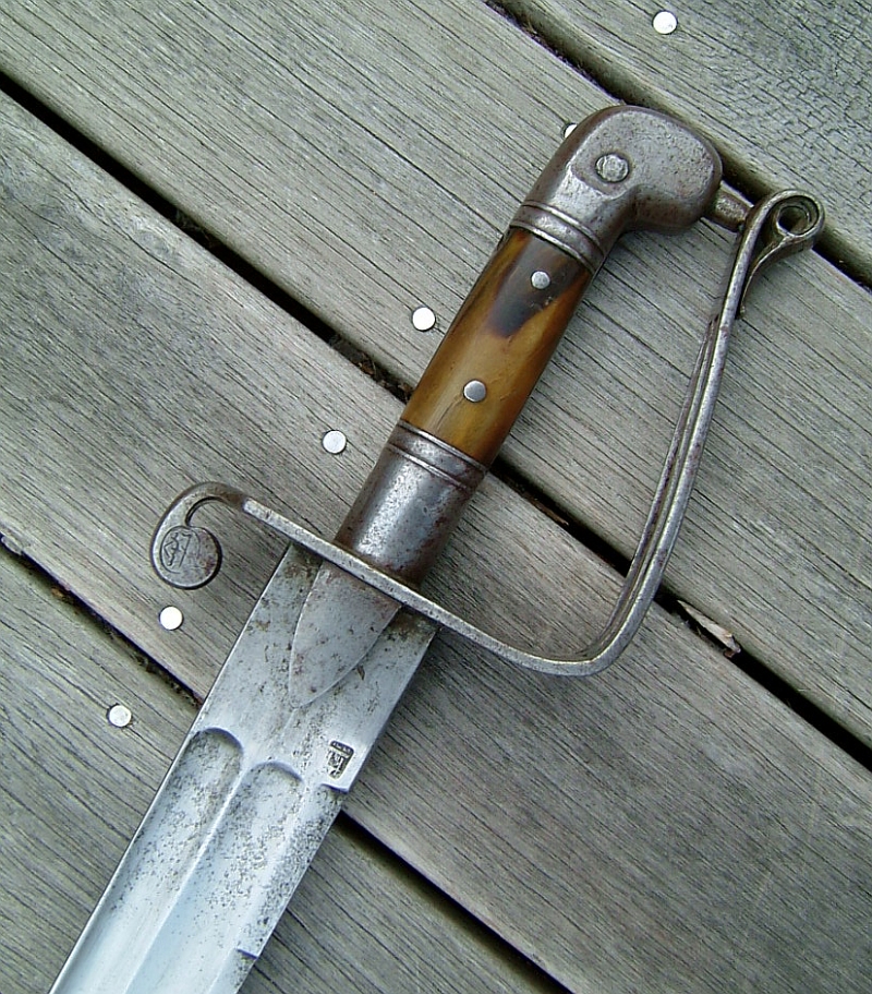

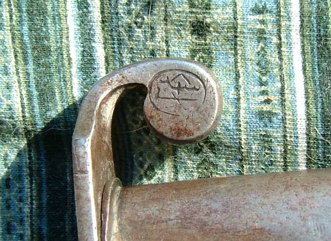

Running this by again:
I know we have some new members, possibly AJ; might you have an idea about the stamp on the quillon ?

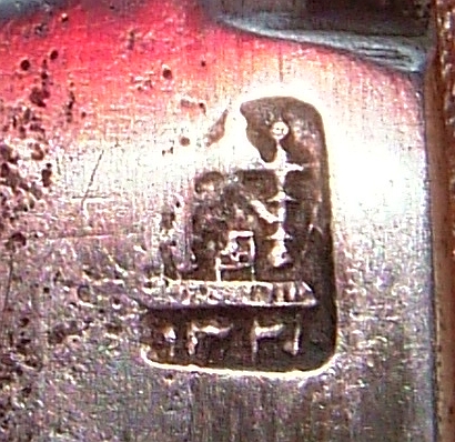

Old 2nd March 2012, 06:45 PM   #3
Posts: 6,436
Had to hunt through old posts to find it .
I think this is the proper orientation .
Thanks !
Old 3rd March 2012, 01:49 AM   #4
AJ1356
AJ1356's Avatar
Join Date: Jul 2011
Location: Nashville
Posts: 317
it is a year stamp, does it have anything on the other side?
Old 3rd March 2012, 03:41 AM   #5
Posts: 6,436
Hi AJ, just a shadow of the stamp on the forte as far as I can tell .
Forte pictured:
A shadow on the reverse of the quillon shown in this link :
http://www.vikingsword.com/vb/showth...t=Afghan+Sabre
Old 3rd March 2012, 07:54 AM   #6
AJ1356
AJ1356's Avatar
Join Date: Jul 2011
Location: Nashville
Posts: 317
The stamp is the government seal of mehrab and munbar (kinda like the alter area of a mosque) it is 69 years old. Made in the Jangalak factory in Kabul during the reign of Zaher Shah. I saw in the link a refference to Mazar e sharif, there was not arsenal or military factory in Mazar e sharif, just the Jangalak factory, localy knon as Kaar Khaana e Jangalak, کار خانه جنگلک you'd also see that in some Marini Henries. hope it sheds some light.

Old 3rd March 2012, 02:21 PM   #8
AJ1356
AJ1356's Avatar
Join Date: Jul 2011
Location: Nashville
Posts: 317
God lord DOM, how many times have I mentioned this? there is two types of Hijri calenders. The start date for both is the migration of the Prophet (pbuh) from Macca to Medina. First one is based on the LUNAR calender هجری قمری, what Arabs are using, each lunar year is about 10 days shorter than a solar year. That is why for example Ramazan move roughly 10 days back each year. The second is based on the SOLAR cycles هجری شمسی, same months as Zodiac calender, used by pretty much all Non-Arabs, (Persians, Afghans, Tajiks, Kurds, Armenians, Azeri, you get the idea). The Solar or Shamsi year starts on the first days of Spring, when the new solar cycle begins. In Afghanistan before the reign of Amir Amanullah they were using the Lunar calender, when he become the King they switched and went back to Solar calender which was being used in Pre-Islamic times. In our calenders right now in each day box there are 3 dates, main one for the Solar day, smaller for Lunar and another small one for Julain date. Hope this helps you out, and stops your colorfull yet useless comments, to whatever I say.

Old 3rd March 2012, 03:49 PM   #10
Posts: 6,436
Thanks AJ, but I'm a bit confused by the answer .
Are you referring above to the stamp on the quillon, or the stamp at the forte ?
Also, thank you for exploding the Mazar I sharif story .
1943 ... hm, iinteresting .
Old 3rd March 2012, 05:09 PM   #11
AJ, I like your enthusiasm, Bro. But you are overreacting
Ditto
Old 3rd March 2012, 05:11 PM   #12
AJ1356
AJ1356's Avatar
Join Date: Jul 2011
Location: Nashville
Posts: 317
Sorry should have clarified, the stamp on the forte. On the quilion is just the date stamp, without the date or at least not readable to me.

Old 4th March 2012, 03:52 AM   #15
Posts: 6,436
At this point I am hopelessly confused .
There is a mark on the quillon, but it is not a date ?
There is a mark at the forte which is 1943 ?
Old 4th March 2012, 12:14 PM   #16
AJ1356
AJ1356's Avatar
Join Date: Jul 2011
Location: Nashville
Posts: 317
Rick, The mark on the forte is for the year 1943, but not the quilion, they quilion just says year, next time I am out to I'll trying finding and looking at swords like yours to see if there was anything else on the quilion.
DOM in Persia, modern day Iran, to my knowledge it happened about the same time. Supposedly around the same time they changed the name from Persia to Iran (early 20th century), they change the yeah format as well. I could be wrong, since I have not read it in a book just have heard it from different sources. In Afghanistan the months are Arabic names of the Zodiac months, and in Iran they use the ancient Persian names. Today is the 14th day of Hoot (afg) Esfand (Ir) Pisces (Zd) in the year 1390, 14/12/1390 = 04/03/2012. Nawrooz (New year) is in 16 days
Old 4th March 2012, 04:19 PM   #17
Posts: 6,436
Ah, thanks very much AJ; understood now.

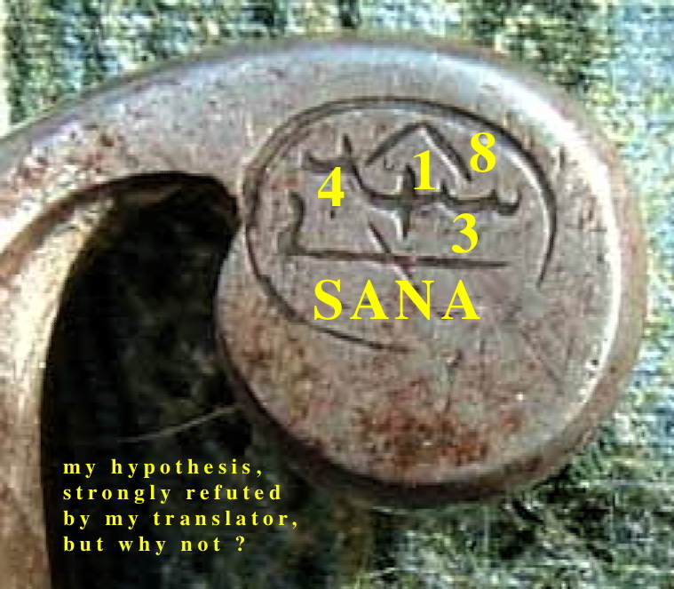

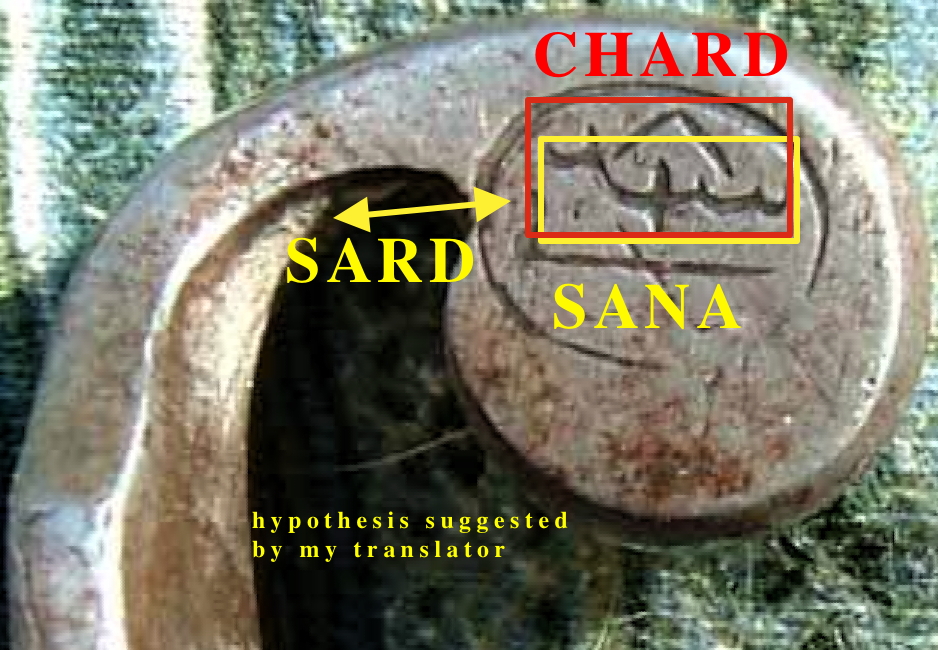

Hi Rick
my translator is back ... but big argumentation about the mark on the "quillon"
as far as, we didn't found a consensus, here our two interpretations
may be that should give some tracks to our friend "AJ",
specially about the digits that "I think" have read
I leave to "AJ" to see with the "Solar calendar", if that could makes sense
keep hope
the words according if we take the sign ^ in consideration or not, should be a name
- with ^ CHARD just a name (?) *
- without ^ SARD just a name (?) *
à +
Dom
* post correction/
- not "chard" but "SHAHD"
- not "sard" but "SAHD"
Old 14th March 2012, 02:23 PM   #24
AJ1356
AJ1356's Avatar
Join Date: Jul 2011
Location: Nashville
Posts: 317
DOM I really love your imagination and commitment it is good But that tends to complicate things mostly, in the stamp we just have the word سنه (sana)(year) then there is the backwards ی symbolizing Hejri , then from bottom up there is what looks like a / the | that goes through سنه and what looks like the number 8 ۸. Now that latter 3 really just add to confusion and do not make and sense, one can't make any numbers out of them or anything. To me they are just flukes, I went and looked at some other swords of the same with the same stamp and those charactors were not present. The words suggested SHARD شرد (شارد) or SAHD سهد (ساهد( do not make anything. If I find a nice example of these I'll take a pic but for now, let's stop torturing Rick, I think he has alot of good info on the item Always looking forward to your colorful pics
