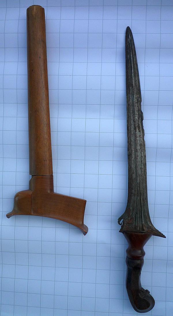

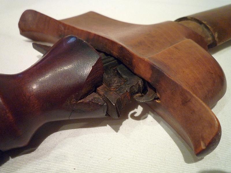

I just received this keris with rather unusual (or at least unusual for me) fittings. The hilt has been elongated with a piece, so that it can be gripped like a sword sabre.
Blade length is 36cm (14.2'') and build rather robust compared to most other keris i have handled (which actually doesn't mean much ).
Unfortunately, it looks like someone couldn't resist the urge to slash at something an damaged the blade.
Despite those nasty breakouts and some surface-rust the blade is in a remarkably good condition.
I bought it from a descendant of a german noble family. The seller rediscovered it 20 years ago in a closet at the family homestead and (until i told him that it is a keris) assumed it was a custom made short sword for one of his ancestors.
Good thing about nobility is that they tend to keep track of their ancestors, so it was rather easy to find out that one of his ancestors held a command at Batavia in the first half of 19th century. Descendants of this officer lived (or maybe still live) in Padang.
With any luck this could be a 19th century blade that still has its original fittings.
Comments are welcome. Especially on the "mendak" thing

really funny ensemble you got there. Keris and sheath seems to be from Peninsula with refitted hilt somewhere in Indonesia, most proable Java since it is a javanese hilt from Central Java. When you want to restore it you need to carve a new buntut for the sheath and infix a adequate piece of wood under the crosspiece. A fitting handle and pendokok would be necessary as well....
A lot of work for a demaged blade IMHO.
Others with a lot more knowledge will tell you more.

Sure, from a Keris perspective the current "hilt configuration" is completely wrong. But assumed
this Keris has been modified by a person with an European background for personal use, all those modifications make sense. The backwards facing hilt allows slashes and cuts with the convex curve of the blade. And the the wooden piece between the original hilt provides a secure european sabre like grip. The conical shape prevents the hand from slipping over the blade during powerful trusts.
The thing, how offensive it may look to a keris collector, has a historic context like Gustav has pointed out. And this makes it interesting for me
But good to hear that the keris-blade itself has some uncommon features, make it even more interesting
And i am also happy to anounce that the modification have been very gently to the original keris. Nothing seems to be filed off, neither from the blade nor from the sheath.
Anyway, i'm still struggling getting the hilt off using the candle-method described by Alan in another thread. Assessing my progress so far this may take quite a while...

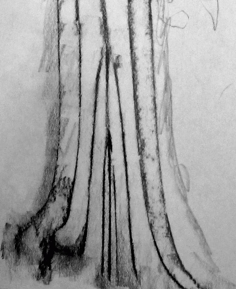

I know what Gustav mean, the blade look in the sorsoran area very very weird so you can think that it is modified. I guess that it is a Peninsula blade so my hope is that Kai Wee see this thread and can tell us something about this blade.
When Thilo has opened the hilt it would be good when he post again some pictures to get a better view from the blade.

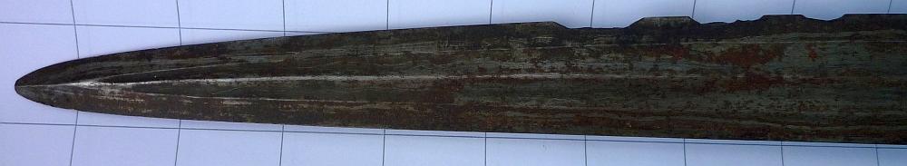

I am also interested in this kind of blades with multiple sogokan/srawejan/kruwingan. As I understand some of them are attributed to Sumbawa (post #19 and #49 in this thread:http://www.vikingsword.com/vb/showth...light=kalawija), yet it probably is possible, such blades are occuring in central Sumatra or even Peninsula.
By the way, it seems there is a possibility this blade is having pamor.

The keris has a pamor, but it is barely visible in its current state (certainly not on the pictures i took).
I think your impression that gonjo and sorsoran are flattened are due to my poor photographic skills. I will try to make better pictures as soon as i get that hilt off
Meanwhile i tried the good old pencil method.

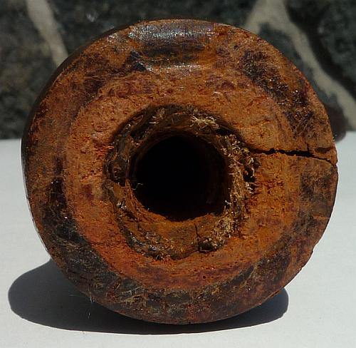

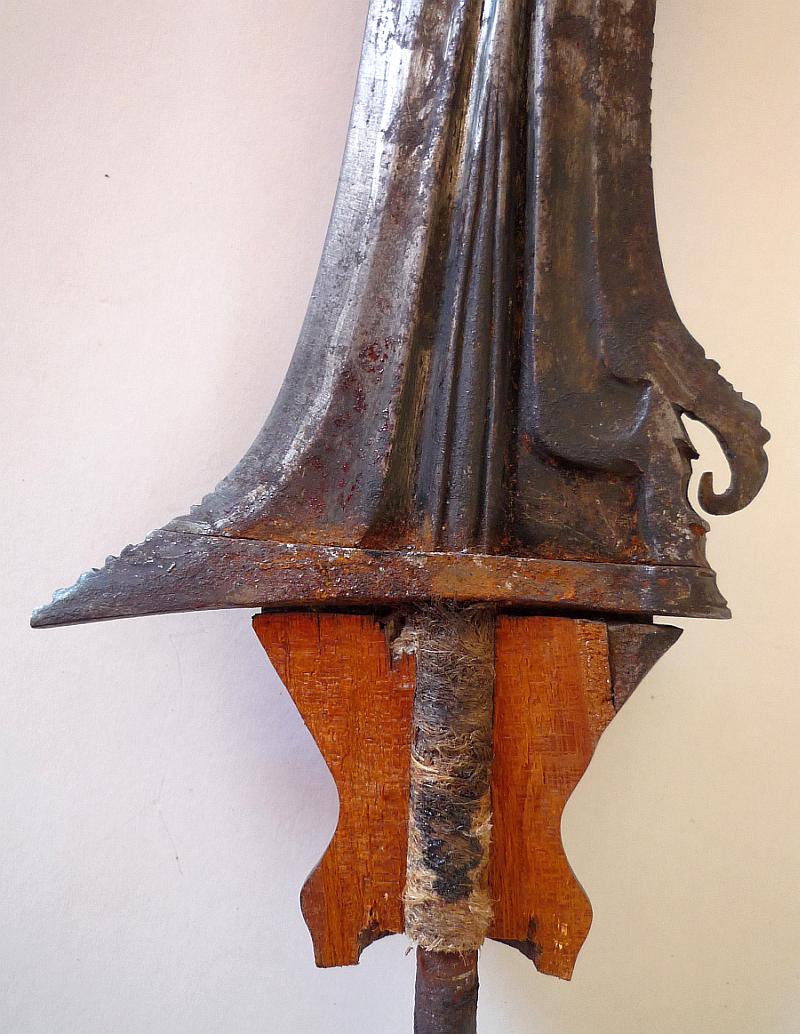

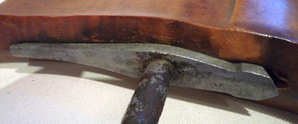

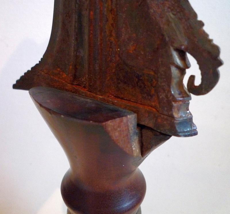

Here are some updates.
After several heating sessions, i finally got the hilt off.
Sadly, the heating and twisting was too much for the wooden crosspiece. At least the split is very clean so it can easily be glued.
As can be seen on the smaller picture, the "javanese part" of the hilt is filled with terra-cotta. The pesi was wrapped with a composite of resin and some fibrous material (similar to hemp).
Best Regards,
Thilo
mrwizard is offline   Reply With Quote

I don't know Thilo, doesn't seem like such a sad thing to me. Now you can move forward towards a more "correct" dress for this blade. Frankly i wouldn't make use of the Javanese hilt that remains either since this clearly is not a Javanese blade. Some of our friends in Malaysia might be able to help here, but my guess is that this is a Peninsula blade. Perhaps you need a nice Jawa Demam hilt for this.
Also i've been meaning to add, and this is probably obvious to most, that while someone may have done damage to this blade while slashing with it, the keris is not a slashing weapon, so this was never intended to be a "keris for slashing"...

Hello everyone,
Yes, the keris looks a lot like the Sumbawa types shown in the thread referenced twice. And the pictures in post #1 show how i can hide the damage to the sheath.
But, regarding the historic background of whom i got this keris, i suspect (the also mentioned) central sumatra to be more likely the point of origin. As i have written in the first post, the family i got it from had relatives in Padang. Further research revealed that they moved there before 1831 (first recorded birth) and lived there for at least the next 120 years (last recorded death 1949).
Of course, considering that both Padang and Batavia where important harbours, the keris can still come from Sumbawa or from the Peninsula.
@Alam Sha
Yes, on the photo it might look like that, but the kembang kacang area fits sheath nicely. It just doesn't get fully in because the Warangka is not cut deep enough. The gonjo stands out 5mm to accomodate the strange wooden hilt piece. Therefore, i suspect that the sheath has been made for exactly these fittings.
Since you have seen similar keris with such a long tang. What did the dress look like? Did they have overly large hilts or large mendaks?
Edit: Ooops sorry, Gustav just pointed out in PM that the referenced thread already has some examples of keris with very long pendokok (e.g. post #51) and examples that would accomodate very long pesi (#52 ).
Best Regards,
Thilo

Well Sumatra is perhaps the origin of the sheath, but i doubt that the blade itself originated there.
I just noticed from the close-up in post #18 that it seems to have a pamor wengkon. It will be very nice to see the blade cleaned and stained so that we can see this pamor stand out.
