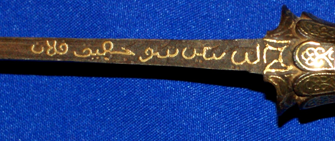

Hi,
This peusangan form Aceh / Atjeh is from a friend. It is unfortunately without scabbed.
There is a gold inlay text on the backside of the blade. I think this is the name of the original owner.
On the blade it self there are also gold inlay, this can be a Koran text
Can someone help me with the translation of this arabic script in Malay language?
Thank you,
Jonno

Hi Jonno, this is indeed a beautiful piece of sikin that i have ever seen
As I see it, there are names of God - "Allah, Allah" intricately interwined in the gold floral works, at the side of the blade.
While it may be difficult to decipher the words at the top of the blade (as some of the goldworks have already worn off and lost), the words could read as follows:
"Ini sikin Teuku Jalit/Jalik Pekan/Pelan" which means "This is sikin Teuku Jalit/jalik Pekan/Pelan".
As some of the dots / stroke in the arabic alphabets / words are either worn off and lost, I can only deduced and decipher from the black marks left on the lost goldworks.
Jentayu is offline   Reply With Quote

Thanks!!
Yes, there is some inlay lost.
I tried to make a better photo.
Jonno is offline   Reply With Quote

Hi Jonno,
From what I could decipher, it reads: "Ini (ni) sikin Teuku Jalit Pekan" - translated as "This is sikin Teuku Jalit Pekan".
It is quite a weird name, in my opinion. Was it meant to be Teuku Balik Pekan, where probably Balik Pekan was a name of a district or area? The word "Jalit" - spelled as "Jim, Lam alif, Ya & Ta" can also be seen as "Ba, Lam alif, Ya & Kaf" - translated as "Balik".
