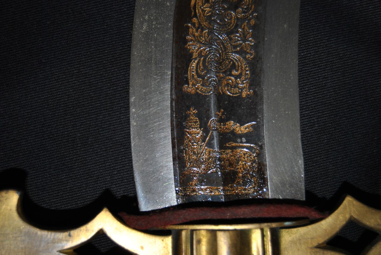

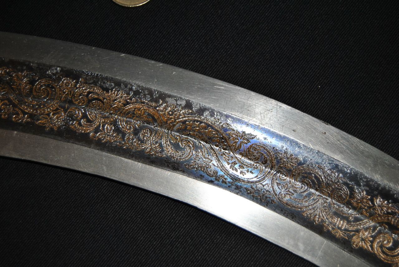

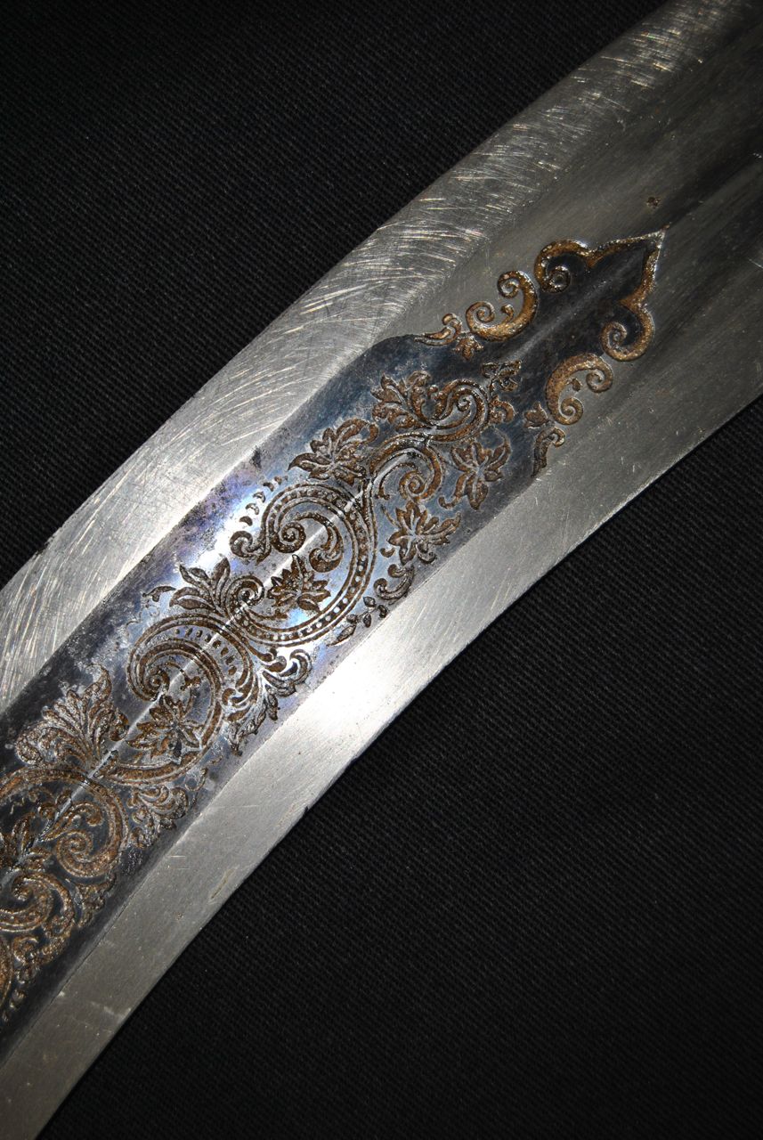

A REMARKABLE SWORD. I WOULD SAY IT IS EUROPEAN MADE POSSIBLY GERMAN ,THE HORN HANDLE LOOKS MORE LIKE WATER BUFFALOW HORN NOT RHINO HARD TO TELL FROM THE PICTURES. IT DOES HAVE THE ETCHED AND BLUED BLADE WITH THE ETHIOPIAN ROYAL LION AS OFTEN SEEN ON IMPORTED GERMAN BLADES. IT INCORPORATES SOME TRUE ETHIOPIAN DESIGN BUT IS ARTISTICALLY MODIFIED TOWARD MOSTLY EUROPEAN DESIGN. VERY PLEASING TO THE EYE AND LIKELY ONE OF A KIND. WITH BETTER PICTURES PERHAPS SOMEONE CAN READ THE INSCRIPTION ON THE BLADE.
MY GUESS IS THIS WAS SPECIALLY MADE TO BE PRESENTED TO A PERSON OF IMPORTANCE IN ETHIOPIA. PERHAPS THE INSCRIPTION MAY SHED SOME LIGHT ON WHO MADE IT OR WHO IT WAS PRESENTED TO. GOOD LUCK

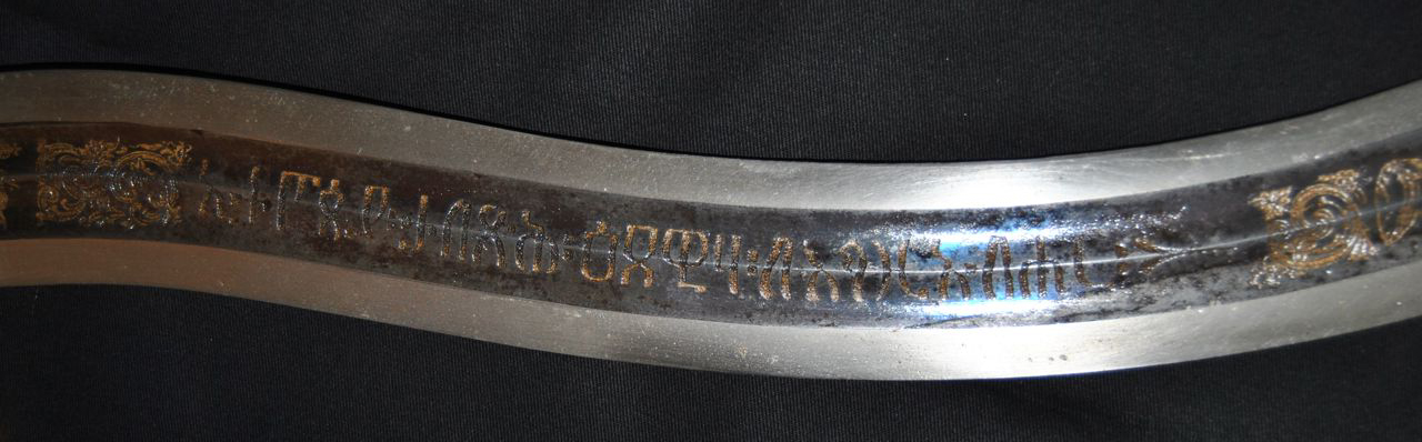

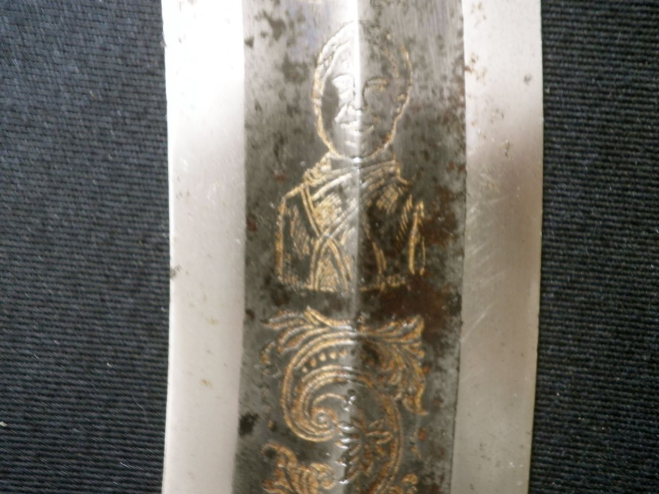

Absolutely fantastic piece. Trade? Sell? Just asking.... The inscription on the blade is backwards. Flip it 180 and it will read ITIYOPIA: TEBETSEHE: IDEWIHA: BEIGHEZEE'EBIHER:: That is: Ethiopia reaches out to to God.

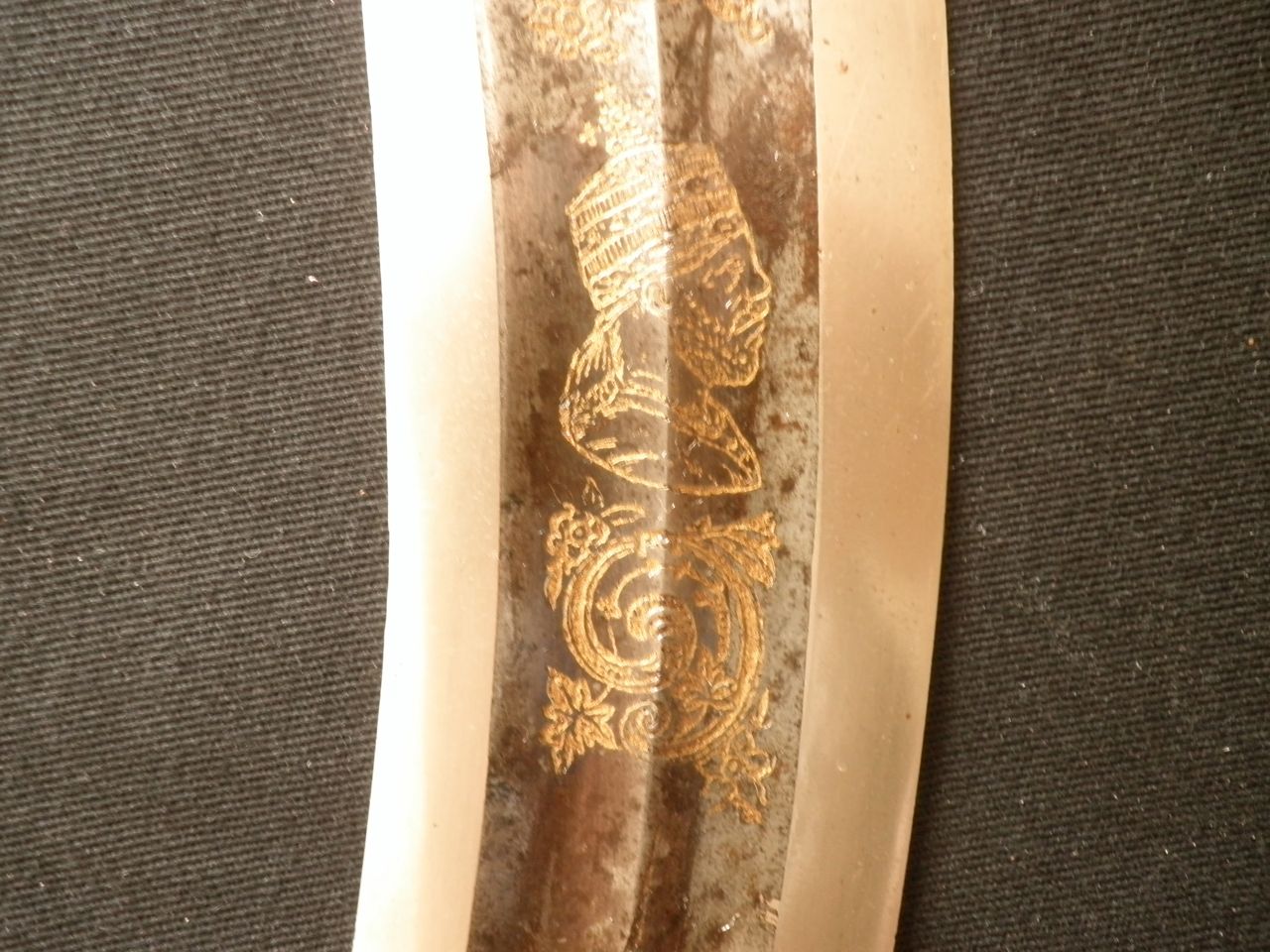

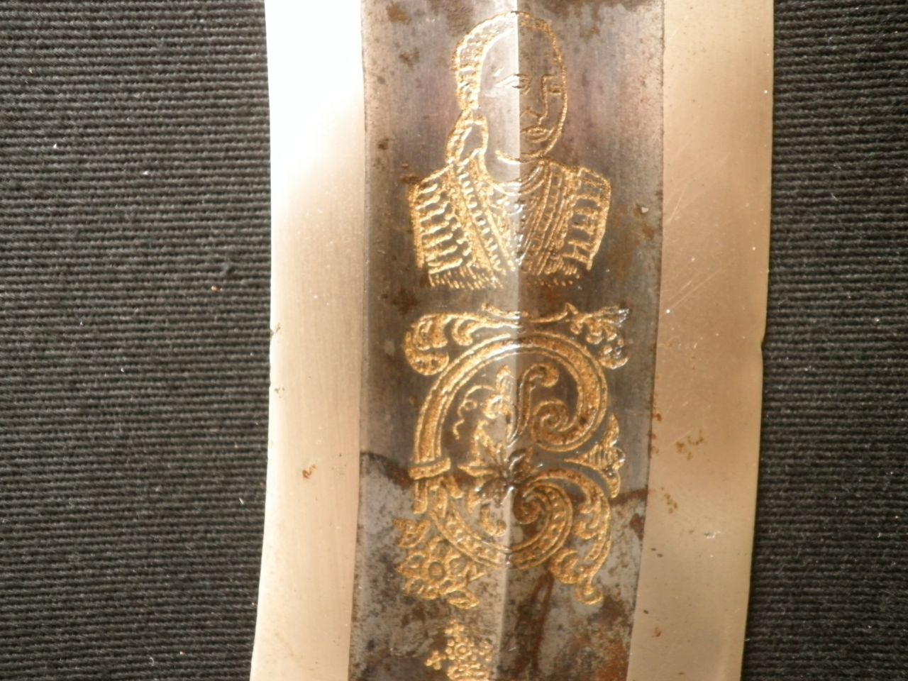

It is one of the most common inscription found. It is written in Ge'ez: the ancient language used by the Ethiopian Coptic Church. The faces are those of Menelik II, Zewuditu (Empress) and (this is a guess..) Lij Eyasu. I have seen (and have one myself) some straight bladed SAIF swords with the same faces and inscription. I would say these blades are German. But...?? British is another guess. I will venture to say that the hilt was retrofitted. Maybe at the factory itself so that the blade could be handled. By the way, the hilt was mounted backwards as the shotel will have the tip pointing towards the opponent. Also, the red felt spacer would not make sense on a leather scabbard. Then again, I doubt this blade ever had a scabbard. Hilt looks Victorian. Not rhino. In any case, it is wonderful.

For the moment, just asking and showing, many thanks for yours reply, I will showing more details of the faces.

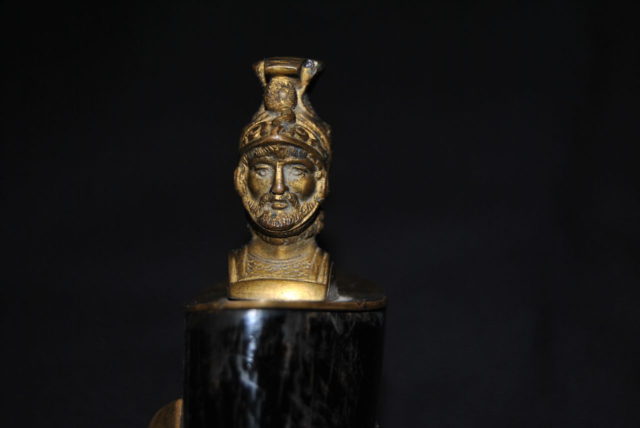

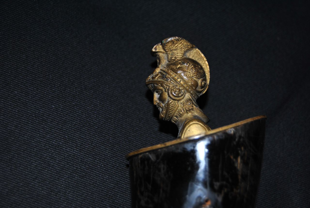

Hello everybody, very nice shotel. Regarding the blade it could also be French: difficult to say. Roanoa is right that the same trylogy (Menelik, Eyasu and Taitu) is found also in other blades from England or Germany. However, the pommel with this classic head also has a French smell with this Greek hero and a classic helmet. The helmet has what appers to be a falcon but I do not see well if there is also a snake. It would be necessary a detailed photo on this part. On the side of the helmet seems that there is a sphinx. My knowledge of classics are not strong enough to recognize the God depicted in the Pommel. The falcon and the snake are sacred to Horus and Horus is compared to Apollo but this is only a supposition. France ??

Hi Martin. The inscription is taken indeed from the Coptic Bible and could be read as "Ethiopia asks for God's help", "Ethiopia reaches out to God", "Ethiopia holds its hands up to God". Liberal translations, but meaning the same thing. I understand Haile Selassie closed his speech to the League of Nation protesting the Italian invasion of his country with these words.

I am probably way off but take a long hard look at the helmet on the head pommel knob. I may well be French. The winged sphinx is seems a hang over from the French exploits in Egypt. Look at the side view, the crest is an eagle. The face on view ie the beak is more stylised but it does have a snake in its mouth. I think that is most intesting considering French action in Mexico.

Truly remarkable piece. I would say that the hunting hanger style grip represents distinct European style for earlier court oriented weapons, and the neo-classical figure on the pommel suggests French hilting. I would say this is probably a diplomatically intended presentation or gift to a figure in important standing in Abyssinia. This high end piece might have to do with dealings during the Anglo Egyptian condominium and post Fashoda incident (1898) territorial disputes in these regions between that and France. The blade to me seems German. It is tempting to align the fluer de lis style in the quillons to France also.

Just for the fun of it, since I am not that much into mythology, that does not look like a Sphinx to me... A Chimera? Not that it makes much of a difference....

Okay. winged lion sphinx like thing .

Since it seems to me that the character of this 'shotel' reflects prevalent French character (the pommel is likely the neoclassic image of Mars/Ares), with likely a German made blade, the events of these times suggest the possible diplomatic nature of this sword.
