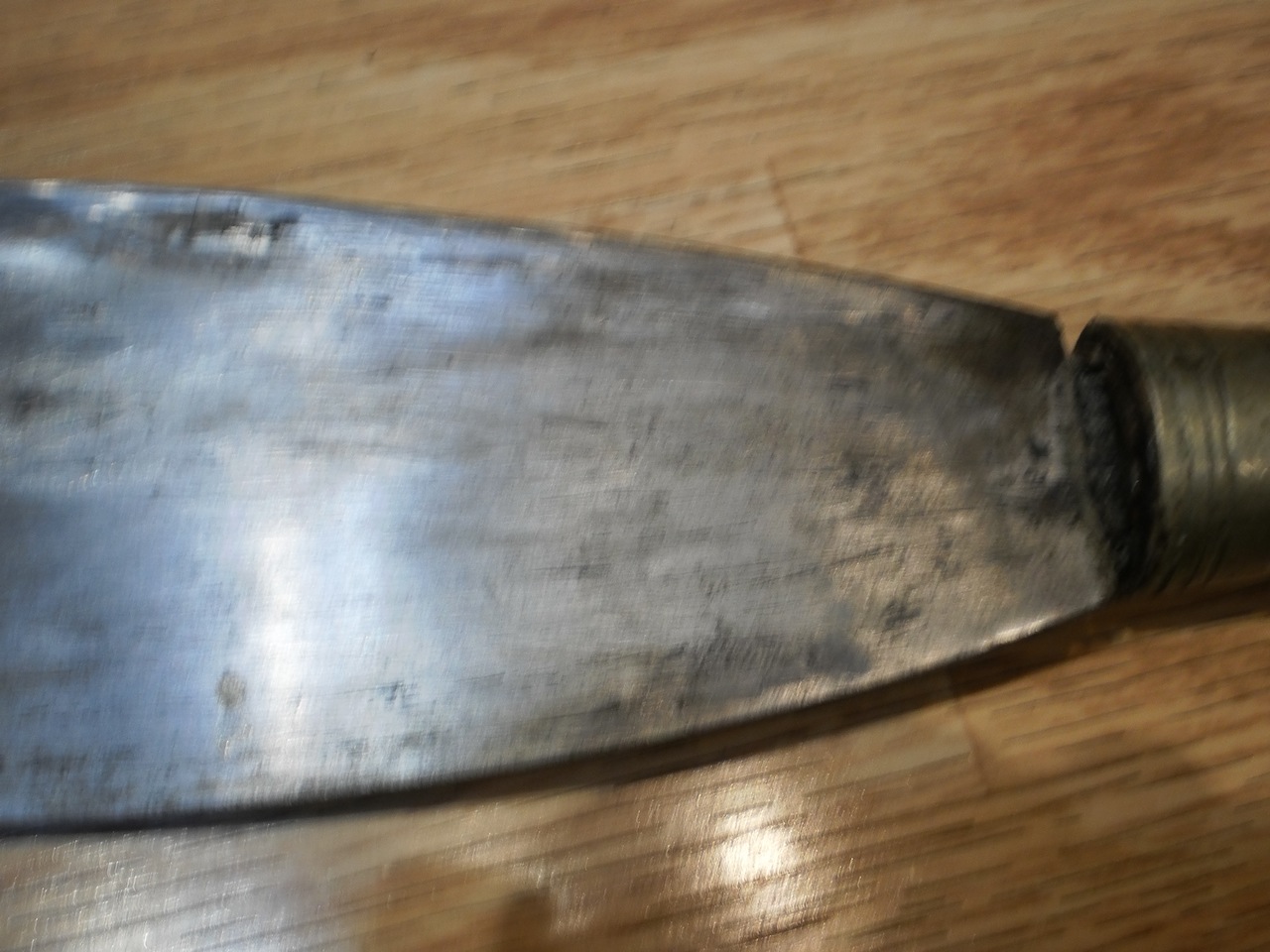

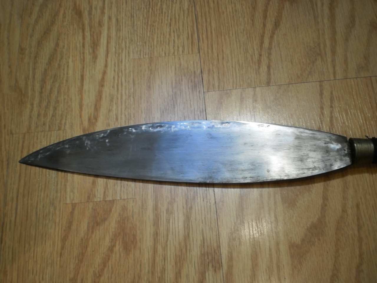

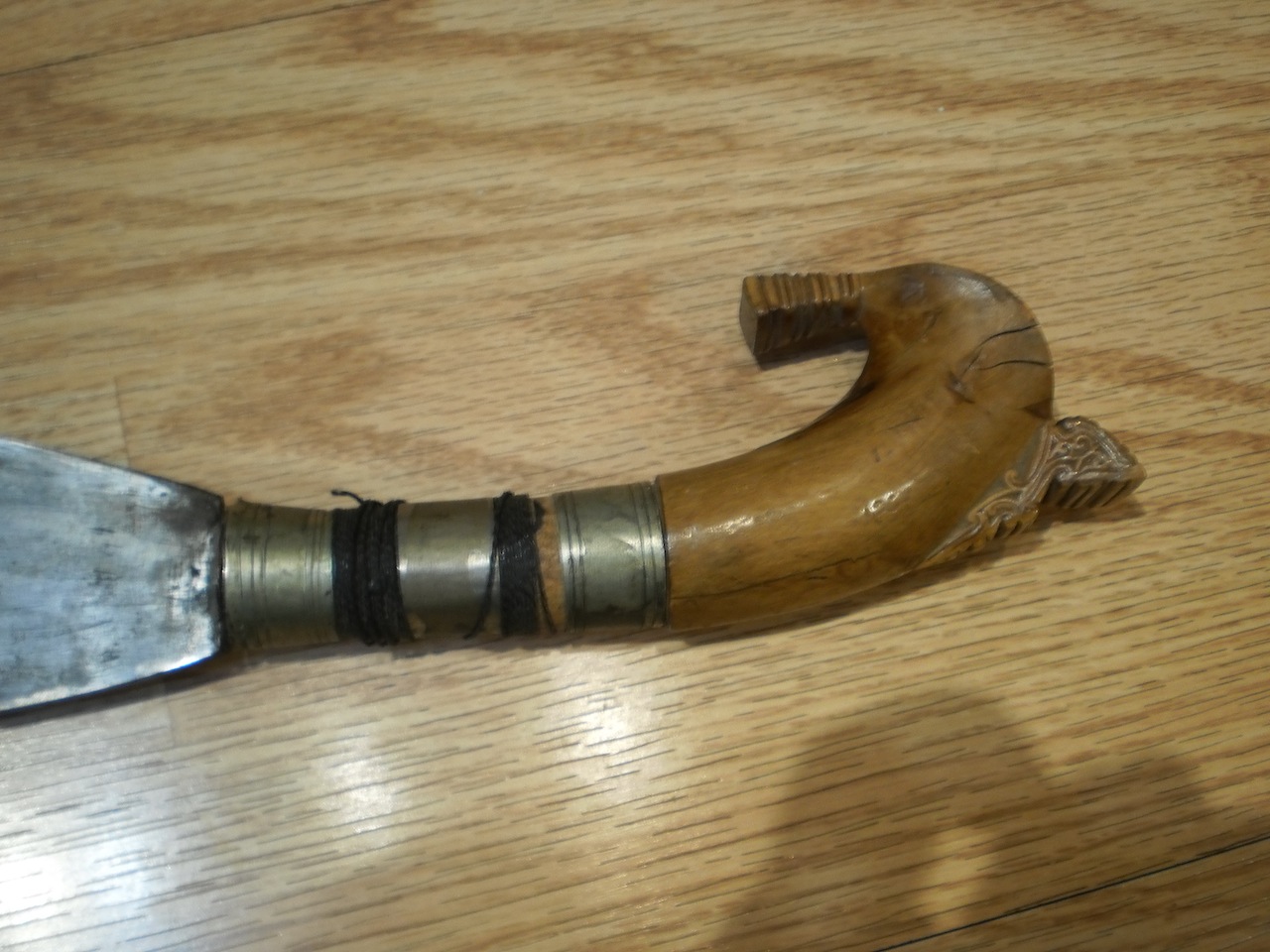

I found this at a flea market near me. I'd like to know what everybody thinks. The blade has a really nice distal Taper. I would like to clean it up enough that I can see if it has an inserted edge, so I'm probably going to use very fine crocus cloth to polish it up. The handle is totally loose, and I'm not sure what to glue it back in with. The scabbard is marked “Kamlon Campaigned".
Any ideas?

Real. Kamlon was Jikiri's version in the mid 1900's. A distant relative of mine fought in that campaign...

Hello Montino Bourbon, If you could, please post a close-ups of the hilt and blade. Could you also tell me how thick the blade is at the hilt? There is the possibility that it could be a good blade with a poor quality replacement hilt.

The Blade is one quarter of an inch thick at the hilt. Is it worth cleaning up? Would I use fine crocus cloth or some other thing to polish up the blade?

I agree with Spunjer. I would go ahead and clean it up and give it an etch just to see what happens.

Thank you so much; I started cleaning it up now. There are, unfortunately, some pretty deep scratches near the edge where it was probably put on a grinding stone. I'll do my best to take them out.
“Try not to cut your fingers off”; I love that. This Barung is wickedly sharp still.

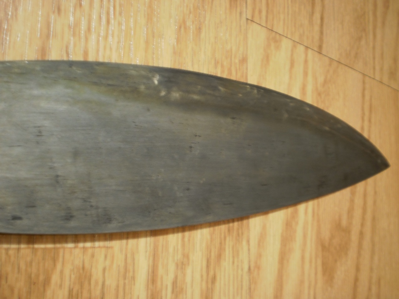

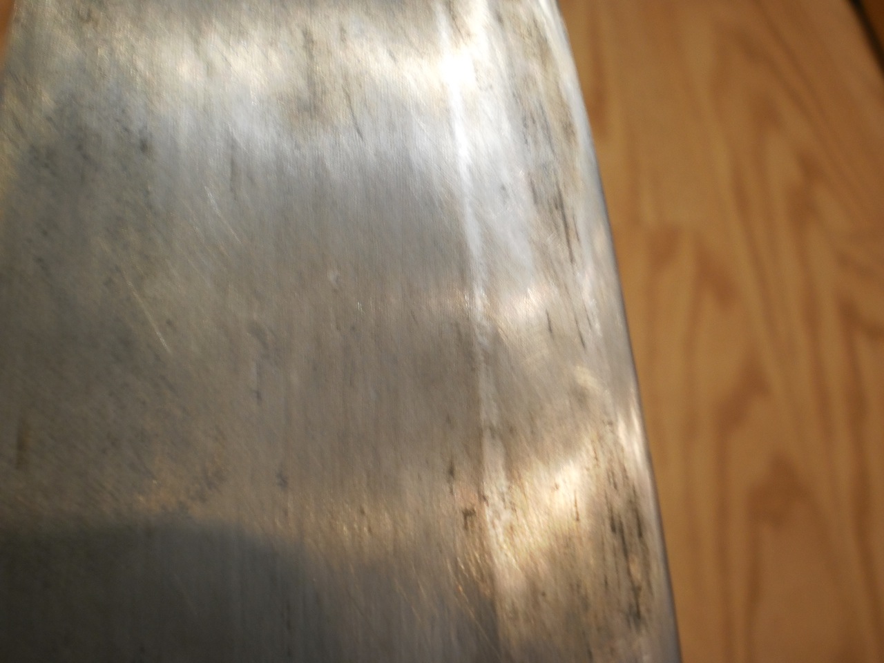

so I went ahead with 600 grit, followed by 1000 grit for the edge, then edged it with vinegar. Result; nothing.
I then tried again with ferric chloride diluted 4 to 1, and behold! Either a temper line, or an inserted edge, I'm not sure which, but it's very very clear.
Opinions, please?

Looks like an inserted hardened edge to me.

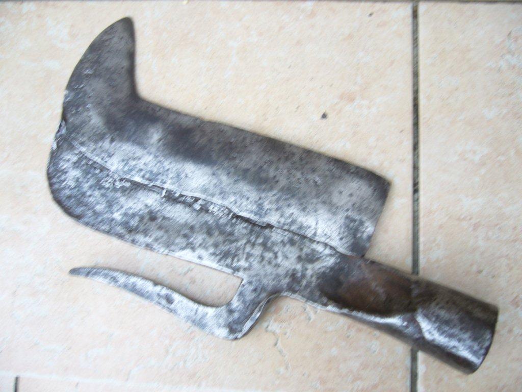

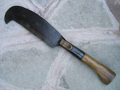

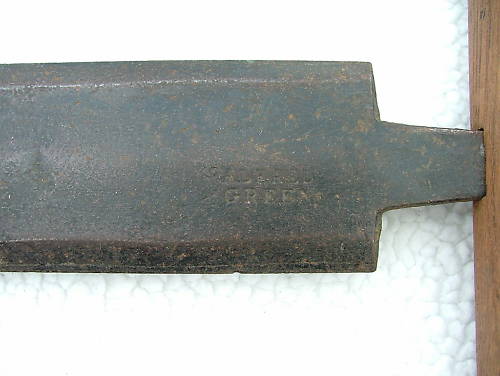

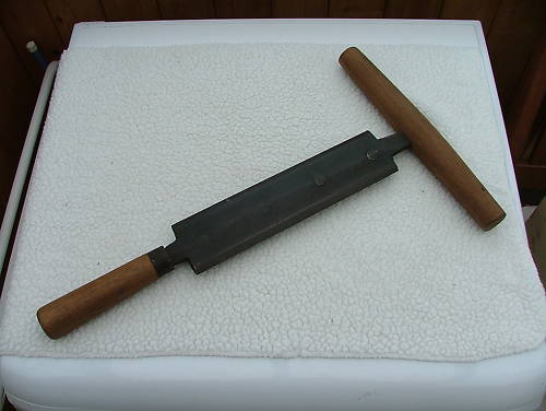

Ref insrted edge - you guys must be sick to death of me going on about edge tools, but here is another instance of tool making technology that can apply to making swords and other weapons....
English scythe makers forge welded a sandwich of high carbon steel with a mild steel back between two pieces of wrought iron. This minimised the use of the more expensive carbon steel, gave a tough flexible body to the blade and protected the carbon stel during hardeneing and tempering. This technology continued up to the 1940's in Sheffield, and the 1960's in Belbroughton.
See http://www.youtube.com/watch?v=AqV3jtkQSe4 for the Clay Wheel Forge in Sheffield - a similar DVD/video of the Nash Works can be obtained from the Belbroughton History Society....
Other makers such as Elwell used their own rolled 'sandwich' and even offered it for sale to other edge tool makers..
Billhook makers also used the same methods in both France and the UK, although more commonly a high carbon steel was face welded to a softer body, giving a very pronounced weld line... Axe makers tended to insert a steel bit into the body, a method also used in the vineyard hoes of Bernard Solon (Maison Alexis) in Orléans, France
http://philippebachelier.com/Portfol...rtraits06.html or http://dytic.over-blog.com/article-d...-59608149.html there is an article in a french blacksmiths' magazine showing the stages in the manufacture - I do not have the web-link handy, but he won the annual prize for his work a few years ago...
The weld line clearly shows in the edge of the currier's knife made by Alfred Green (UK) and the difference in patination on the William Swift (UK) billhook, and very clear on the French billhook blade..
