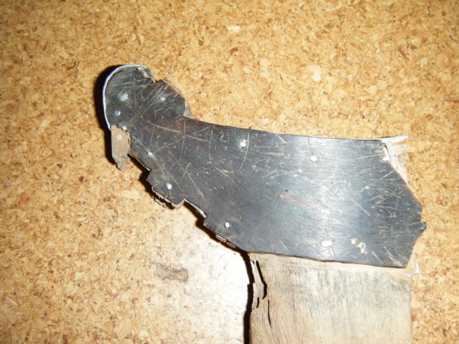

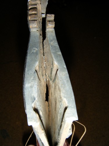

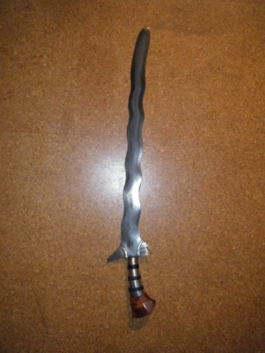

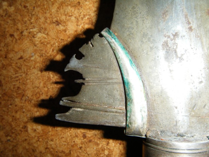

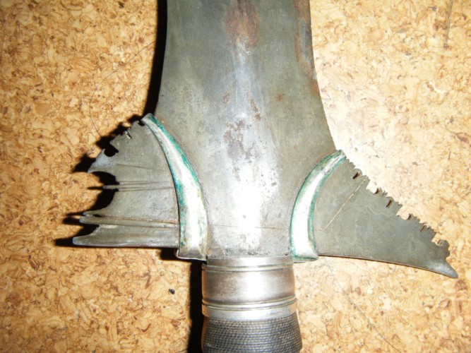

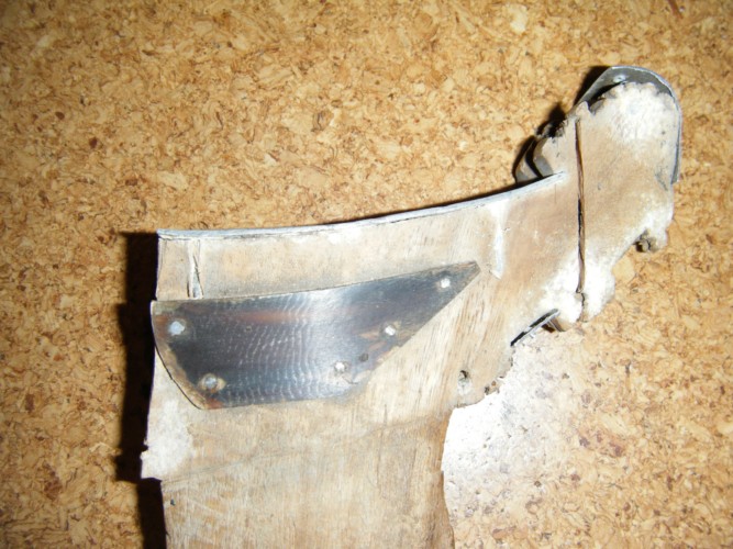

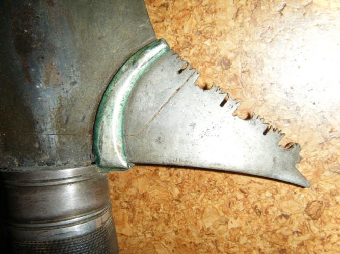

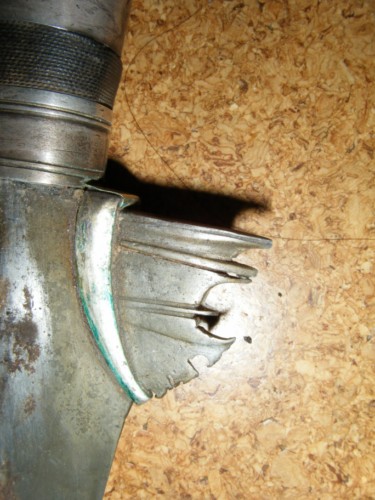

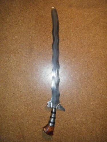

Today I received the kris, with the kris I am very pleased but the sheath is in very poor condition like already to seen on the pictures from the seller. There is no mother of pearl but maybe have been there before?
Here some first fast taken pictures.
Old 15th December 2010, 07:36 PM   #15
Posts: 7,421
Well looks like a true separable ganga - good for you!
On the scabbard, looks like it had horn.
Old 15th December 2010, 11:59 PM   #16

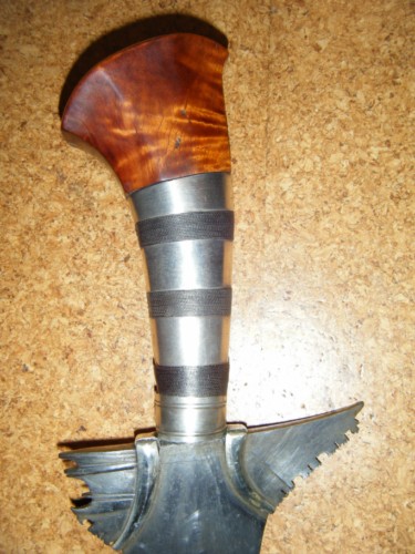

Yes, separate gonjo. The back of the cross-piece of the sheath is covered with horn but in front the cutting lines of the piece of horn are very straight so it was my first guess that it was framed with an other material and this guess was MOP. But now I am very sure that it was aluminium since at some places it is still present. The up from the mouth for example is covered with this metal and also the nails whereby the horn is fixed to the wood are from Al. And I think that I have seen something similar before.

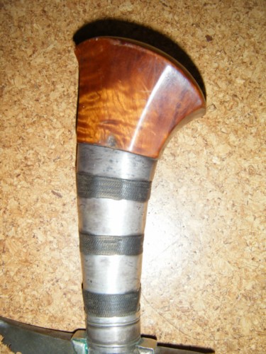

BTW, I have cleaned the handle and polished the blade and think that I will etch the blade tomorrow. Here a pic of the cleaned handle.
Old 16th December 2010, 12:24 AM   #17
Posts: 7,421
Nice. Yeah looking again at the front of the scabbard, I agree that it might have had MOP surrounding the little section of horn.

Thank you! Yes, I think there have been MOP or more probably a aluminium frame since there are still some pieces of this metal existent.

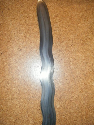

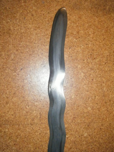

Have etched the blade this evening and it schows a similar lamination like the last one. Is this a very common lamination by philippine kris blades?
Old 17th December 2010, 02:59 AM   #24
Posts: 7,421
Actually yes, it is a common lamination pattern for many Moro pieces, especially after 1800.
