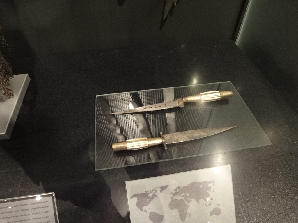

Old 3rd October 2010, 09:35 PM   #8
laEspadaAncha
Posts: 608
Originally Posted by Atlantia
Naval Dirk??
This must have been the 'cabin boys' then!!
Hi Gene,
While tangental to the discussion of this particular knife, I thought I'd include a photo of my own (smaller) example along with an even more diminutive navy knife. The Spanish dagger below is about the same size as your own (I'd estimate it's maybe 3/8 of an inch smaller in overall length). Next to it is a knife made under contract for the U.S. Navy in 1864-1865, which as you can see is significantly smaller than the Spanish dagger...
I'd say the moral is to never underestimate the utility of a knife of any size, whether on land or at sea!

Old 4th October 2010, 07:49 PM   #14
laEspadaAncha
Posts: 608
Hi laEspadaAncha,
The one like mine is lovely, nice scabbard too!!!
The other one is interesting, I've seen them and ignored them, thinking them mid 20thC belt knives What exactly was their function in the naval context?
Time for a reapraisal for me I think
Best
Gene
Hi Gene,
Belt knives to be sure, and in the past 200+ years, they really haven't changed all that much IMO. Of course, as form follows function, I can understand why.
Truth be told, I'm unsure of the intended function such knives would have served on a ship. I would hazard to speculate that the utility mirrored the general utility of any pocket knife or belt knife on land, past or present. I think of more modern rigger's knives, with their marlin spike, and the accompanying blade that is smaller than this example...
Regarding it's exact function though, I honestly have no idea. My only experience sailing was as a kid, in my late grandfather's small sailboat around San Diego harbor... Maybe one of our more nautically-knowledgeable members an shed some light on this.
Chris

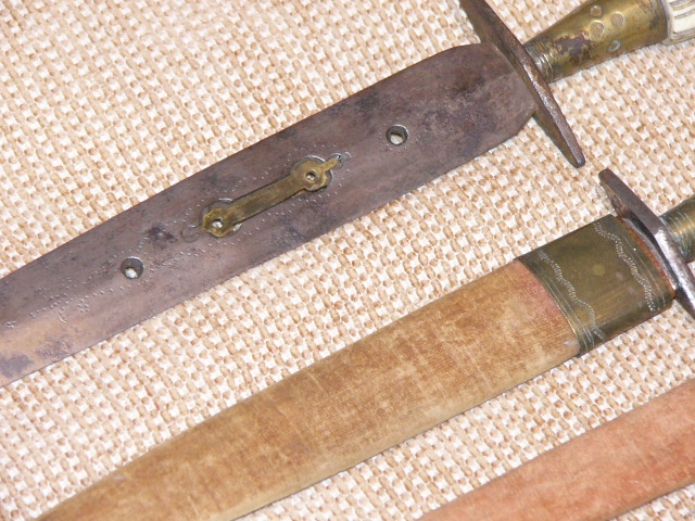

carlos
Hi carlos,
I see. Thats even more of a burn that I got rid of the larger one I had.
You can see what I mean by small though? Its tiny compared with the type A that I've got:

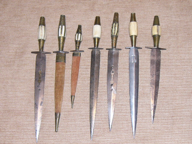

Old 12th October 2010, 07:35 PM   #24
carlos
Posts: 755
Thank you Carlos
Keep looking, you'll find one eventually.
I've been looking for a while now to get this type B.
Would you post a picture of your 5 examples? I'd very much like to see them.
Next I would like a lantern hilted one, pierced blade type B, or type A with 'offset hilt'.
They are beautiful!
Best
Gene
Hello again!!
I just take a picture frommy collection of this type of knives. I hope you enjoy it.
best regards
carlos

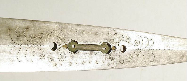

Originally Posted by carlos
Hello again!!
best regards
carlos
Fantastic collection Carlos!
What is the size range from smallest to largest?
I've heard that the pierced blades are for poison, do you think that is true?
What about age?
You have a great collection, something for me to aspire toward.
Thanks for sharing.
Best
Gene
Old 12th October 2010, 08:20 PM   #26
carlos
Posts: 755
What about age?
Thanks for sharing.
Best
Gene
Hello!
The bigger has 13 in and the smaller has 8.5 in. In Spain this type of knives are easy to find and not very expensive, 100 euros to up, the age are from end of XIX century.
I know a book, with more information about Albacete cutlery, " INTRODUCCION AL ESTUDIO DE LA CUCHILLERIA ARTISTICA DE ALBACETE".
Best regards
carlos

To place yarns while fixing boat sails.
BTW, this type of knife was brought to the Philippines by the Spanish, and it is still being made there, _exactly as it was during the 18-19th Cs._
From what I remember, it was also made in Spanish America, namely Mexico and Peru.

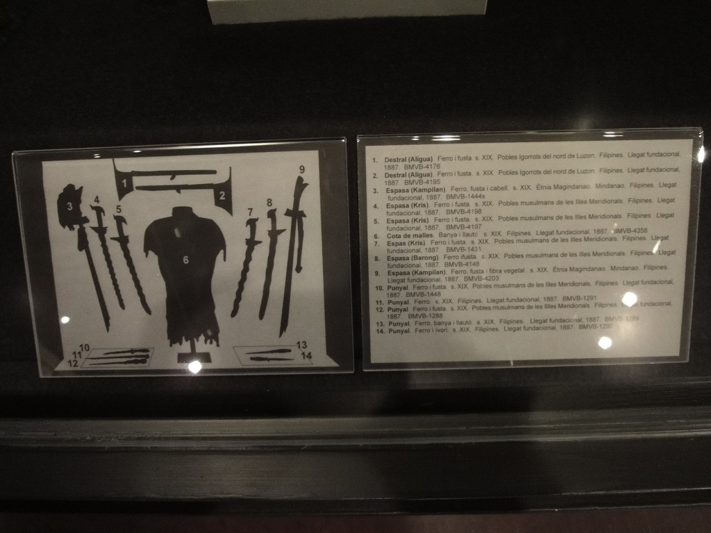

There's two at Victor Balaguer museum, near Barcelona (pics below).
I also two to three such daggers in Museo Oriental in Valladolid, Spain (grouped under the Philippine collection). Thanks.

One of those puppies that is in my collection... I had also a tiny one, but I've sold it as it was very rusted.

Carlos,
Thanks, I've seen the book, but it was a little expensive, and my Spanish is nearly nil!
I think if I lived in Spain I'd have a huge collection of these!
Manolo
Fixing sails? Thats interesting (although I liked the poison idea better!) What purpose would the brass sheet insert serve? How do you use it with yarn?
migueldiaz,
So those are in a Spanish Museum, but their origin is definately philippine?
Valjhun
Very nice example
