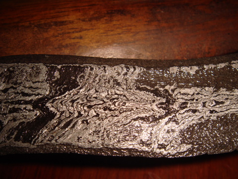

I just learned from some NET sources that kerises from Majapahit and before do not have wojo or slorok. Is this true?
Just to clarify, we are talking about that greenish part near the edges that is distinctly different from the darker, blacker iron part that are sandwiched within the pamor area. I will try to find pictures later.
Is this a definitive guide? Any exception to the rule? Is it not possible to see an authentic keris with distinct sepuh style of daphur (Pajajaran, Segaluh, Singasari, etc) with wojo?

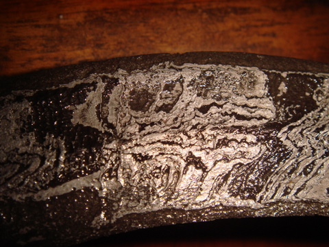

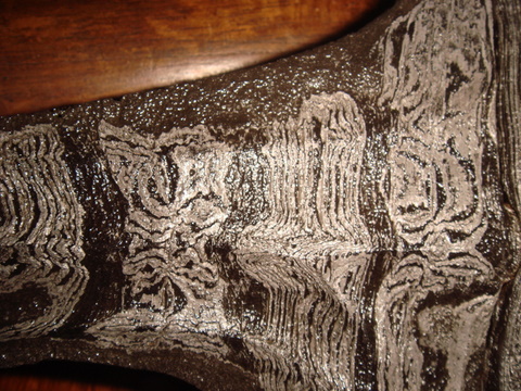

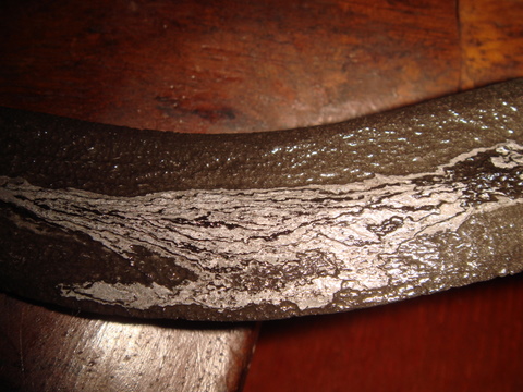

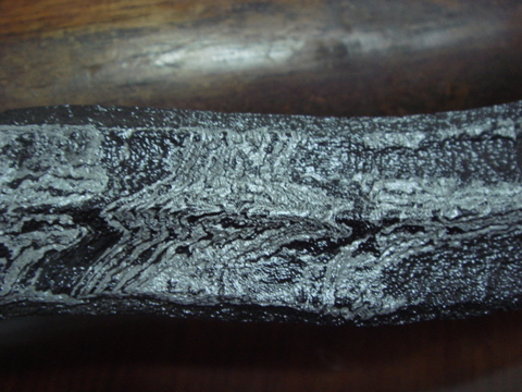

Some pictures of what I am talking about. The one that resembles kupu tarung / tumpuk is said to be tangguh Majapahit by the owner. Note that different lighting produces different color hue of the iron.

Would a full length photo of these blades be possible?
Yes, we do understand that different lighting can produce different effects in the image produced.

Unfortunately, no ... the owner sold the keris to someone else not long after I took the picture about 7 months ago. Back then I was such a neophyte that when I took pictures I only cared about the detail texture of the iron. I haven't learned the importance of dhapur and wangun yet ...
I will find some other photographs to illustrate what I meant. Meanwhile, without considering the overall dhapur (let's assume it's within the acceptable tangguh standards), is it possible for krisses from Majapahit or before to have different color tone of iron and slorok as seen from the picture?
Thanks for looking at the thread I'll be back with more images.

Neo, there is no need for you to find other photos to illustrate your point. I was interested in seeing the complete keris that was made of the material shown in your photo and that was claimed to be Majapahit.
Were I you, I would not concern myself much about not having obtained it.
Tangguh is an opinion.
It is an opinion of a classification that can be applied to a blade.
Keris that are classified as Majapahit normally do have a core (slorok)
Keris that are classified into the eras that fall prior to Majapahit also will usually have a core.
However some keris which truly date from the actual time period prior to Majapahit will most often not have a core, however, these keris will not be classified as Jenggolo or whatever, but as Buda.
There are at least two ways of accepting the tangguh system:- you can accept it as a classification system that uses the names of Javanese eras and historical periods as the names of those classifications, or you can accept that the classifications truly relate to the era or historical period. In the first instance you are subscribing to belief in a system of classification, in the second instance you are subscribing to an element that is part of a system of belief.
One acceptance is not more correct than the other, the relevance of the acceptance depends upon your state of mind.
