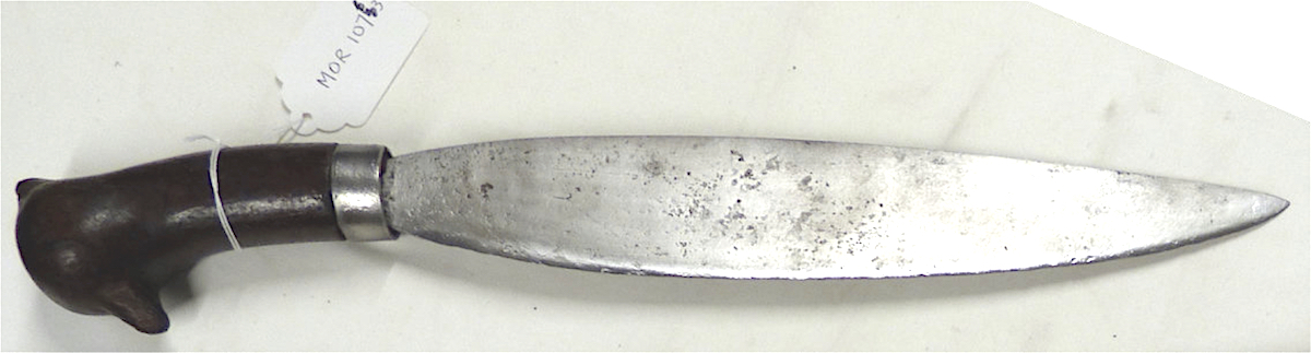

Here is one that I was able to find quickly. It's a small barung with a minimal kakatua pommel, plain wooden grip and small metal ferrule.

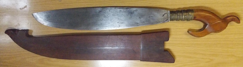

Another minimalist barong hilt:
20c minimalist hilt barung
Old 13th September 2020, 10:51 PM   #7
Posts: 4,736
Hi Wayne,
I missed your barung when you first posted it. The blade is "forward-weighted" compared with Sulu barung and the profile resembles some of those made in Zamboanga. The hilt is Maranao.
