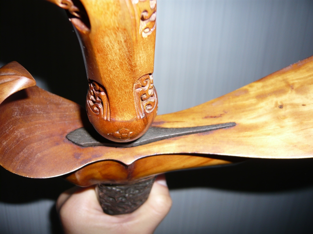

Kai Wee, would it be possible for us to see the top of the gonjo?
The wadidang seems to have a series of notches cut into it. It looks peculiar. Can you see what has happened there?

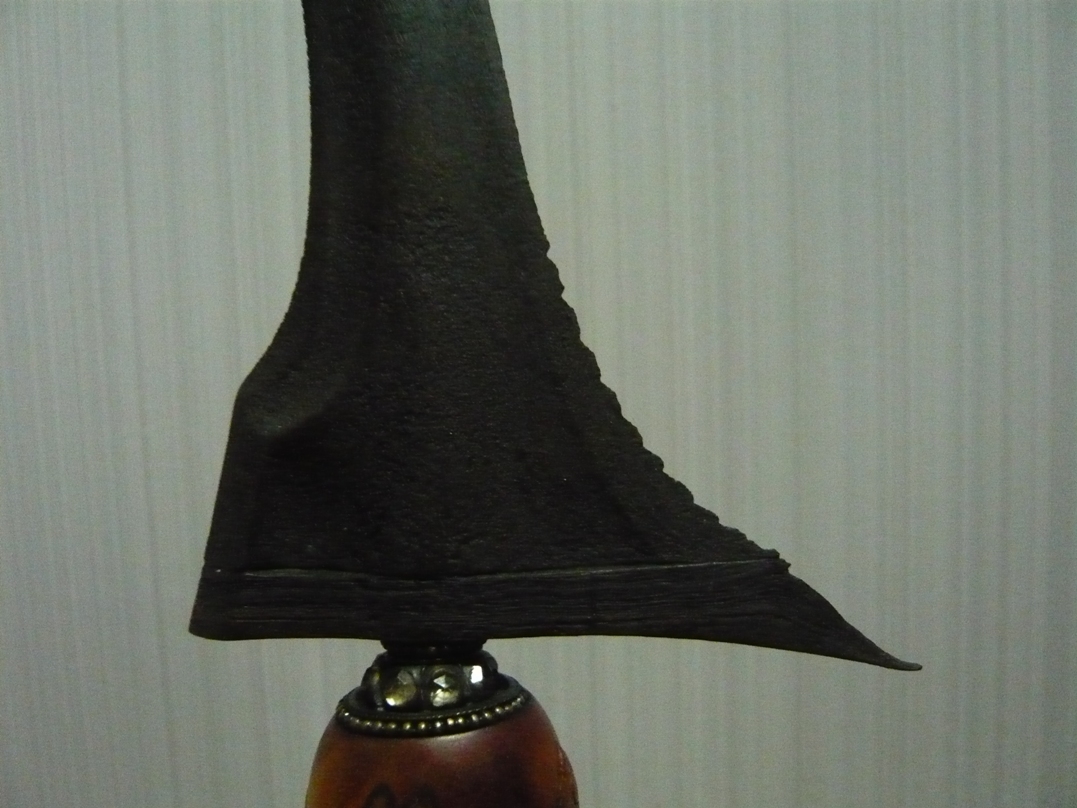

Is the gandik as steeply angled as it appears to be in the photos?

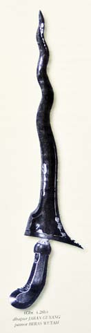

Yes, steep angle ("mboto rubuh") at the gandhik -- and even steeper and visually a little bit shorter (proportion) than usual javanese gandhik, is questionable. Just for comparison, the illustration of dhapur Jaran Guyang (from Mr Haryono Guritno's Keris Jawa book)....

Pak Ganja, my query was addressed to Kai Wee:- only he can confirm if that gandik is as steeply angled as it appears to be, because only he has access to the physical keris.
I disagree that it is
"---visually a little bit shorter (proportion) than usual javanese gandhik---"
in my opinion it is completely within the parameters for length for a gandik in a Javanese keris, always dependent upon blumbangan form and the level of skill of the maker.
Are you applying the term "mboto rubuh" to the gandik????
I can understand the logic, but it seems a rather unusual usage. Has this usage now become general in some circles?
I don't believe I've ever heard it applied to gandik, only to blumbangan, wherein we have a mboto rubuh in , say, a Pengging keris, and mboto adeg in a Majapahit keris.

The series of notches are indeed peculiar. They are just notches cut into the wadidang. It's a bit difficult to take pictures from this angle, but the wadidang does not have any unusual thickness or anything.
The gandik's angle is indeed as steep as shown in the picture.

A gandhik this steeply angled would normally cause us to think Madura, but based upon what I can see in the pics, I'm not prepared to say that it is Madura. Its a peculiar keris in a number of ways, and although my initial impression was that it was not an altered keris, I am now in two minds. It is not a high quality keris, so we cannot really apply strict standards to it:- a lot of quite decent keris were made in areas away from direct center-of-power influence, and by competent people who were not necessarily empus, or even pandai keris. These keris are often a mixture of styles, and this makes a classification difficult, perhaps logically impossible.
I don't think I'm inclined to give a dhapur for this keris.
In fact, it is often better to describe a keris in terms of its ricikan, rather than try to force it into the strict parameters of a dhapur.

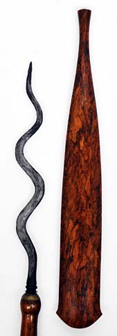

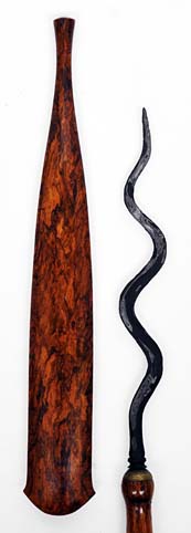

Similar reason did happen to me to buy this peculiar tombak (the picture below is just for comparison, I don't mean to alter this topic to other weapon than keris. Pls David, Rick, I apologize for it...) -- I was caught to the way the empu or tombak maker, whatever, executed the luks. As if straight tombak, then luks, and ends with almost straight tip...
Sarpa nyander? Or sarpa lumaku kind of luks? Whatever... Difficult to express in words.
