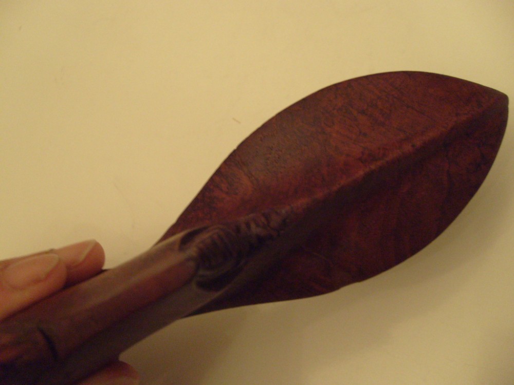

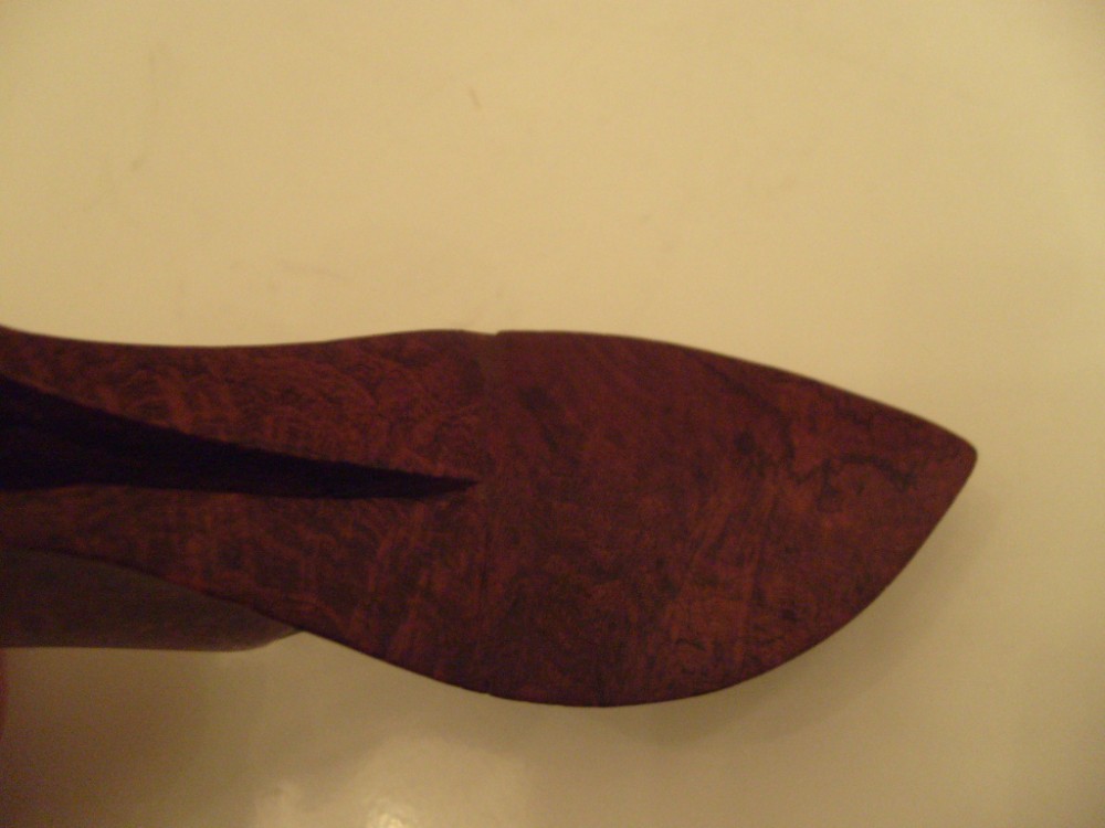

My Son has a favorite keris but the wranka is brokken , i would like to repair it . Maybe some one has a good tip to make the crack less visseble.
Can someone help me also with the wood , what is the name ?
is this a old mendhak?
The hilt is realy stuck, i did try to loose it with heating but it won,t gett loose?
Danny

Hi Danny,
This looks do-able .
You wouldn't have the missing piece would you ?
If you don't perhaps you can mix some sort of filler paste to the right colors .
Make sure you use a glue that is as dark as the wood .
The rest is care and patience .

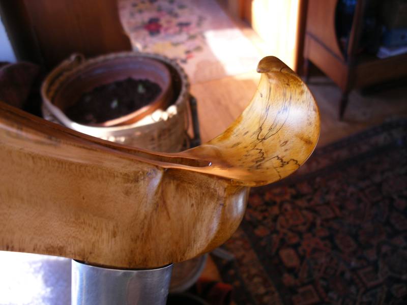

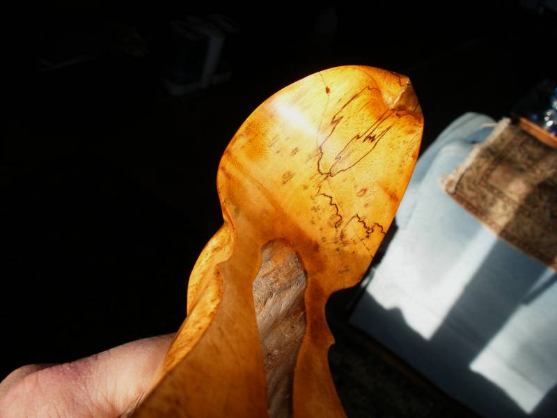

Here's a repair I made after a stupid mistake .
Fortunately I had most of the pieces .
My glue was a bit dark ..

I have done exactly this repair, and others that have been of a similar nature.I used 5 minute Araldite mixed with burnt umber powder where I had to hold the pieces in place. Where I did not have to hold the pieces in place I used Super Strength Araldite with burnt umber powder.
This wrongko has already been glued together, to get it apart I suggest wrapping the glued section in damp cloths until the existing glue joint will separate, then meticulously clean out all the old glue from the joint and wait until the wood is completely dry before remating the break and glueing it. Overfill the joint with glue and clean off and repolish when everything has been repaired.
The gap in the edge can be filled with plastic putty or body filler tinted with burnt umber. You might consider reshaping the wrongko leaf a bit to reduce the size of the gap you need to fill.
The wood appears to be jati gembol (burl teak).
I have never yet found a hilt of a keris or pedang that will not let go with the application of heat. The safest heat source for somebody who has not done this before is a candle, or a small kerosene lamp. You simply heat the blade on both sides alternatively, in the area of the sorsoran, and as it gets hot you work the handle back and forth, while you grip the blade with a cloth. If it has not let go after say, thirty minutes of heating, put it aside, leave it a day or so, and repeat the process until it does let go. Even a really badly rusted in hilt will let go after three or four heat treatments. The danger is if the tang is completely rusted through, it will break when it finally lets go of the hilt. This is no big deal and any broken tang can be repaired.
Yes, the mendhak is old.

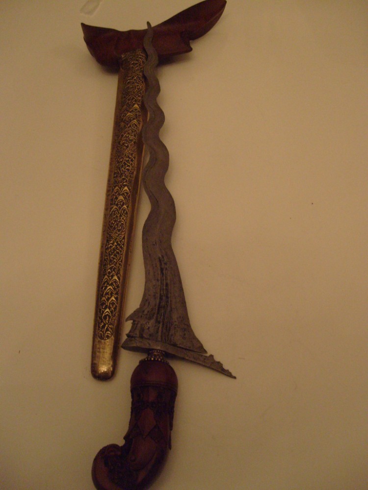

Default result
After al the tips i did get and by searching the forum is the the result.
It,s not a prof restore , but for a first try i.m not unsatisfied.
and i realy did enjoy to work on this keris

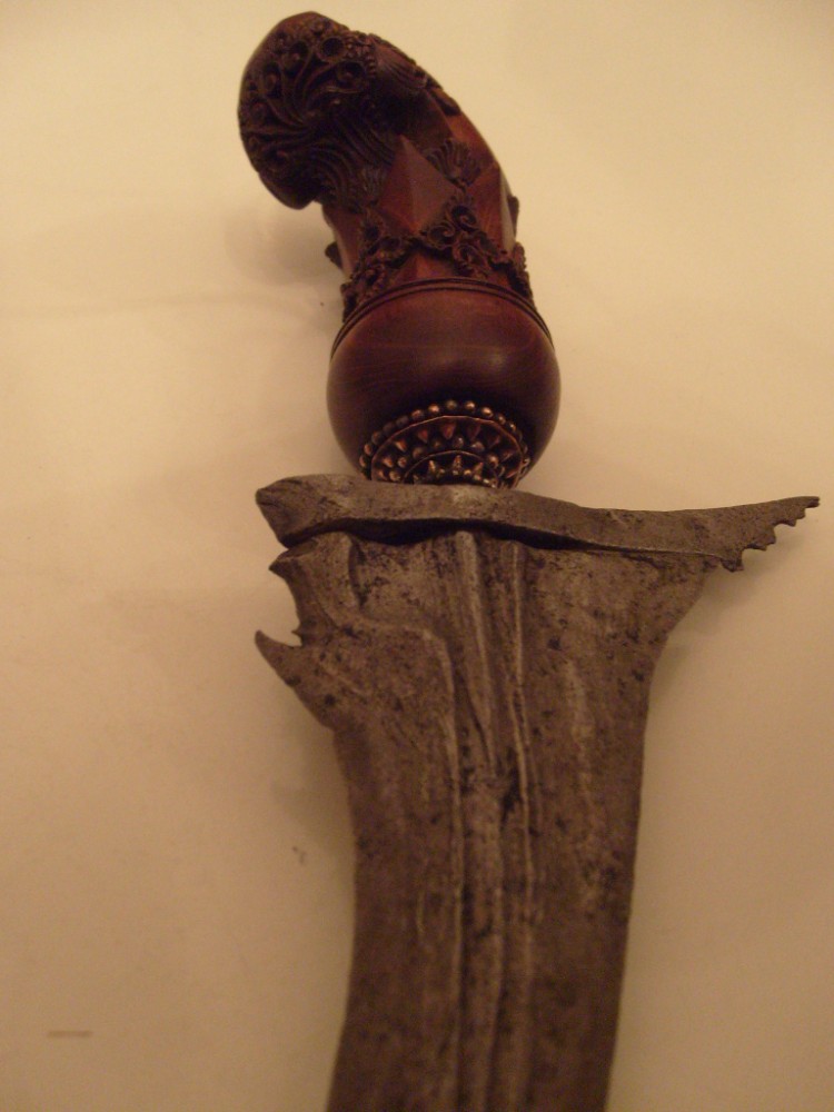

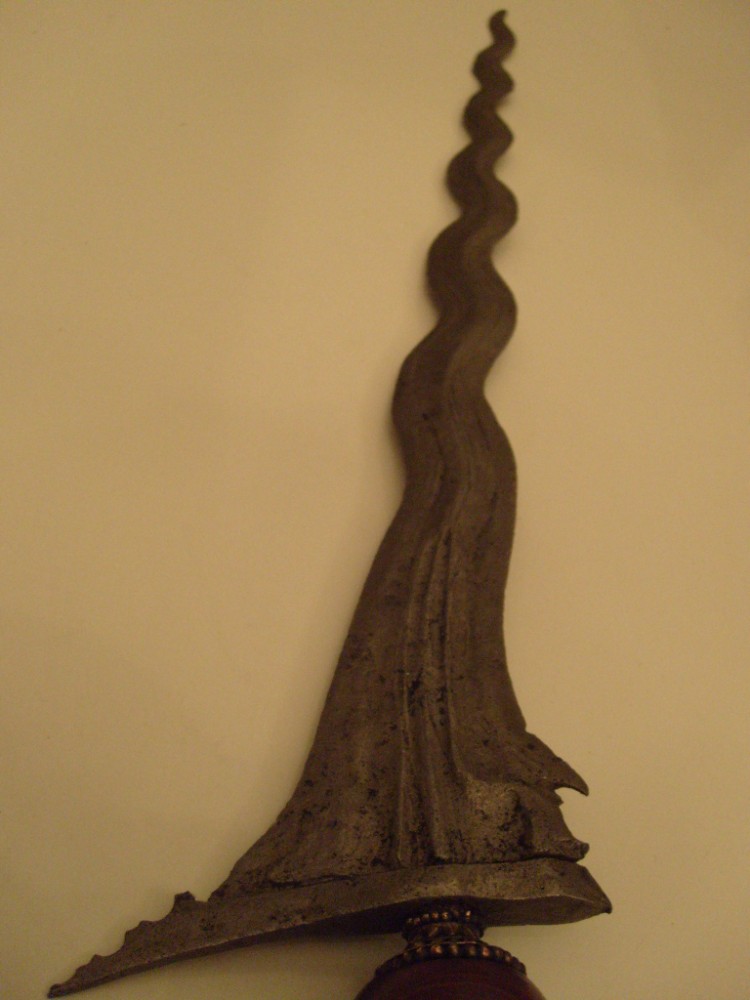

I also cleaned the blade a little .
its a 13 luk. but i need some help with the dapur and the age.and is it a mudura blade or javanese?
danny1976 is offline   Reply With Quote
Old 6th February 2010, 12:50 AM   #10
Posts: 7,255
That's a pretty good result Danny. Nice work.
From the pics I cannot say with any certainty what this blade might be. Sorry.
A. G. Maisey is online now   Reply With Quote
