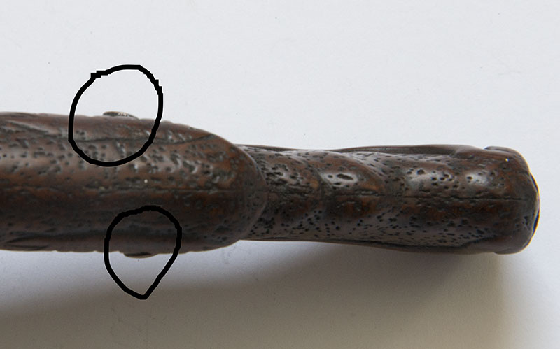

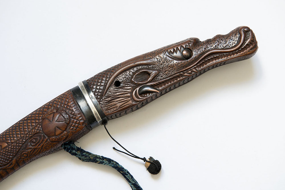

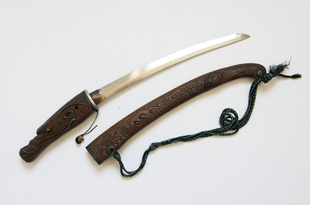

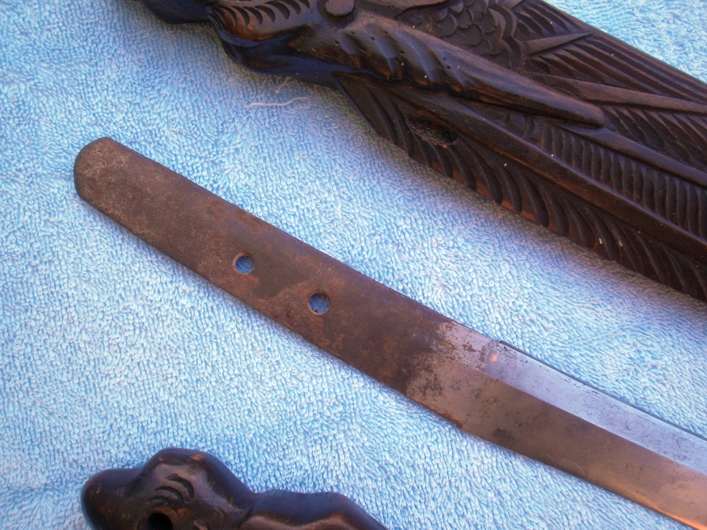

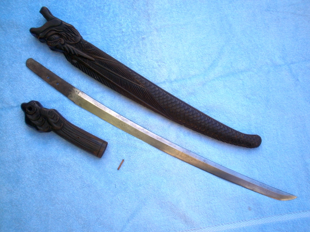

On the dark and unsharp seller's photos the sword looked Aynu style, but looking closer and after cleaning it is pretty well made and most probably antique Japanese dagger, maybe Aynu inspired, for European market.
The blade was heavily rusted and has many small nicks from use; it has no visible hamon and hada. I wasn't able to remove it from the hilt, although there is an opening and no Mekugi. Maybe it is glued in or heavily rusted inside.
Any opinions on this one? Anyway, I love the cute dragon carving

I don't think (?) it is Ainu. Most likely a post WWII mount with possibly a good, older blade (can't tell from the pics). Fancy carved mounts were commonly used as gifts or souvenirs for GI's or tourists.

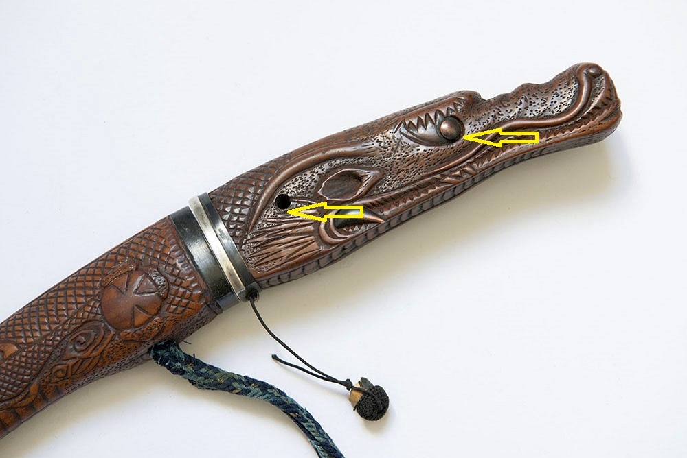

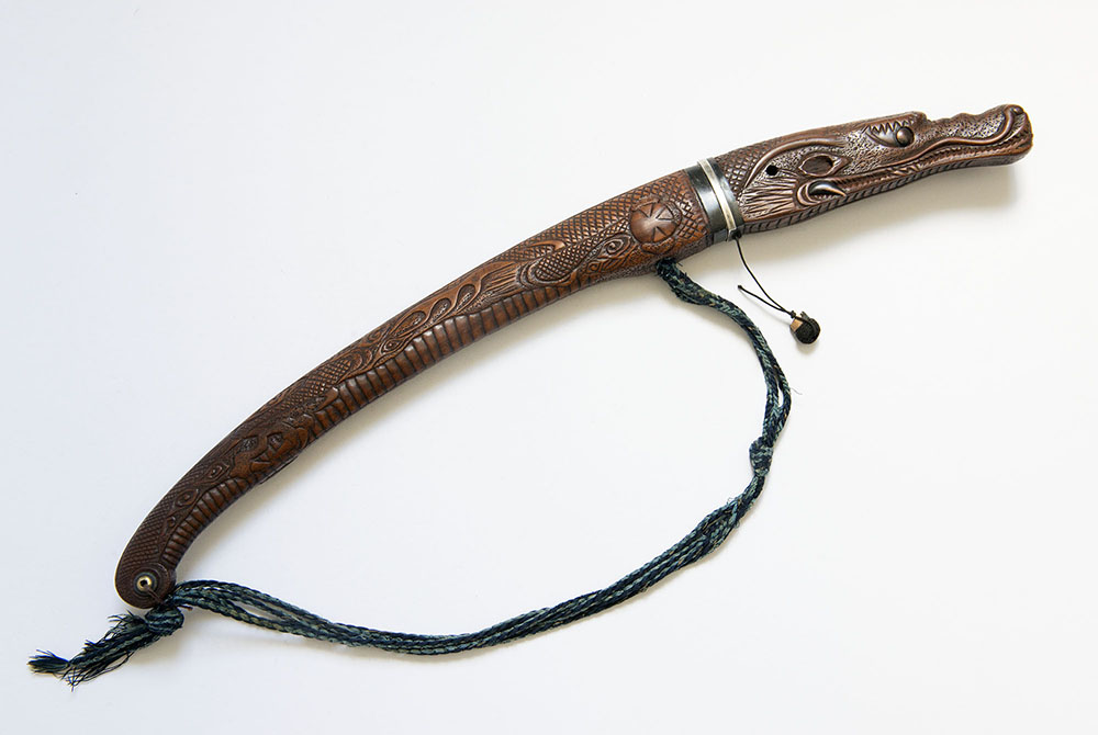

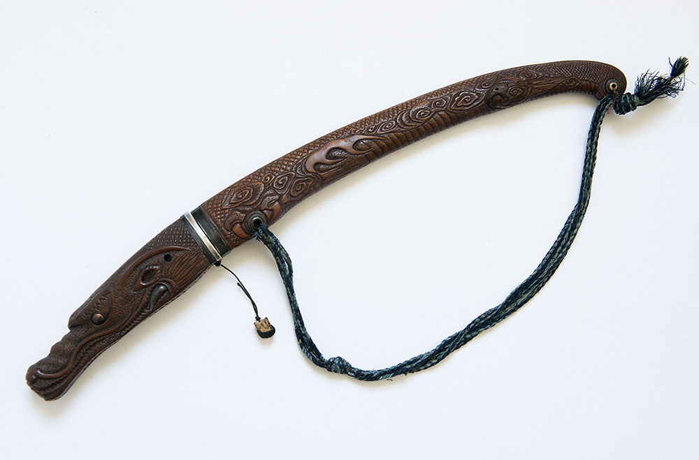

I have a friend that is quite conversant with Ainu weaponry. He's suggested that the eye of the dragon might actually be a second pinning spot, a screw rivet that is undone by holding the back of the rivet with a tool and turning the other eyeball to undo it as most Ainu swords have two holes for them as per the below photo.
He's also commented that this style sword was NOT for the tourist market as suggested, and is a definite Ainu item, but is as used and carried by the Ainu. This is a traditional ceremonial dress for an Ainu sword, and in many early photographs of the Ainu warriors dressed in traditional dress you may see these swords or knives tucked into the belt sash of the kimono, they are not the mounts of a sword that would have been used in battle which have a guard and similar fittings to the usual Japanese katana but different in that they are flatter and smaller.

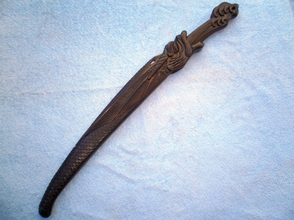

more photos of a similar ainu weapon also attached.

I will try to gently remove the eyes of the dragon, and I will share the tang photo if succeeded.

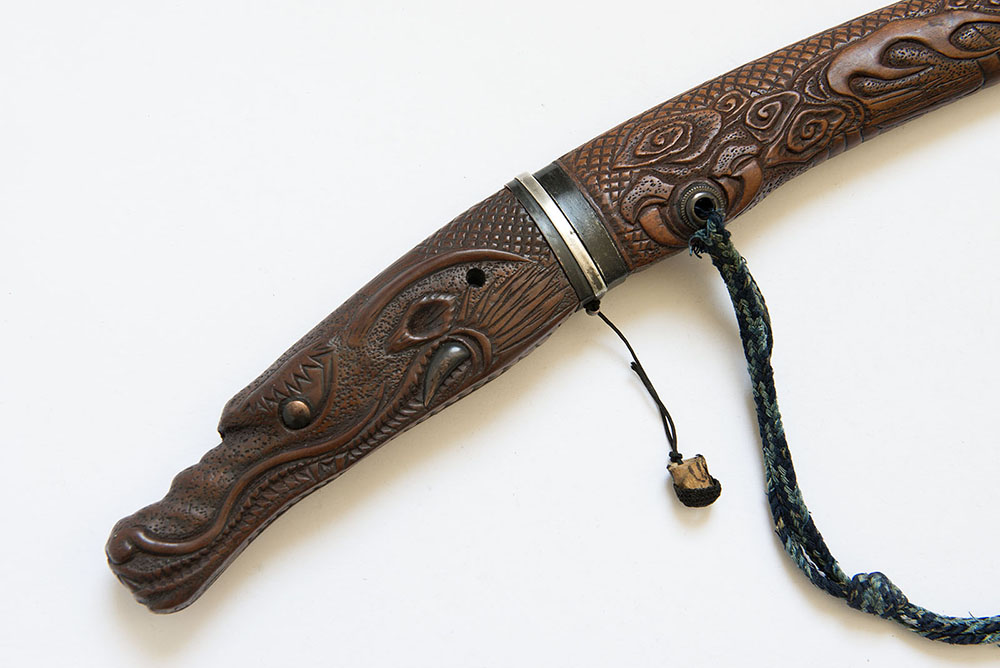

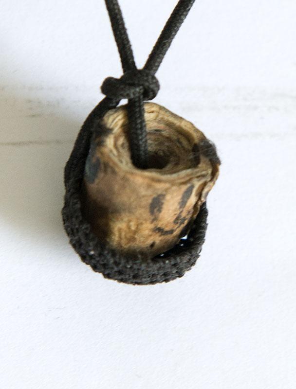

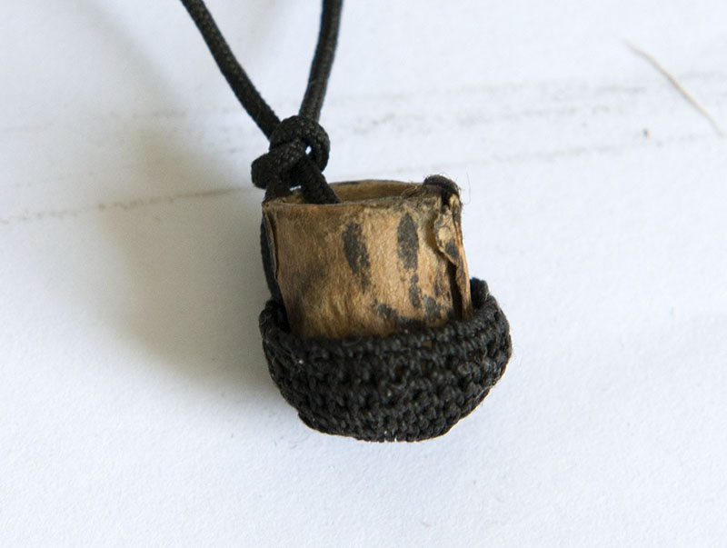

What is that little piece hanging from the hilt on a string?
Old 18th June 2017, 08:32 PM   #11
Tatyana Dianova
Posts: 785
Thank you for your insights Peter - it really explains the mystery!
I do not think that the eyes are rivets - they lay offset, and the angle doesn't match either. I do not want make any damage.
The small thing is a roll of paper with some signs on it. The roll is glued, I wasn't able to unroll it. It is included in a knotted half-sphere.

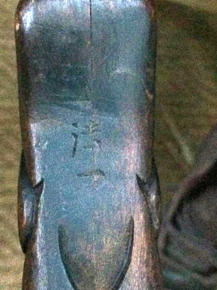

the tangs on these are normally unsigned, oddly, the one i posted earlier WAS signed -not on the tang, but on the underside of the grip. you can just make it out below:
Old 19th June 2017, 01:50 AM   #14
pbleed
Join Date: Jun 2005
Location: Little Rock, Arkansas
Posts: 89
This looks to me like the signature of the man who carved the fittings. It is probably in NO WAY a reference to whoever made the blade. If I had to - I'd read this signature a either "Hoichi" or "Norikazu". If reseach were to turn up anything on this person I bet it would say ""Late Edo wood carver". This might also support my suggestion that this is a Japanese production - possibly for the Ainu trade, and NOT made by an Ainu.

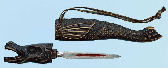

The origin of this 'yarifish' was never resolved when it was presented on the old forums in 2000. The tang of a Japanese spear has been broken off and only friction is holding the blade in place. Not the standard of work of the dagger in the present discussion, but could this be the poor man's version of the same?
