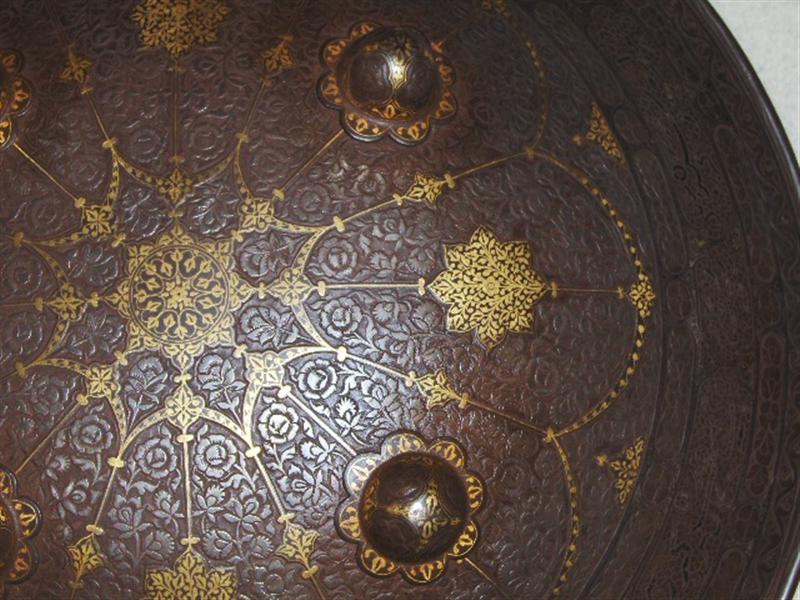

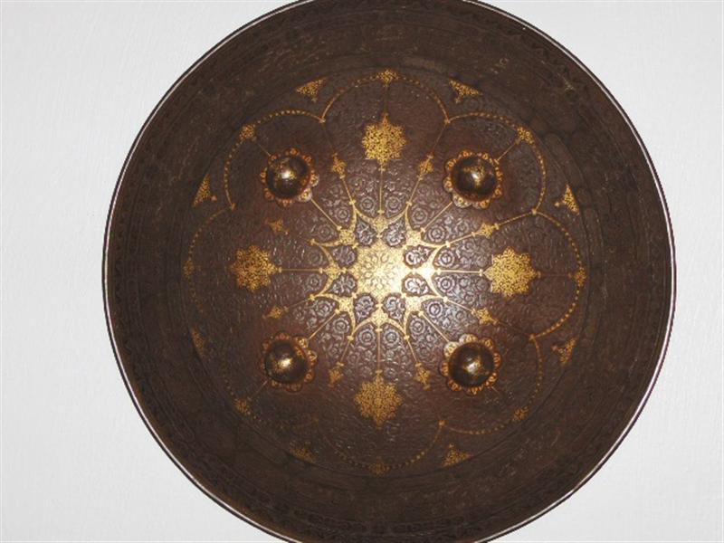

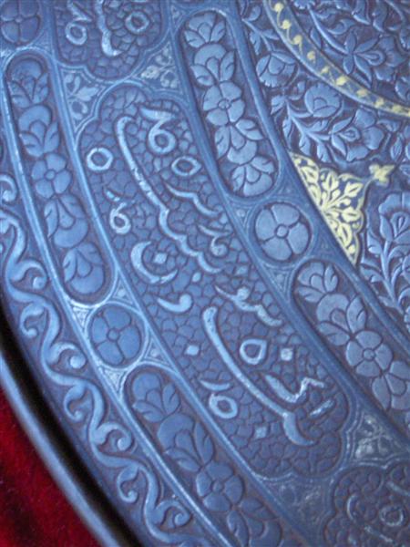

Attached photo's are of a parade shield with a rolled rim. You see this type of shield with a brass edge that is riveted on and also with the rolled steel rim. In my minds eye the rolled steel rim the mark of a slightly better made armour.
This shield also has a chiseled floral decoration and is further embelished with gold and silver koftgari, also has silver sheet overlay on the calligraphy only.

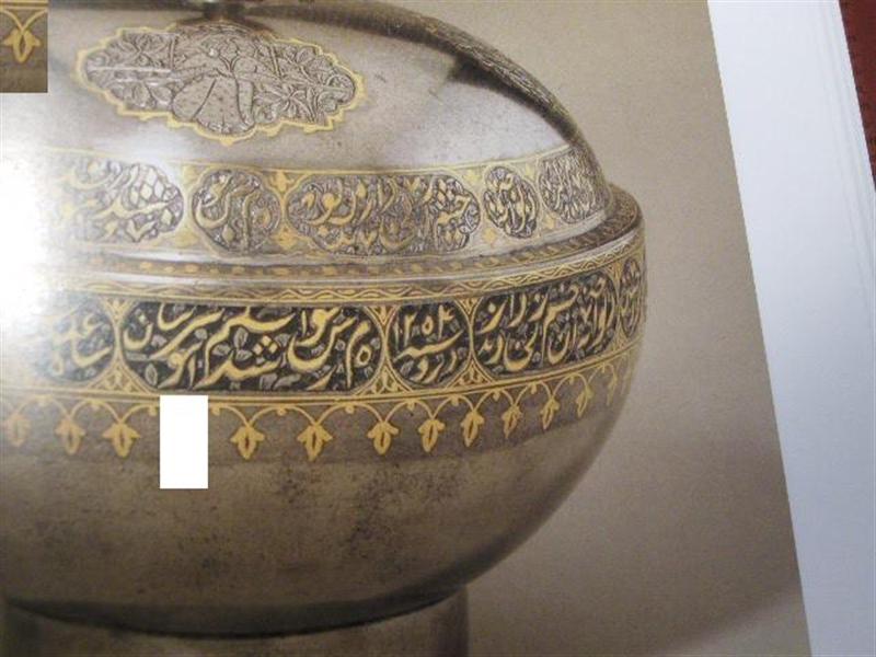

Default Moser Collection Persian Bowl dated 1838
Here is a Persian bowl in the Moser Collection that is dated 1838

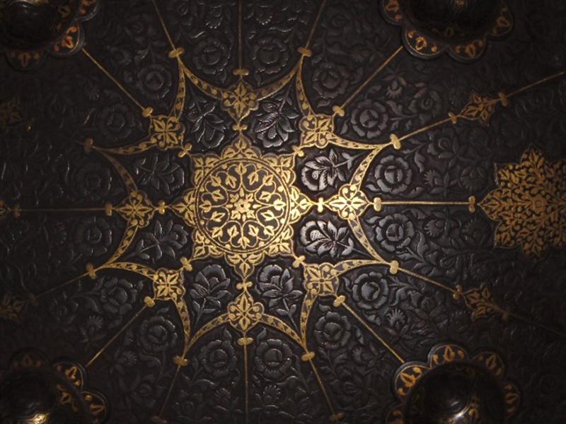

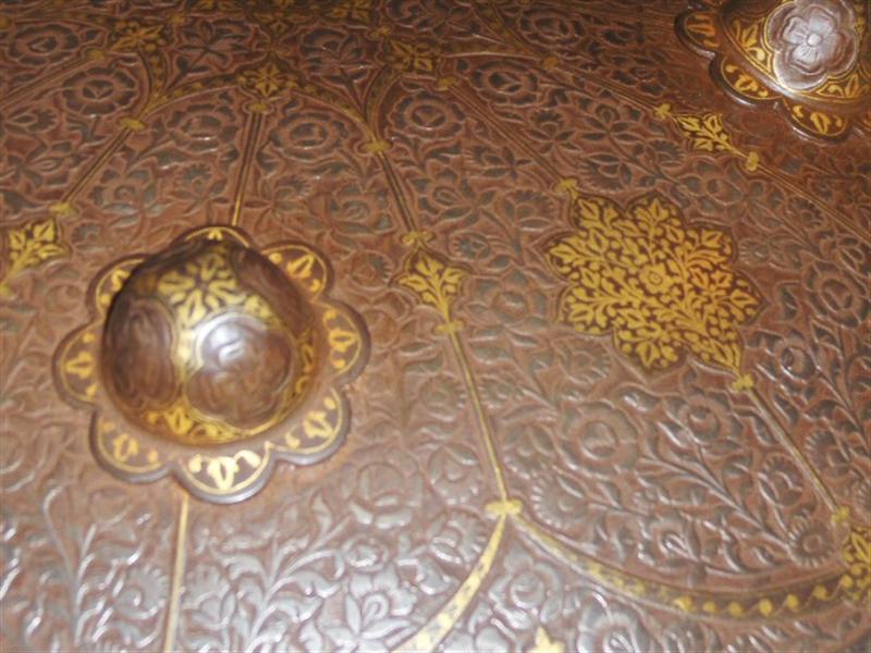

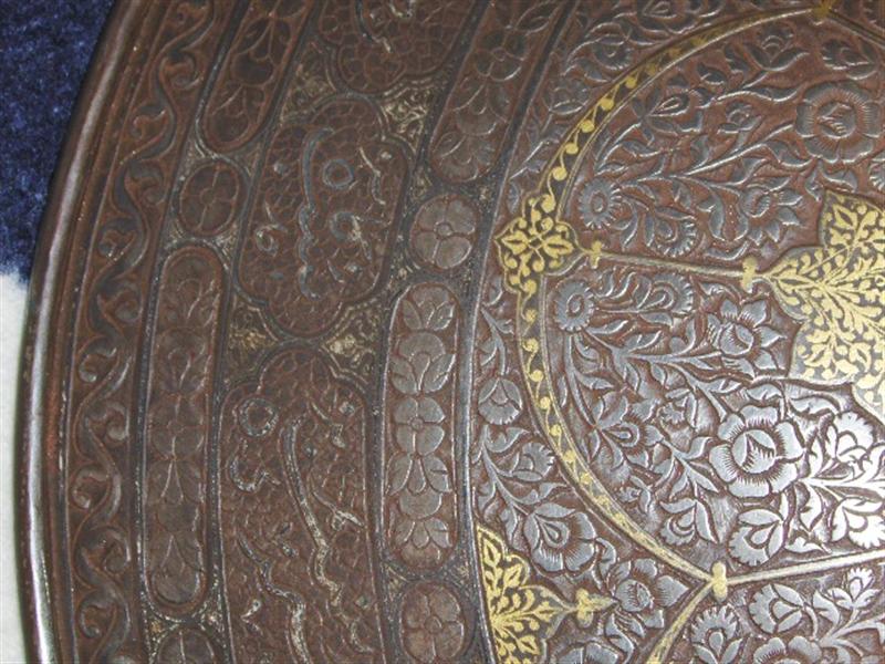

Default Section from shield with similar design
Here is a Section from the shield with similar design element.

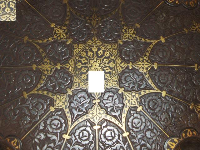

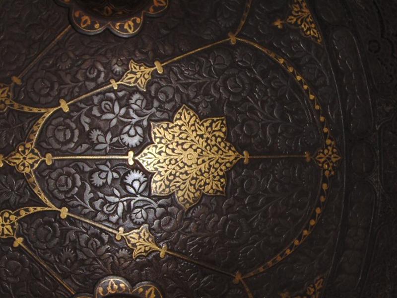

Default Comparison
From a comparison of the oval shape left in the floral design from the absence of being completely filled in with gold overlay, seems these two examples of metalwork are from the same time period and area.
To me this is compelling evidence that this is a Persian shield dating to the second quarter this the 19th century during the reign of Faht Ali Shah.

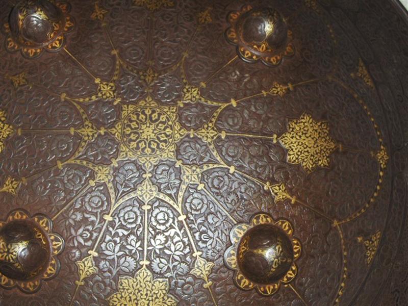

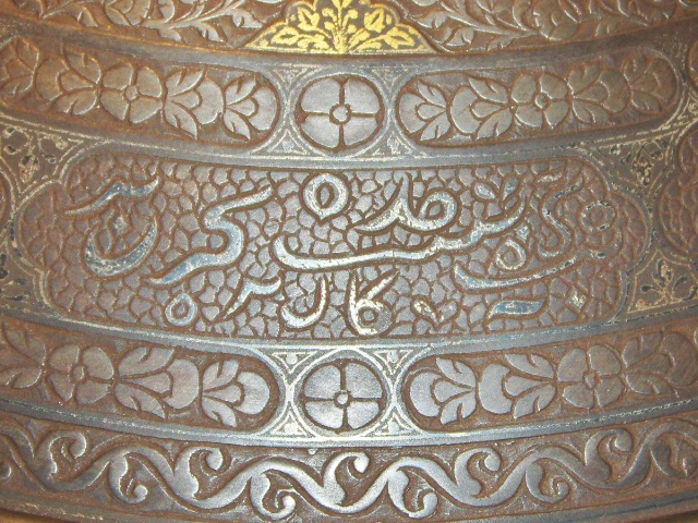

Default Scale-like decoration around calligraphy
This photo show a section of the calligraphy on the perimeter of this shield. What interests me is the unusual fish scale like incised decoration around the writing inside the cartouche.

Hi Rand,
Sorry for the late response. It is always difficult to recognise flowers cut in steel, first it can have been difficult for the artist to show the flower in its correct form, and second we must consider the possibility of artistic freedom, which could change the look of the flower considerably. When you look at floral decoration, you should also take an interest in the leaves, as they would have been easier to make, and therefore more like in nature, and I don’t think the artist would use a lot of his ‘freedom’ to change the leaves – but one can never know. There are at least three different flowers on your shield, and one could be a rose, but I am not quite sure.
The scales around the inscription are strange, and have, maybe, only been made for decorative reasons. In some places in India the fish is holy, and there they could have used a scaled decoration, but I don’t know if it was holy anywhere in Persia.
Jens
Old 1st April 2009, 03:22 PM   #12
Posts: 6,436
Then we must also wonder if the scales represented might be reptilian .
Old 1st April 2009, 04:51 PM   #13
Posts: 10,862
It sure is good to have you back Rick!!!
Reptilian? ahah! very astute Nagan associations perhaps? Excellent thought. I was thinking about the fish as Jens had described as I was pondering the great detail he was referring to with the floral motif, and hadn't thought of the snake.
While the fish is indeed important in varying degree in many Indian cultures, I'm not aware of the Persian application, but I feel relatively certain the snake has important symbolism in Persia as well.
Whatever the case, it provides a most attractive field in the motif, and I'm glad Rand posted it here!

Hey Rick,
Am very open to all opinions as it is my strong belief that any theor has to be proven over the scrutiny of time. Do you know of any fish scale examples used in Persian or Indian art?
These scale designs when used inside the calligraphy cartouche may become one of the characteristics associating it with the 19th century in Islamic metalwork. Its was just very surprising and exiting to see it for the first time.
