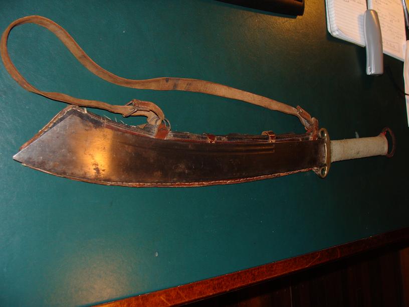

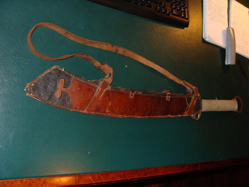

Below are some images of the an early 20th century Da Dao(1930-40ish) used by Chinese Nationalist troops that I have in my office, it is like comparing ducks and emus but I beleive(only an opinion) they should all follow similar curves/form. There is also a photo of these troops lined in a bunker at the ready.
Gav
