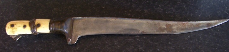

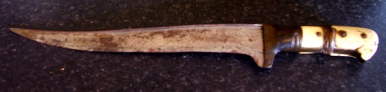

Default A Khyber 'type' knife with Ivory (?) handle.

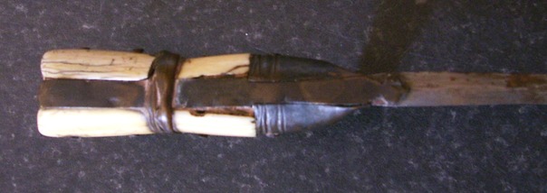

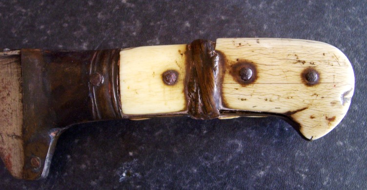

An old, just acquired knife. Usual 'T' spine with a nice downward curved blade , 10.5" long (following curve). A nice chunky handle showing a lovely used patina, handle has a very old repair, the slabs have acquired a nice polished finish from handling....does not look like bone ...I am almost certain some sort of ivory.....any ideas how I can ID it (its not elephant )
I am always wary of the stories behind weapons, but this is stated as being a Victorian 'bring back' from the North-West Frontier,. I have no problem with the dating ....mid 19th C seems highly likely.
I really like these....comments and info would be great Thank you
Regards David

I try and avoid Ivory if I can and so am no expert, does the grain separation indicate its likely to be a Walrus tusk rather than Elephant?

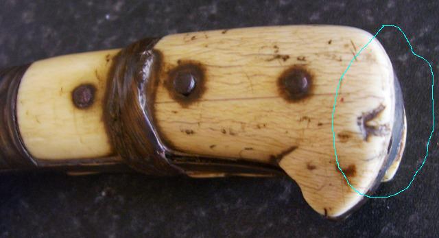

There is a chance to be elephant ivory.
Possibly this piece was cutted horizontial from the elephant tooth so we see the black lines (possibly Retzius lines)across the handle.
It will be very hepful if you can show a close picture from the back side of the handle.
All the best

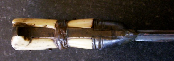

David,
I'm intrigued by the 'waisting' on the handle. What is the central band?
Is the material split between the two sides of the band (in other words 4 pieces of ivory)
Best

Old 11th March 2009, 11:27 PM   #6
Norman McCormick
Norman McCormick's Avatar
Posts: 1,656
Hi David,
I was thinking the same as Gene, the band round the hilt looks as if it's been there for a long time but not something I've seen before. Do you think it's a 'field repair' or an integral part of the construction. To my mind a nice 'well used' piece.

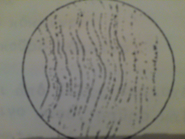

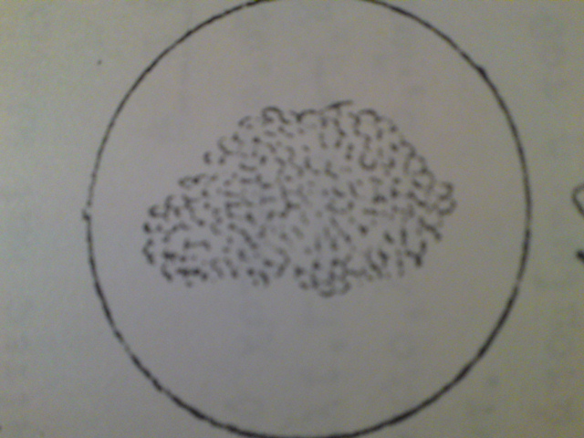

Some informations that I believe may help you.
ELEPHANT IVORY:cross sections of elephant tusks display a distinctive pattern of intersecting curved lines,resembling the patterns producedby "engine turning".Longintual sections show a pattern of wavy , sub-parallel stripes
WALRUS:It has an oval cross section with an outer coating of cementum and a large pulp cavity in the centre which runs throughout its length.This central cavity consists of coarse bubbly or nodular material.
BONE:Resembles ivory closely in appearence but is distinguished by its structure.Bone contains many small tubes which are seen as dots in cross section or as lines in longitudinal sections.They are most clearly seen where filled with dirt.
VEGETABLE IVORYerives from the nuts of certain palm trees(Coroso nut) from South America and (Hyphaene Thebaica) South Africa.Cross sections show a pattern of faint concentric lines,longitual sections show a pattern of parallel lines.Since the pulm nuts are small in size aprox 2cm to 3cm objects are generaly small.
I hope not to confuse you too much.Try the next pics .
1.Cross section elephant ivory
2.Longintual section elephant ivory
3.Vegetable ivory
4.Walrus cross section
5.Walrus cross section
ilias is offline   Reply With Quote
Old 11th March 2009, 11:49 PM   #8
katana
katana's Avatar
Location: Kent
Posts: 2,658
Originally Posted by Atlantia
David,
Best
Gene
Hi Gene,
the banding seems to be sinew, as a best guess, which is now very hard and 'secure'. The strange thing is that originally it looks like it had two slabs one either side. Some how the slabs were damaged / cracked between the 1st rivet and 2nd rivet (both sides) It seems to be a 'in the field' repair, to hold the slabs together, presumably until a better aethestic repair could be done.
I have visions of a Afghani mountain tribesman sat at the campfire, drawing the sinew from the leg of a freshly killed goat. wetting it and wrapping the handle of his recently damaged Pesh, in defiant concentration. Placing it near to the warmth of the crackling flames, so that the drying sinew would tighten and hold the ivory slabs. Contemplating the attack on the British Garrison when the sun rises over the mountainous peaks the following day..... little knowing that the star filled blackness of the night would be his last......
well some thing like that.....
Regards David

Hi David,
My Regards,
Norman.
Hi Norman,
yes, I believe a 'field repair', it does improve grip as well. Thanks, I really like weapons that are in the 'well used' category.
Regards David
Old 12th March 2009, 12:20 AM   #10
katana
katana's Avatar
Location: Kent
Posts: 2,658
Hi Ilias,
thank you for the information on Ivory I am fairly certain that this is Walrus Ivory. Looking from the pommel end you an see two layers, the outer is the harder layer visible from the sides and then there is an inner layer which is more of a creamy yellow and appears softer. These two layers follow the 'curve' of the slabs suggesting they are cut sections of the Walrus tusk.
Kind regards David
Old 12th March 2009, 02:19 AM   #11
Posts: 6,418
I feel the same about these scales ; W.I. was used in both ways .
This seems to be an example of the dentine facing out .
