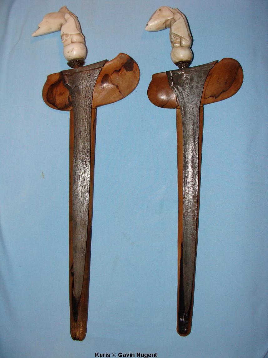

I have another two keris added to my growing modest collection today.
Both appear to be original and untouched, showing nice honest patina to the hilts, mendak, blades and scabbards. Both have Tridacna hilts with beautiful swirl patterns throughout and they feel so very comfortable and pleasing when both held and viewed, really a total feeling of comfort.
My question really is one of personal choice but I wish to hear words of wisdom from those more familiar with such choices. To touch or not to touch.
By touch I mean, change from this long standing static condition to a rejuvenated condition, oil the scabbards, clean the blades and polish the mendaks. One Mendak has been squashed but I think with care this will 'pop' right out.
Your direction is sought.

I am with Penangsang. A stain to the blades will maybe bring out a nice surprise too. The both rare Tridacna hilts seem to be from Sumatra/Peninsula while the blades and sheaths are from Java.

Great hilts. Now i realize that different people sometimes have different ideas when they say "original and untouched", but to my eye i see 2 Javanese (or possibly old Maduran) sheaths and blades with hilt styles from the Peninsula, so i have my doubts that these hilts originally belonged to these blades. In that sense these hilts look a bit out of place on these blades with their Javanese mendaks and sheaths.
That said i would clean the blades and maybe hit the hilts with some mineral oil and a soft toothbrush.

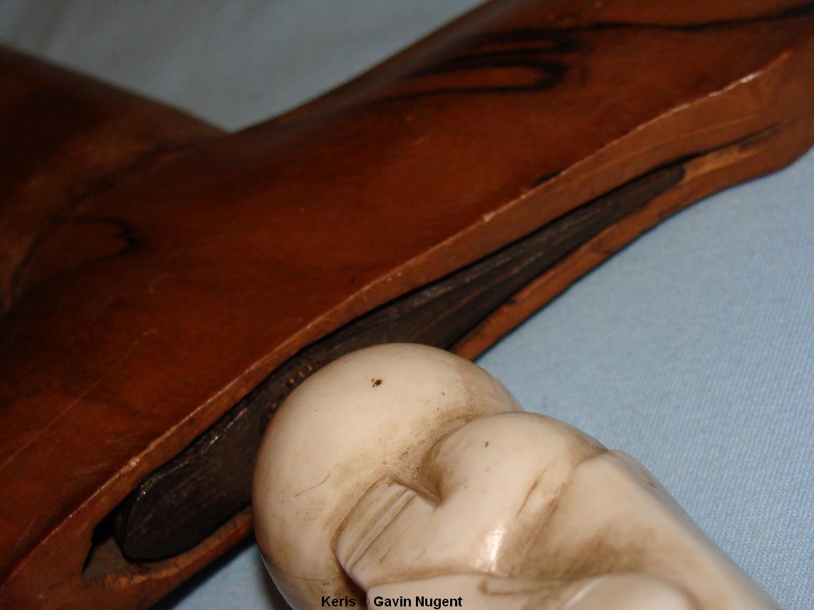

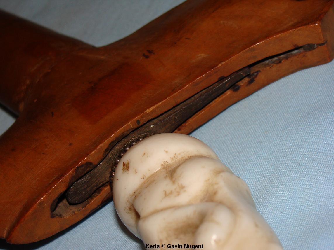

A picture from up to the sheath-mouth would be nice to see how the blades fit inside will show if the scabbard is worked for the blade.

The fitting as you will see in images below is not correct to me eye. One close but no prize to me.

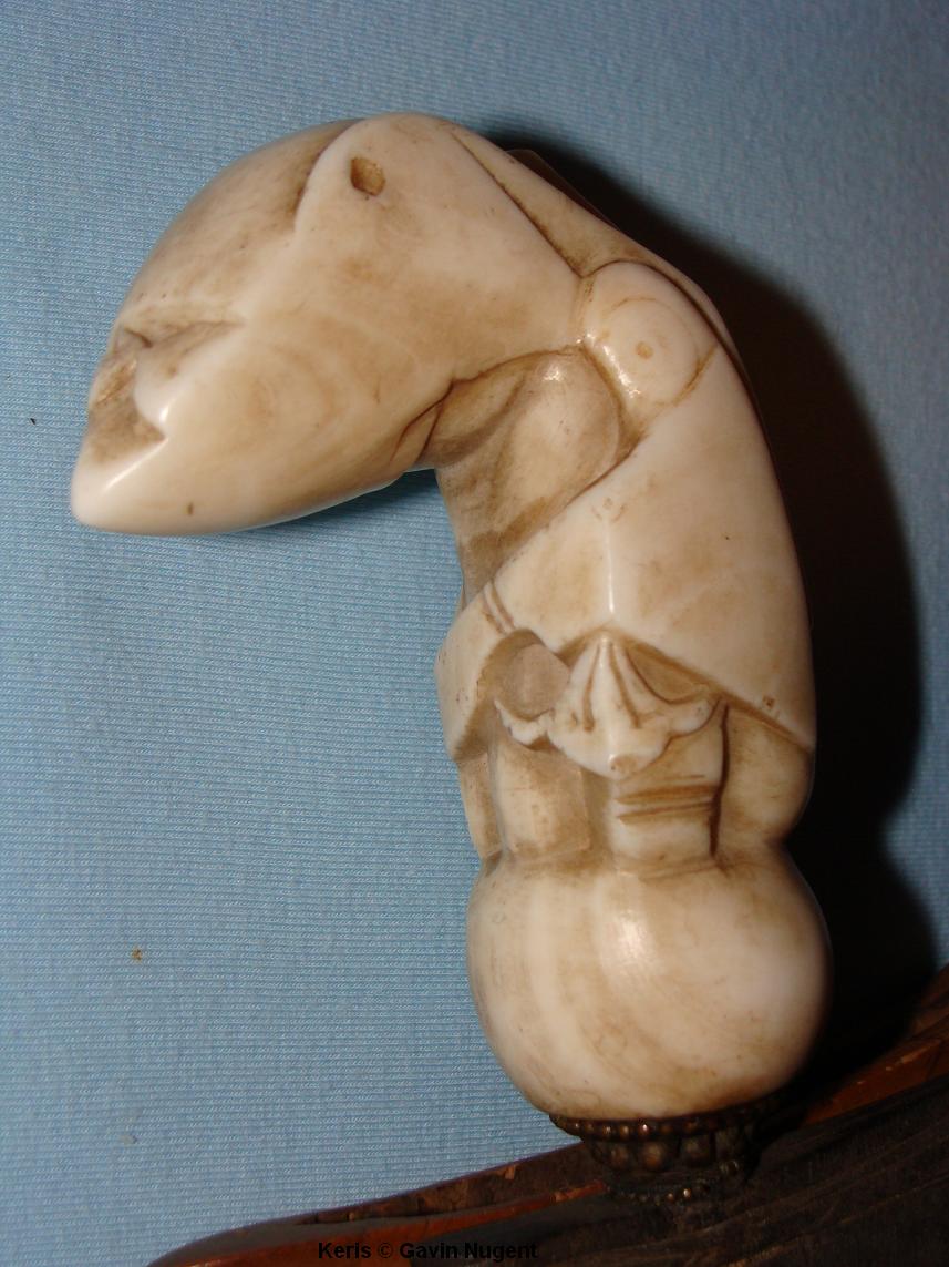

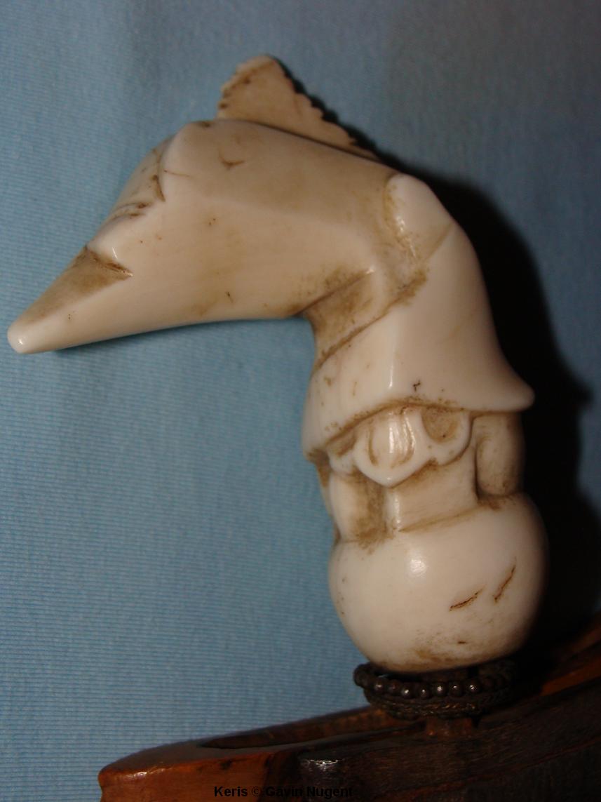

What I do find of interest is the base of the hilts. Where say the examples from the Kelling Hall collection I have, that I know have been together complete for near 100years (maybe a fair bit older too) and I would suspect based on this are original to the pieces from the period, these three are rounded to the base and sit in the cup of their Mendak. The two here have a 'flattened' base and sit by design on top of their Mendak...

The sheaths are indeed not worked for this blades. So hilts and blades are maybe longer married, but who knows.
The hilts are both just beautiful and they look Penninsula to my eyes but others will it know it better.
The mendaks are clearly javanese and don't fitting with this hilts.

The 2 hilts are beautiful. I reckon of Sumatran origin from the hilt form. The blades could be Sumatran as well.
Palembang or Pesisir sheath form (similar to the Banten sheath) should looks fitting for these 2 blades. A bugis or lotus cup form, should look appropriate for these ensemble. Again, if you feel bored with these, do let me know..

I do wonder about the fit in the wrongkos; either they are enlarged by use and are pretty old , or they were matched to corresponding sarongs; I do not know .
The fit of the one wilah in the sarong that you show must be very old if it is original to this keris as it sits so deep .
