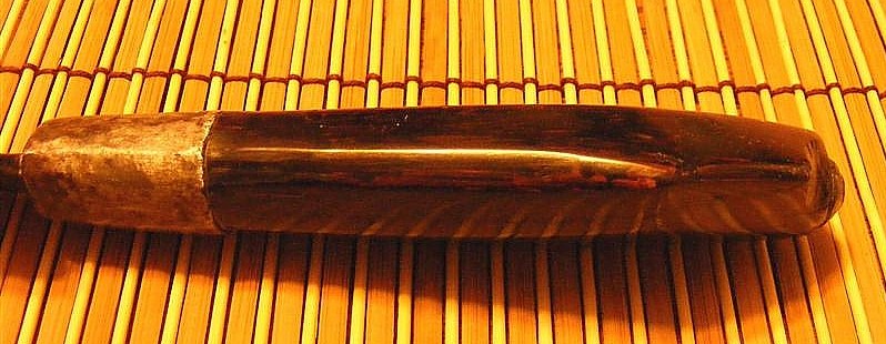

Here is a bolo I recently received. I knew exactly what kind of shape it was in before I bought it because of the detailed pictures the seller provided. The horn hilt has an extreme amount of worm damage. I really hate it when I see things like this bolo that were completely neglected and left to rot with no attempt being made to preserve them at all. To keep from having to grind off the end of the tang to remove the grip and then carve a new one out of horn I opted to replace the damaged areas with epoxy putty. This way I could also retain what is left of the original grip and stabilize it at the same time. The pictures show what it looked like when first received and what it looks like now. At this point it is only roughed in and not yet smooth enough to be stained to match the original horn. I will post more pictures when I am finished with it. My question to all is, what would you have done if this was yours?

Old 26th February 2009, 02:10 AM   #2
Hello Robert,
I think that is the best you can do with a damaged handle like this. Well done! Think the end result will be nice.

Nice job, I think since its so extensive, I might have drawn even more attention to it, using epoxy mixed with some colored pigments or metal flakes or something snazzy like that.
Nice handle shape on that one, looks really comfy.

You can buy epoxy colorants at Texas Knifemakers Supply www.texasknife.com .
Some folks have also used a bit of model paint in their epoxy. When I'm patching horn, I use just a little black, and the tiniest bit of red. With clear epoxy, a slightly translucent mix works fairly well.

Sajen and G. McCormack, Thank you both for your comments on what I have done so far. I think after staining the epoxy will look fine and match in with the horn pretty well. At least I hope it will !!
Steve, Thank you for the link to the supplies and for the tips on how to do the repairs. Again, thank you all for your interest.

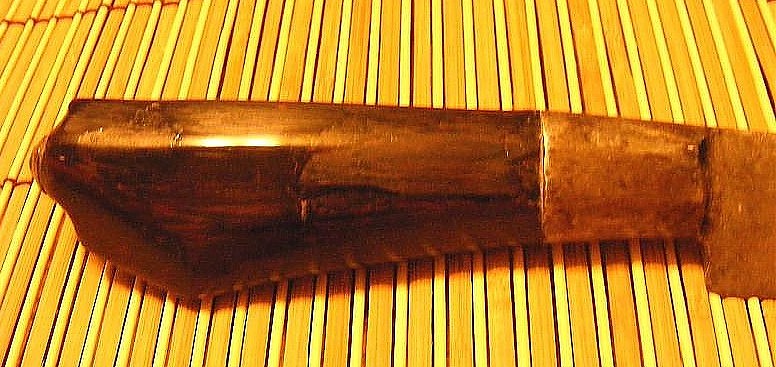

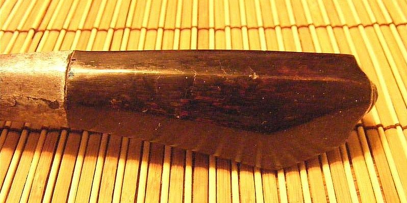

Louis-Pierre, Great work on the hilt restoration!! The results for the one that I'm working on are below. Sorry about the picture quality but I had to take them inside because it's dark outside here. Could use a little more work in a couple of areas but I will probably leave it as is.
Robert

Perfect, Robert and a nice job too.
What is to keep in mind is that is better to try to save a damaged hilt with restoration than to replace it systematically....when it's possible of course.
Louis-Pierre

Louis-Pierre, Thank you for your kind words. Saving the damaged grip was exactly what I had in mind when I started this restoration. I wanted to save what was left of the original horn and try to stabilize it in the process. I tried to leave in some of the imperfections so it would not look brand new and it would match up better with with the blade. A new grip might look better, but to me it would look out of place once it was mounted to the old blade. Because of the bonding strength of the epoxy I also believe it could now be used as intended "if needed" without worrying about the blade coming loose from the grip. I hope that I never need to find out if I'm right about this or not.
