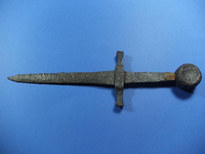

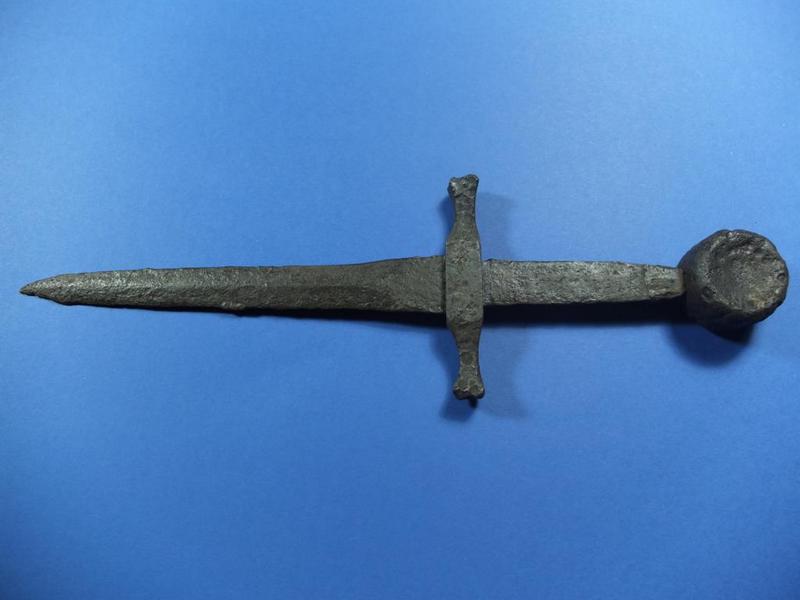

Who can help dating this medieval dagger?
maybe someone knows a similar type sword or dagger.
length 34cm, pommel Oakeshott type G with hollow/concave surfaces 4cm/2.8cm thick, grip 8.4cm, 9.6cm cross, blade 19.6cm
thanks for the help!

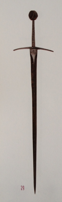

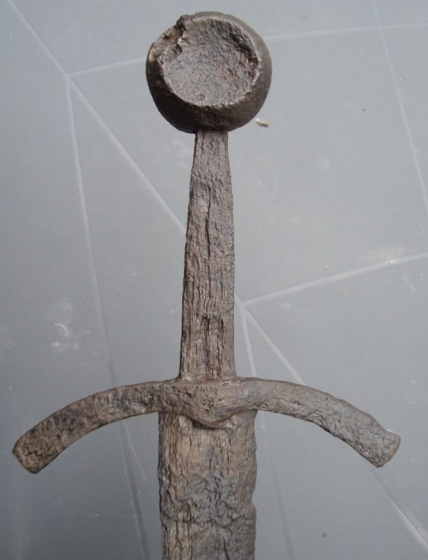

Only I know of a sword, an excavation from belgium with the same type pommel, with hollowed faces.
see photo.
Is there none of the forum who can tell something meaningful about the dagger or it's type?

Hi Jasper,
My experienced friend says that the form of the quillons, with their pronouncedly swamped terminals - and obviously terminating in an additional tiny bulbous finial - is a characteristic feature dating that dagger into the late 15th to early 16th c. when rondel pommels were still in use.
The length of only 34 cm indicates that it may have been either a lady's dagger or stored under garments like a cloak.
m

Hi Michael,
thank you and your friend.
it is difficult to date a dagger because there are few differences in style over the centuries and of course very few surviving examples.
a brief comment about the length, most medieval quillon-daggers (daggers with pommel and cross cf GF Laking) have a length between 28-35cm! this is nothing unusual. (see Waffensammlung des bernischen Historischen Museum in Bern,Wegeli)
Guillon daggers longer than 38cm are extremely rare.
fe there are 3 long guillondaggers found in the Castillon hoard, however this is regarded by some as short swords because of their great length.
Oakeshott has made a brief comment about this type of pommel with concave faces in tsitaoc P95, pommel type G
'some examples, mostly dating after 1400, have concave faces"
further, I found 3 swords, maybe daggers or maybe swords for children?, with a similar short ricasso;
musée de lármee jpo1189, RA ROMs P227 # 19, p238 glasgow museum ROMs.
1350-1450 sounds plausible.
best,

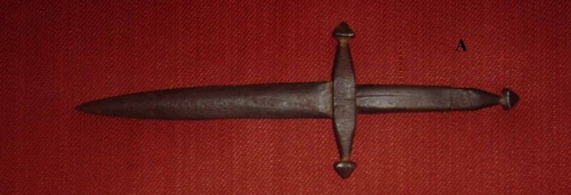

further I got an interesting picture with a late 14, early 15 century dagger with some similarities in blade geometry and quillon form.
the pommel popular after 1400 in combination with the cross-type 2 and more important a blade with short ricasso! make me date the dagger in the 1350-1450 time span.
