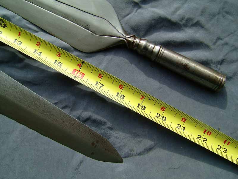

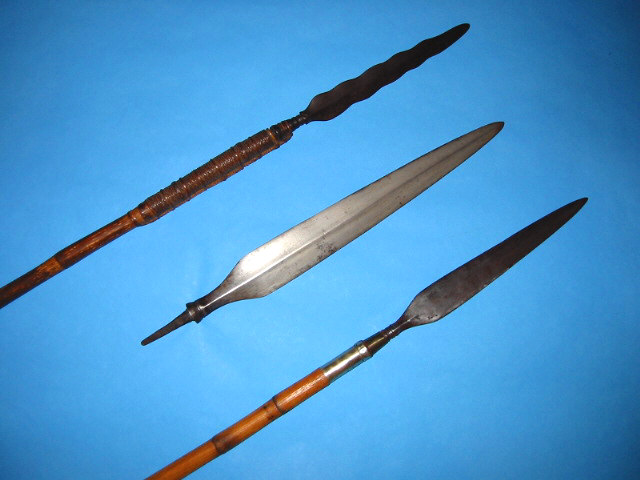

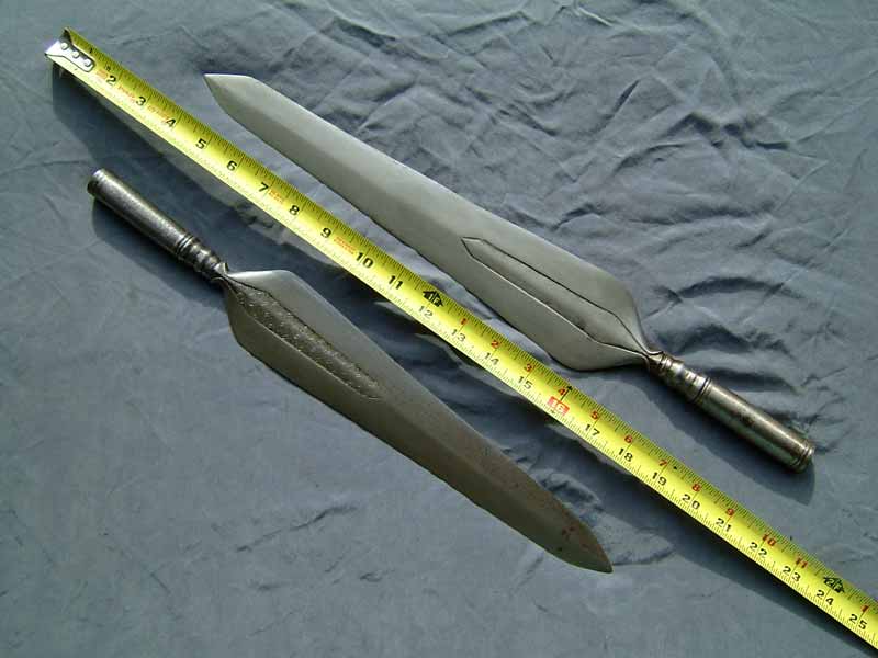

Hi Guys
Can anyone explain to me why there is such a size difference between the spear in the middle and the other two on the sides. Would the larger one be more for show or for status? The bigger one measures 18" and weighs 2lbs the other two are around 12" and much lighter in weight.
Lew

Variation in size of weaponries, at least in South East Asia, seemed quite common. There are little Javanese spear blades 5inches long and there are monsters 2-foot long, I've heard. Small ones could be for talismanic uses, large ones could be 'presentation' or 'ceremonial' ones, being too heavy or unwieldy to use. Or maybe it was the weapon of a particularly large warrior.
I've read about moro spears 18 inches long which were actually used, but this is the 1st time I'm seeing one.
Same thing happens in sundangs -- I've seen blades range from 18 inches to 27 inches.
Maybe there isn't much explanation to it. S.E.A. harbours lots of quirks. But that's part of cultural evolution in a region of ten thousand islands, isn't it.

Oh yes, and maybe it also depends on how the spear is going to be used. Slashing spears tend to be broader and bigger, but maybe somewhat flatter. Thrusting spears can be shorter, narrower, but thicker in blade.

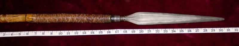

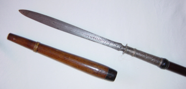

Hi, is this a Moro spear?[IMG]http://[/IMG] The blade is 32 cm ,the total spear length is 152cm, and finnished with a rather nice small horn pommel.Tim

Tim, see Malay World Edged Weapons site- http://perso.wanadoo.fr/taman.sari/ , discription under Indonesian tombak.

Hi,thank you ,Malaysia or Java thats quite a distance betwean the two.I do not know much about pieces from this area.I will collect anything that seems right at the time.Tim

Tim, I think that might be Sumatran. Note the small disk guard, the swelled tip, and the second ferule (that is a second ferule, isn't it?).

From the Malay World Edged Weapons site- http://perso.wanadoo.fr/taman.sari/ -"The Malay Peninsula Lembing usually has a raised central ridge (ada-ada) and it is elongated. The shaft is decorated with a long ferrule with engraved silver or copper and a disk between the blade and the ferrule."
btw if we were to broaden the term from the earliest Spanish use "Moro" -interconnected groups would have included Muslim Malay kingdoms of Brunei, Makassar, Ternate, Tidore aside from Mindanao and Sulu, but classically we refer to the two later regions.

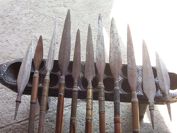

as promised, here is a picture of the budiaks placed side by side. the second one from the left is said to be a tausug's. Note however, the other budiaks here are the more common ones and they appear both among tausugs and yakans.
a different spear which is much rarer now is the sankil.

W W! that's one beautiful sungkaan!!!
nice spear collection, zamboanga...

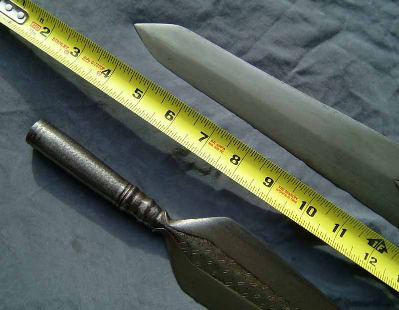

Do you have an example of an example of a sankil to share with us? I'm curious to see one. Also have you seen any examples of Maranao budiaks? Here's an old budiak of mine that I'm assuming is Maguindanao since there's a capture tag on it stating it was collected around Cotobato in 1907.
