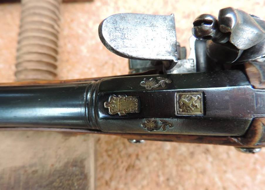

attached is a photo of a poincon found on a pair of 18th C Madrid gun barrels.
I have no information on Luis Santos, other than he was father to Juan Santos. Any further information would be greatly appreciated.
Kind regards,
Richard.

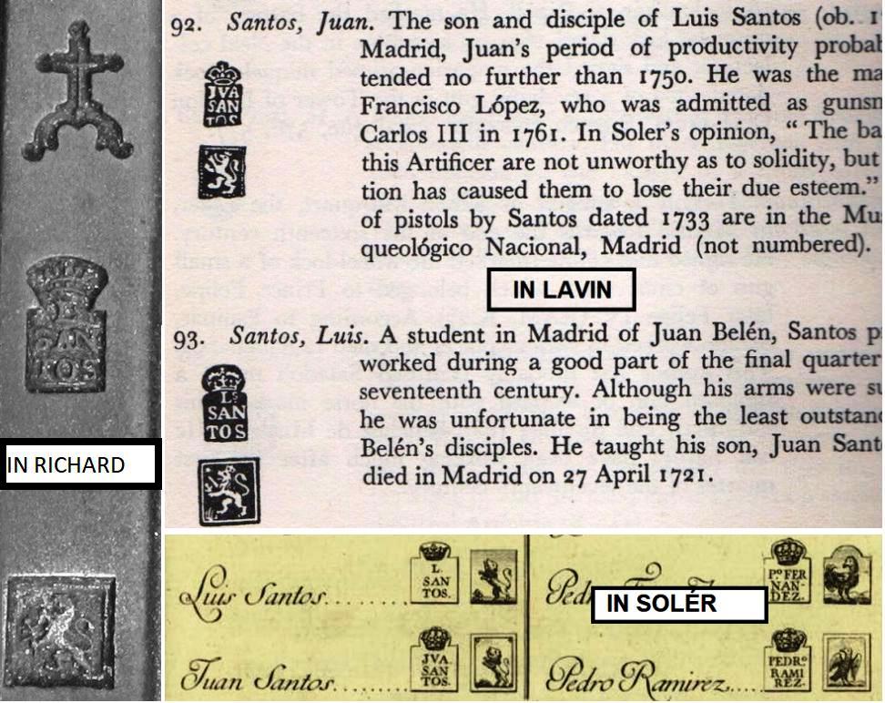

Luis Santos. A student in Madrid of Juan Belén, Santos probably worked during a good part of the final quarter of the seventeenth century. Although his arms were superior, he was unfortunate in being the least outstanding of Belén's disciples. He taught his son, Juan Santos, and died in Madrid on 27 April 1721.
( From a History of SPANISH FIREARMS by James D. Lavin ).

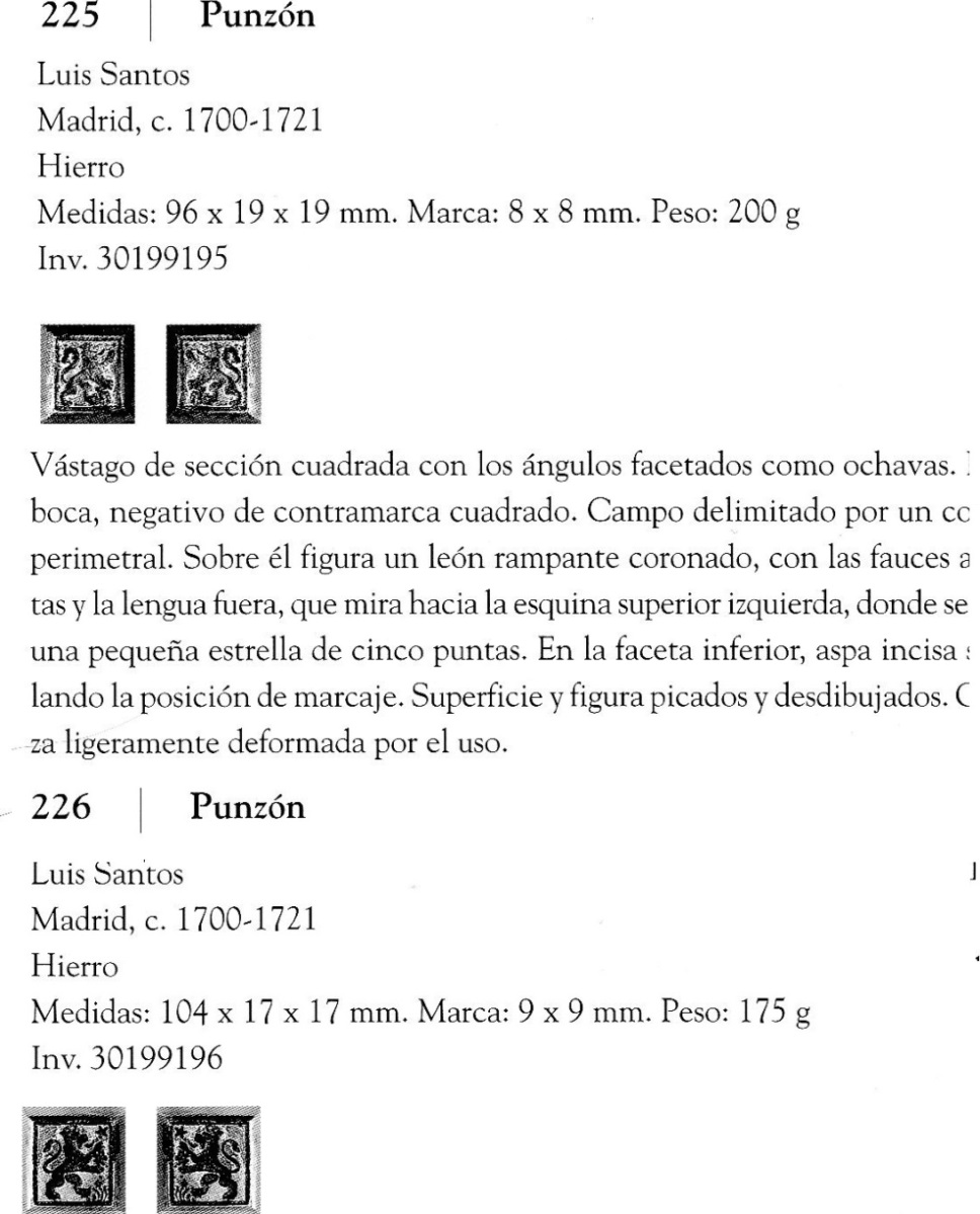

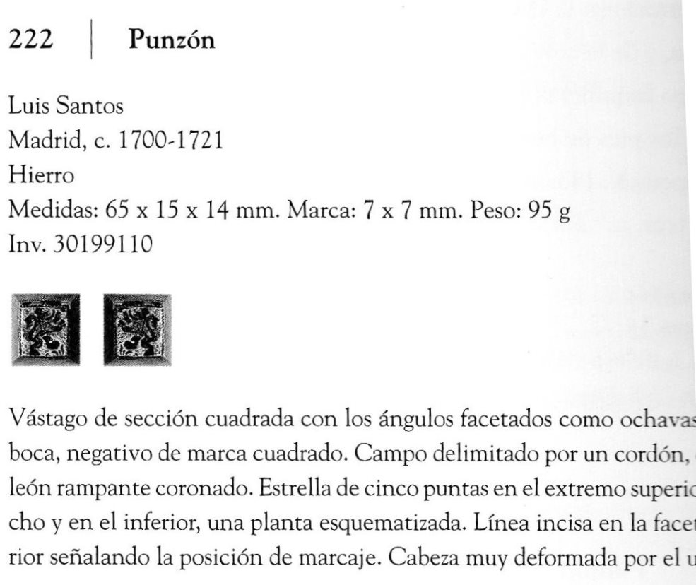

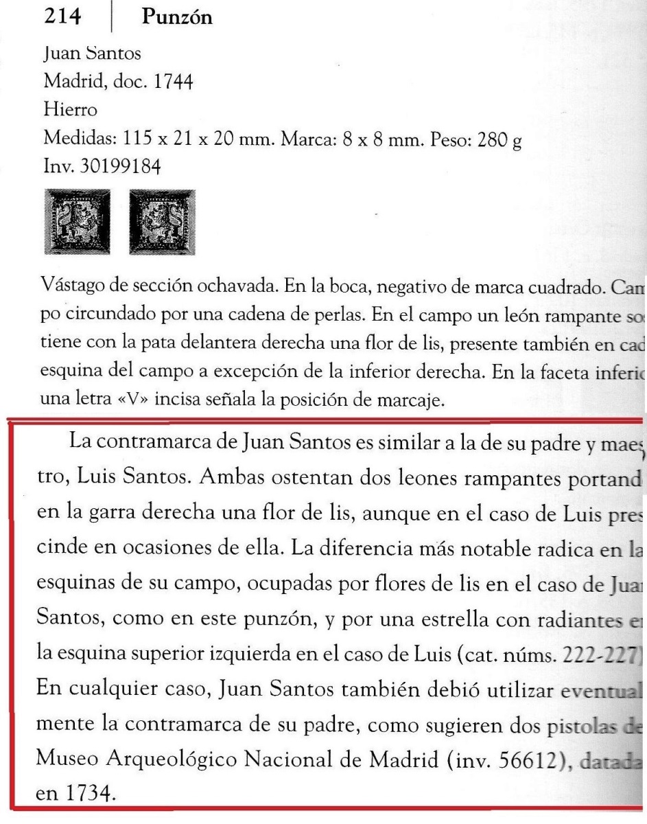

Old 17th February 2018, 12:04 PM   #7
Perhaps Richard, you should start by realizing that gunmakers often used more than one marking punzon, with slight variations; and that drawings pulled by book authors are not necessarily so exact as suc irons used.
If you compare the drawings in Lavin and Soler, you will notice that they are different; in Lavin, Luis's lion has some something in his paws and in Soler's he has nothing.
But if you look at actual irons that were used in those smiths guns, as illustrated and described in Catálogo de Arcabuceria Madrileña, you will see and read that both father and son marks have a fleur-de-lis in the right paw, although some time Luis doesn't use it. The more notable difference is that Juan used a radiant star in the top left corner, although his father also eventually used it.
... If i am not talking nonsense ... Fernando, tocayo ? .

Hello
I think that with the elements that Fernando has uploaded, the issue is completely clarified

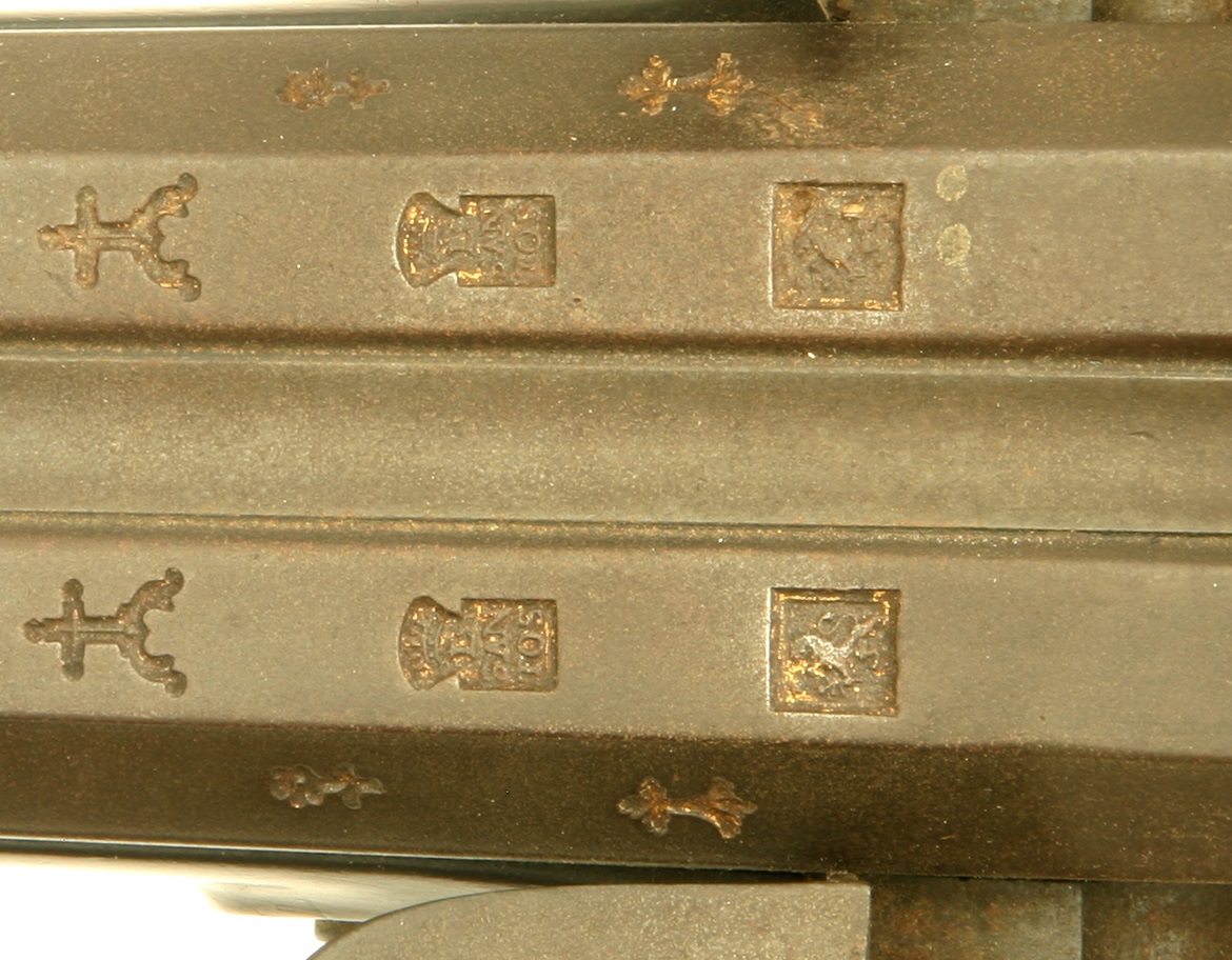

Hello
Here is a case of SANT0S gun with magnificient images
Fernando K

I find it very interesting that in this punzon, (See I remembered Fernado!)
The lion is holding in his paw what appears to be a bunch of flowers, the same as in the one I show in the opening post.
The only difference being the star is not present in the OP.
Actually, on looking at the punzon again in the OP I think I Do see a star....
As Jean -Luc's beautiful little pistol is by Juan Santos, and the above by Luis, it again shows a variation on what we see in the printed page, for both father and son.
All very interesting.
Very best wishes,
Richard.
