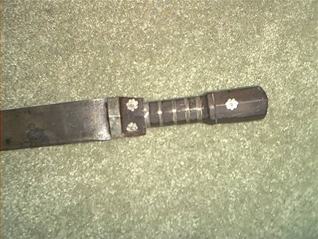

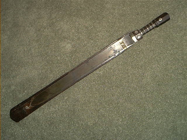

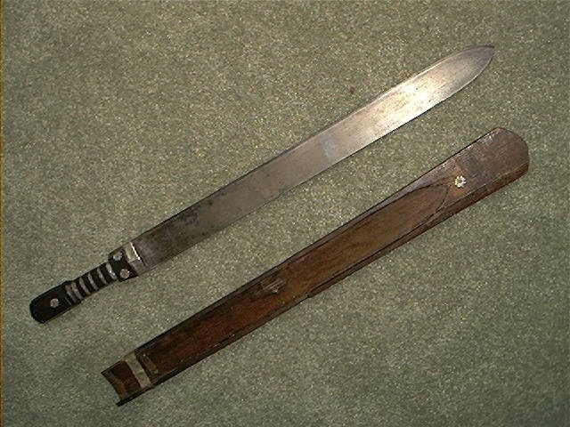

The hilt {wich is damaged a little}is wrapped in silver wire and mounted with little silver 'flowers',scabbard only has one brass band left on it.
Definately looks like it has the 'hair pin folding' found in Tibetan/Bhutanese swords,I will have to clean and etch it. 19.5in oa.Let me know what you think:

Hello Justin, I have one of these, they are nice are they not? so why do you want to damage it with acid?Tim

The knife or short sword is the traditional "ban" of the Lepcha people, who principally came to live in remoter, forested valleys in Sikkim, but were found in Bhutan as well and across the Nepal border. Although it frequently appears as "Bhutanese," it is distinct (in length, blade shape and composition, scabbard and decoration) from the typical arms of the ethnically Tibetan Bhutias who migrated into the area and became the majority (at least before the influx of a great number of Nepalis to the area). I believe that Lord Egerton identifies such a piece as from Bhutan, as indeed it could have been made, used and collected there. A photographed example in his book is identified as from "Bhotan or Nepalese Frontier."
I confess that I can't make out clearly from the photos details suggesting folding or lamination. Earlier examples may have had blades more like Tibetan and Bhutanese swords--although I confess that I have not seen any documented early examples. By the late nineteenth century it seems that they were monosteel, as are all the examples I have seen. J. Claude White, in "Sikhim & Bhutan: Twenty-One Years on the North-East Frontier, 1887-1908," reported that "Very good knives are manufactured in Sikhim. They used to be made from indigenous charcoal iron, but now that steel bars can be bought so cheaply the workmen--more is the pity--have entirely abandoned the old method of extracting the iron direct from the ore."
I'd agree with Tim in that, while I have several "hairpin folded" swords from Tibet, Bhutan, and Burma, I would not etch them to try to make the contrast more pronounced. It may be conservatism, but it would certainly tend to better preserve the blade and its patination. It may be truer to the original appearance of the blade as the differences in the steel used for the blades may have become more pronounced over the years--as opposed to their appearance in a new blade--because of differential oxidation. Surely, the Tibetans, for instance, appreciated the patterns--particularly the "jelly roll" type sometimes employed on daggers or short swords--but it doesn't seem to be a characteristic meant to be as pronounced or as significant as on, say, krisses. Just my opinion, of course.

Tom:The blade does seem to have a differentially hardened edge and thats a very big reason I wanted to etch it,I doubt the pattern will be great but it will stand out much more than if its not etched.
As to etching the blade,and damaging patina.I rarely leave any 'patina' or anything else on the blade,my goal being to keep my swords in as close to original condition as possible.I think the etch among other things actually helps prevent the blade from rusting and in the proccess of the etch the acidusually cleans the rust out of the pitting in the blade leaving it virtually free of all rust.Further more,Im careful when wetching to not over do it,I generally use lemon juice or very very dilute muriatic acid,like tom said if etched lightly it doesnt take much to take it off.
