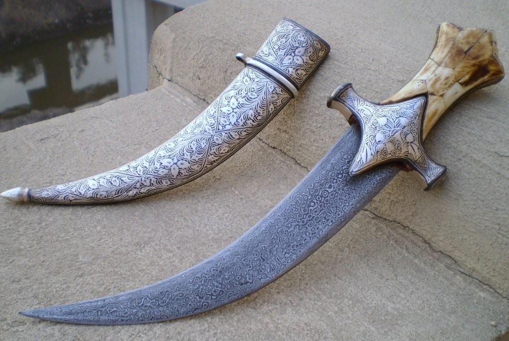

On a recent trip to Egypt I picked this up.
Could anyone identify it for me, please. Name, country of origin, ideas on age etc. Particularly about the blade pattern and grip material. I have not got it with me at the moment but it is about 370-380mm long overall, the grip is less then 100mm, probably closer to 80mm.

Mumbles, welcome to the Forum,
This is a modern dagger. They are made in India to fuel Tourist markets worldwide. The blade is pattern weld/layered steel which is a form of mechanical Damascus steel. This pattern is also known as "Tiger Eye". The handle is coloured bone, most likely camel bone, and the steel scabbard is decorated with silver coftgari technique. I'd not call this dagger ethnical or collectable, etc, it is a pure mass-produced souvenir or novelty item, and I hope you did not buy it as old or valuable antique:-)

What a nice knife to start a collection with!
As Alex says, It's new, but hand made and certainly shows a lot of skill!
Alex has covered most of the infformation about it. Sometimes the pattern is called 'Birds Eye' also.

AS STATED ABOVE IT IS A RECENTLY MANUFACTURED KNIFE AND PROBABLY HAND MADE. IT LOOKS LIKE IT IS WELL MADE WITH VERY NICE WORKMANSHIP AND IS VERY PLEASING TO LOOK AT, CONGRADULATIONS. THE ONLY THING I CAN ADD IS THEY MAKE A WIDE VARIETY OF SIMULAR KNIVES IN MOROCCO AND DO THIS LEVEL OF WORKMANSHIP THERE AS WELL AS IN INDIA.

I would NOT attempt to sharpen it for 2 reasons: 1) sharpening will leave white-coloured edges and they will have to be acid-etched to bring the pattern. 2) this type of pattern weld is better this way, it may have a "crumbled" effect when sharpened.

These newer birds eye pattern welded blades tend to be very soft; not worth sharpening IMO .
