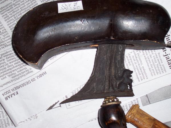

I’m new there so please forgive me if I’m asking something that has been asked several times already. I’ve relocated recently in Indonesia and since I’m interested in keris I’ve been shopping aroung to look for original ones.
However, I’ve been quite disappointed since it seems to me that most of the keris I saw where not originals. The point is that I’m not really sure about that: I’ve been comparing the quality replica sold at shops like mirota and I just couldn’t really see the difference with the ones sold in cities like Joja for instance. I’ve been around the kraton and close to malioboro, but keris salers were more keen to speak about magics than about their keris themselves: a lot of them were with golden naga (even entwined ones) and i couldn't make out whether those keris were fake or simply commonplace in older times …I’ve seen on the forum that experience was the best way to learn about it, but I believe that there are also a few technical & basic points that can be checked to avoid basic errors (ganja & blade separated…) : would you be kind enough to list the ones you think about?
I’ve also taken a few pics: what do you think about these?

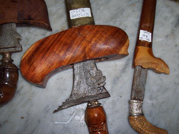

First off, I think you should remove any price tags on your kerises before you ask fellow forumnites of their opinions. It is sometimes quite amazing what a price tag can do to influence opinions.
Anyway, to your general questions of how to tell real kerises from fake kerises, I think it depends on what your definition of a 'real' and 'fake' keris is. To me, there are no 'fakes', only poorly-made ones, or well-made ones, fanciful/'touristy' ones or traditional ones.

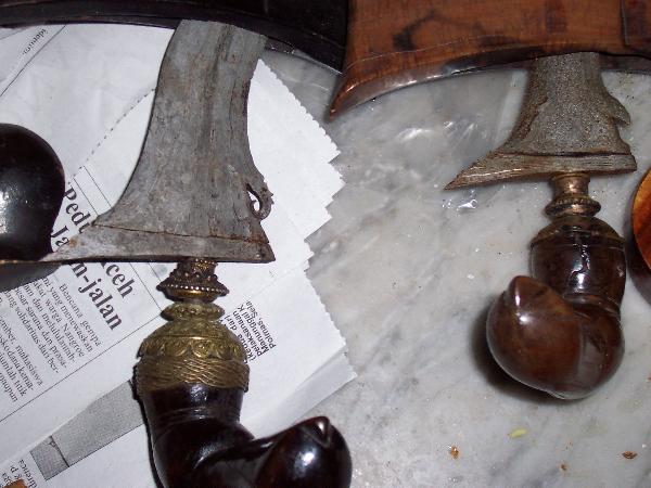

3. I don't know if the blades you show are yours, but for the most part their quality appears fairly low. The keris singo in the first pic might have some age and be fairly decent, but i wouldn't be able to tell you from the provided picture. For some reason, someone stuck a Javanese mendak on the Bugis keris on the left in the second pic. If this keris is yours i would remove it as it doesn't belong on this keris. The keris naga in the third photo looks like it might have been a later addition on an older blade. It appears to be poorly carved and there are signs it is not original to the blade.

By fake, I indeed meant that they had been presented as old keris while they were actually recent ones (so i should be rephrasing into: how to distinguish a touristy keris from an original one?)
For the criteria of the ganja, well, I guess that this could still be considered as a good point to start with : if it is that hard to find some old keris, what are my chances to find one of those rare original keris without a ganja? If you can find of some other practical advice, please don’t hesitate.
Thanks also for the books, those in English should be especially useful since my knowledge of Indonesian is not good enough yet to go through an entire book!! i don't think gramedia's got anythg about keris, but i'll check 4 the encyclopedia...
As for the pics, no I didn’t buy those keris…it’s just that they didn’t look like the more touristic keris I saw previously. It’s nice to know the singa one could be an old one, even though the quality is poor..’gives some courage to continue looking around…expect new pics! (hope more interesting ones )
