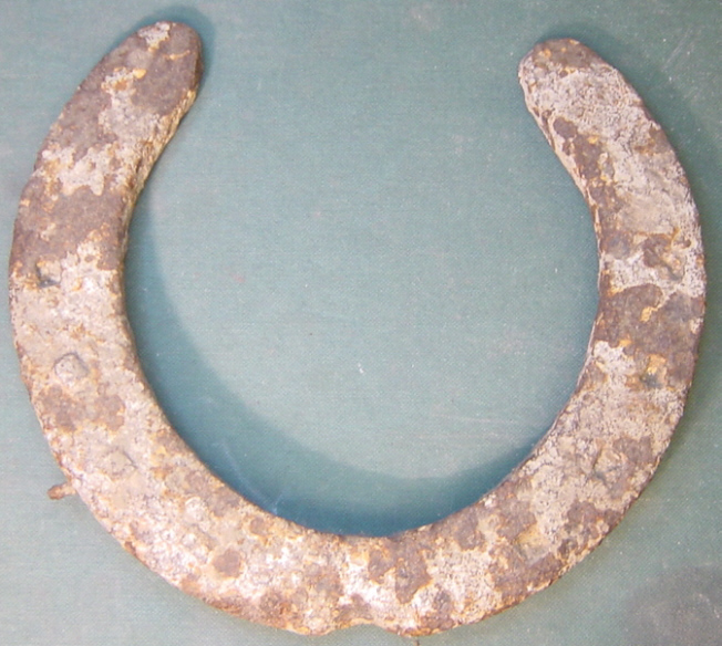

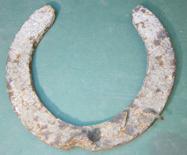

I think Lew may be right. I found this heavy horse shoe up by the Uffington White horse and the Weyland Smithy. Looks like your knife has been buried in very much the same soil type.

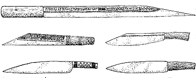

Gene, I really wish this was a Seax but the shape etc is not right ...according to some web resources the clip point with a false edge 'materialised' around the 1830's...so perhaps an early Bowie (as already suggested) ...apparently early types were fitted 'into' the handle...as the tang on this one suggests.
Any luck with the rust removal ?
Kind Regards David

Tim, yup, does look VERY similar corrosion wise. I think I'm going to be dissapointing my friend once its been cleaned.
Great diagram David! Wish mine had gold runic lettering along the top edge
