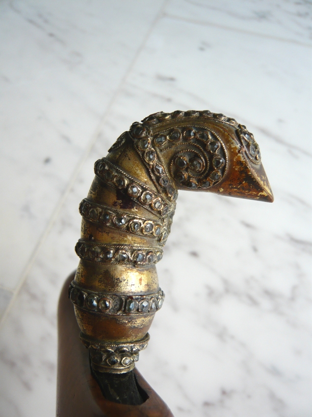

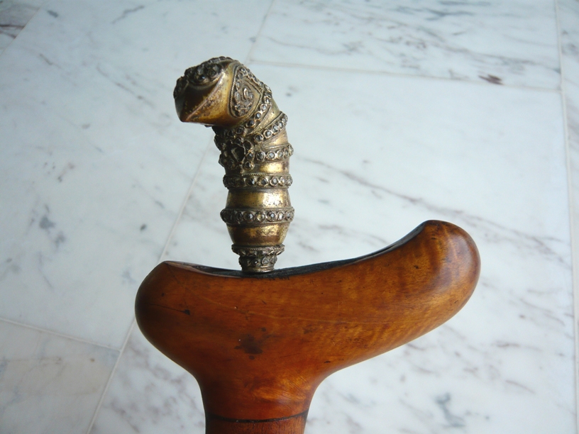

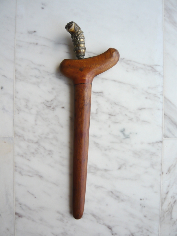

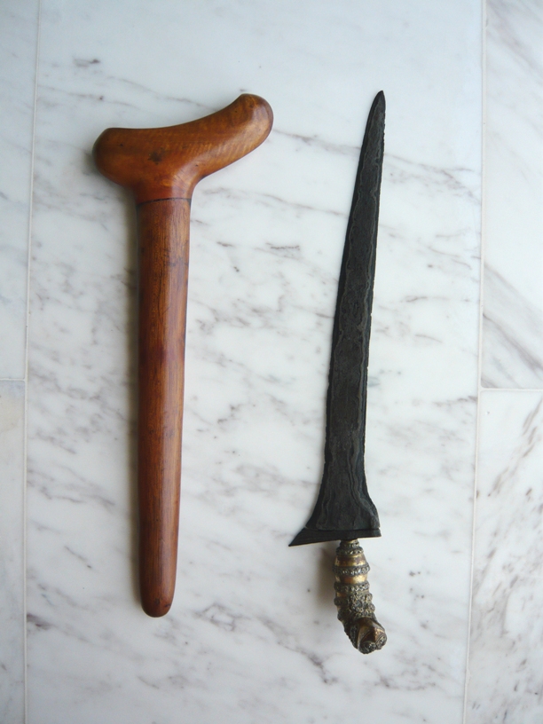

Ok, this aint a put together - but a true-blue Banjarmasin keris. Most of the time, we see Javanese, Sumatran or Bugis kerises with Banjarmasin hilts, but seldom on the perculiar kidney shaped sampir characteristic of Banjarmasin's 'indigenous' form, if I may say that.

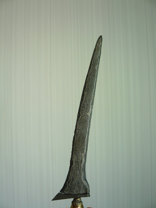

The keris blade itself is highly unusual. You may see it as a Bugis style blade, but I can assure you the peksi is thin and straight like a Javanese. Also, the pamor does not have the characteristic ujung gunung + kulit semangka combi found in most Bugis blades. Is that a made-in-Banjarmasin blade? I don't know, but the mix of features is certainly out of the ordinary.

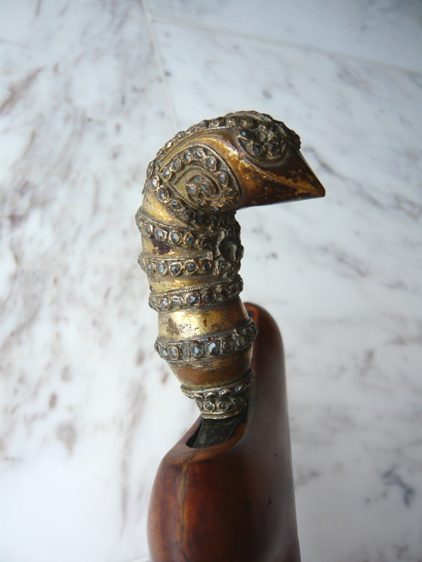

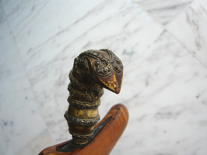

The hilt has lost quite a few intan stones, and nearly half of it's gilt. However, the overall look of the keris is still pretty good. Next to the coteng keris, I'd say this is my rarest keris.

Are the stones intan, or yakut?
Yakut would be the norm.

Hi Alan,
That's a good question. I've always assumed the stones on the Banjar hilts were intan - non-jewellery grade diamonds with a lot of inclusions.
And though I've heard of yakut stones, nobody had explained what they really are.
And how would one tell yakut stones apart from intan? I understand both are generally clear and colourless (except for the inclusions).
Thanks.
Old 14th December 2008, 01:43 AM   #4
Posts: 7,258
Yakut are rose cut rock crystal.
Many dealers will try to pass off yakut as intan, and really, the only way I know to tell the difference in a buying situation is by having seen and handled a lot of both stones.
Intan throw a very hard, often blue light. Its a hard, cutting light---if that makes any sense. They have a good brilliance, most yakut have very low brilliance, and they throw a softer, whitish light.
If you examine under, say, a 3X loupe, the edges of the facets in intan will be hard, sharp and clean and the facets will be clean and level; in yakut the edges of the facets will often be bruised, a bit rounded, showing wear.
There is a very, very big difference in value between intan and yakut. Intan are not always low grade diamonds. Intan is the old fashioned rose cut, berlian is the modern brilliant cut. Its the cut that makes the difference in name, not the quality. My wife has some very good 19th century rings set with intan, and the stones are large and without inclusions, of good brilliance, and good colour---but they are still intan, because they are rose cut.
Old 14th December 2008, 02:59 AM   #5
BluErf
BluErf's Avatar
Location: Singapore
Posts: 1,180
Thanks for sharing, Alan! That has been more substance contained in a short post than years of hearsay.

What's the size of it?
Is it smaller than a regular bugis keris?

Can we please see the pesi when possible?

Sorry, was busy for past few days. Ok, I've got the pic here. Pardon me - I didn't unwrap the nylon thread around the peksi because I thought it was rather well-done and packed-in to try to unravel. Anyhow, you can see the base and the tip, and get an idea of how tall and thin it is. The nylon thread is quite thick.
The keris blade is 11.7in, which makes it more or less the same size as a standard Bugis keris. The peksi is more than 2in tall.
