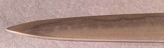

I have posted the picture of what I believe to be a temper line with an intact (but altered) surface pattern, to show that it could and was done.
One way around the above described problem would be to harden only the edge, so that the unhardened spine of the blade would provide the necessary strength and toughness that the blade requires. This would counter the negative traits of the hardened section.

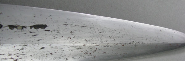

I own this old wootz sword .
http://www.oriental-arms.com/photos.php?id=1048
The pattern disappears where it seems to have been hardened (picture 2).
