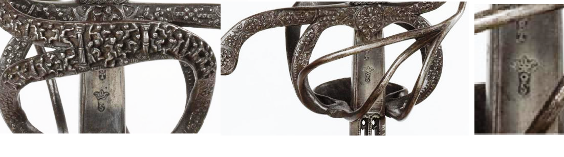

Actually Jim, i thought this subject was by now depleted of new entries once, in one had, we don't see so many interested in following it and, on the other, exhaustive web research has been so dry of results that it looks like this came to an end.
When suddenly the fountain of knowledge opened its tap and we are again contemplated with further info.
If we have a second to look to the notes of JOSE MARIA PELAEZ VALLE called COMENTARIOS METALÚRGICOS A LA TECNOLOGIA DE PROCESOS DE ELABORACIÓN DEL ACERO DE LAS ESPADAS DE TOLEDO DESCRITAS EN EL DOCUMENTO DE PALOMARES DE 1772, we may catch that, among Palomares dual position in that, in one hand, he rejects the mystic of the Tagus river being the explanation for Toledan swords quality, rather than the competence of their smiths forging techniques, soon after he romantically points out the gold particles in their sand melting to a fine varnish that impeaches the sparks escaping from the steel spirit, we carry on reading the above author's chronicle in that Palomares work is neither definite nor complete in that, for one, he fails to mention that Juan Martinez (el Viejo), used a contrast of a figure looking like a fleur de liz, with examples in the Dresden Museum, inventory numbers bla and bla.

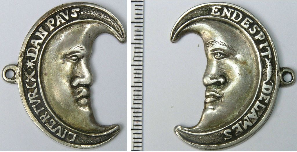

In a most interesting circumstance pertaining to the half moons, some time ago I found reference to its use in Holland as a symbol for the notorious privateers known as the 'sea beggars' or 'waterguezen'. These were primarily associated with Calvinist Dutch nobles who from 1566 onward vehemently opposed Spanish rule in the Netherlands.
They contrived the use of the half moon with face to allegorically suggest it was better to be in league with the clearly contrary Turks than to be under Spanish suzerainty.
At this time the crescent moon was considered representative of the Turk, and in 1570 a medal was designed with the half moon emblazoned with the motto, which is worded essentially 'rather Turkish than Papist, in spite of the Mass'.
It seems odd that the Dutch used this symbol, it would seem almost inadvertently as far as the Turk analogy, while here it seems to have been of key religious significance to the Spanish, who they were opposing.

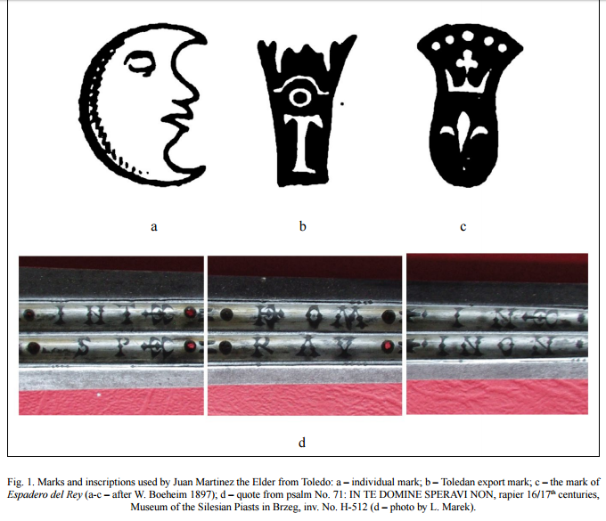

In the study made by Lech Marek we may see that Juan Martinez, certainly as many others, applies religious inscriptions in his blades, apparently not for his introversion but more on the talismanic perspective, as so often this kind of habits is dicussed. In the blade example shown above he quotes psalm No. 71: IN TE DOMINE SPERAVI NON and, as mentioned, when having space available depending on the type of blade he forges, he inscribes the other part CONFUNDAR IN AETERNUM ... if i am correct.
For those no bothering to consult Lech Marek's work, nevertheless a very succinct paper, not so exhaustive as that of del Canto, where you fall asleep before you find what you are looking for, i here upload one of Master Juan Martinez magnificent blades, mounted in a beautiful chiselled iron Dutch renaissance hilt ... and also pictures of where the surviving punzones de espadero are kept, in Military Museum at the Alcazar de Toledo

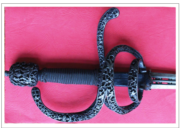

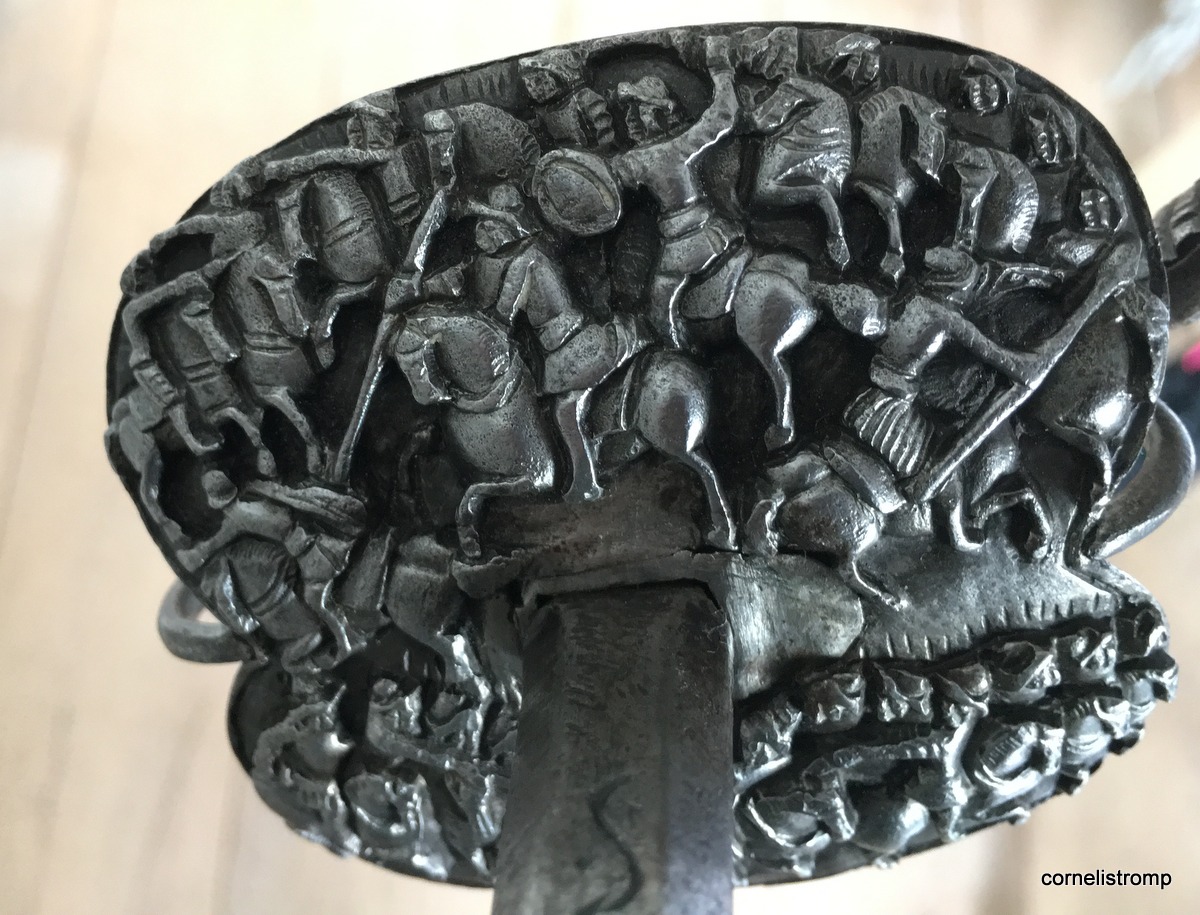

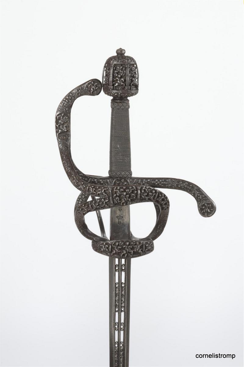

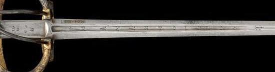

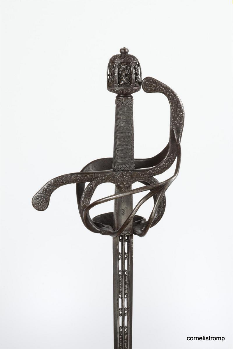

The hilt of post #7 can be Italian I/o Dutch.

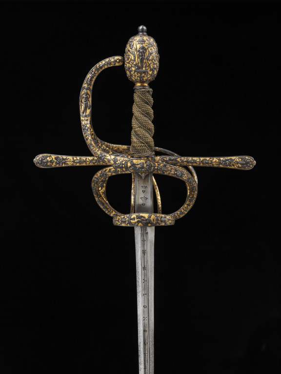

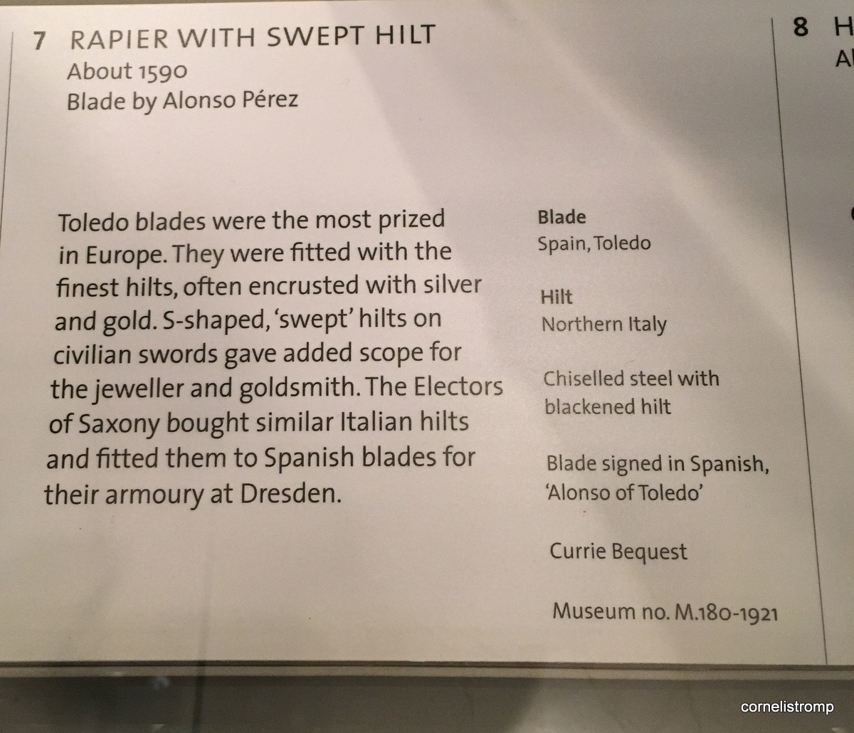

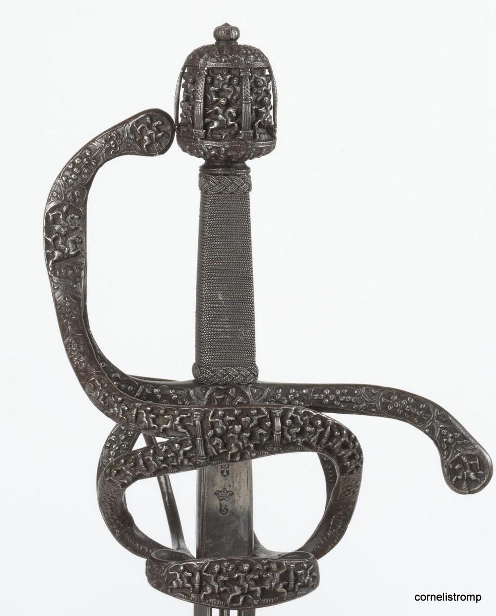

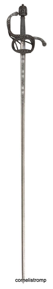

see, for comparison, a rapier at the V & A museum from the armoury of the Electors of Saxony.
The Hilt is probably from Italy and the blade is an export blade from Toledo.
it's hard to say where these type of hilts are made.
from the V&A description:

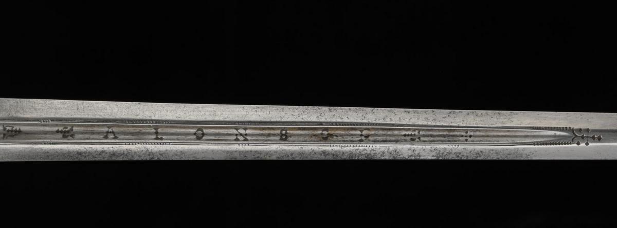

The blade is a high quality Toledo blade by the prestigious maker Alonso Perez. Perez worked at the shop of the famous swordmaker, Gil de Almau who produced several swords for the Emperor Charles V and his son Philip II of Spain.
Sword blades were articles of international trade, made in a few important centres and shipped all over Europe where they were fitted with hilts in the local fashion. During the 16th and 17th centuries the sword blades of Toledo, Valencia and Milan were the most sought after but the largest centre of production was the German town of Solingen. The finest hilts were usually equipped with a Spanish blade but if not available a German blade (sometimes with a spurious Spanish inscription) was fitted instead.
fe this is probably the case with the German blade? of the Rapier of Jean-Luc
http://www.vikingsword.com/vb/showthread.php?t=22366
The most prosperous swordmakers in Toledo were concentrated in an area bordered by a road called Calle de Armas (Weapon Street) where there were also ironsmiths, crossbow makers, knife and axe makers. Guild regulations in Toledo were strict. Those seeking to practise as swordmakers had to pass strict tests of quality stipulated by the King. The King also protected the Spanish trade by issuing a decree in 1567: "... do not allow or permit to import any kind of sword in our kingdom from the exterior, and the ones made in Toledo wear the mark and signal of the master who made it and manufactured it, and the place where they are made, and whoever violates this they will be condemned as false ..."
best,
Jasper

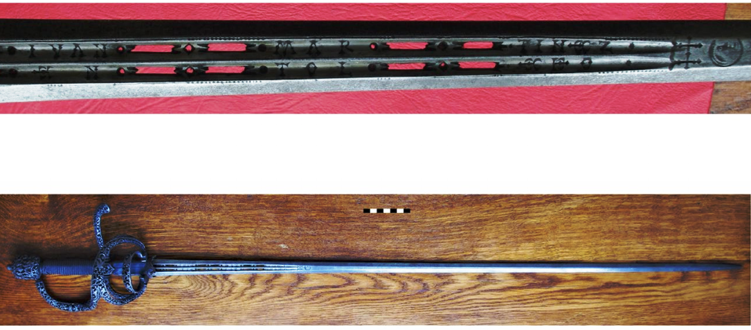

Hi Jasper,
It is good to have the top brass entering in this thread, which means this has some interest in arms study.
You have noticed that, the asumption that the hilt shown is Dutch, is one from Lech Marek in his mentioned work; i wouldn't be able to judge it by myself. Mind you, he mentions Dutch style; maybe this makes the difference:
Fig. 5. Chiselled iron hilt of the rapier from Fig. 4. Dutch renaissance
style. Photo by L. Marek.
Yes, the 'Calle de las Armas' and the tests the smiths were submitted, as already approached in the same thread you linked to the Jean-Luc rapier discussion.
http://www.vikingsword.com/vb/showpo...2&postcount=28.
Every 5th March two examiners and two observers would perform such exercise, visiting candidates in their shops ad workshops.
But it is interesting that you show that beautiful sword with an Alonso Perez blade, as we here again face the dilemma of the marks discepancies. If my eyes don't betray me there is a clear difference between the mark engraved in your sword and that recorded by Palomares in his nomina. I wouldn't at all dare pretending that the blade you post was not forged by the illustreous master, but then, we may stand before another of these recurrent riddles.
However if i am wrong, which i am ready to admit, please bother correcting me .

Old 4th March 2017, 05:47 PM   #11
cornelistromp
cornelistromp's Avatar
Join Date: Mar 2009
Posts: 1,071
Hi Fernando,
I wish that rapier was mine
it is one of the nicest swords in the Victoria and Albert museum.
and.....believe me, there is very small chance that there is something wrong with the allocation of the blade.
(this description is made by Claude Blair, not the first best.)
please see
http://collections.vam.ac.uk/item/O9...-alonso-perez/
best,
jasper
PS : Lech Marek is from Poland and I'm Dutch
Old 4th March 2017, 09:48 PM   #12
Hi Jasper,
Thank you for your enlightening.
I am not Polish or Dutch ... neither i have the capacity to attribute a sword to this or that smith, just by looking at its characteristics. But that the mark on the blade in the Victoria Museum and the one recorded in available sources are different, nobody can deny; notwithstanding that some early smiths introduced new marks at a different stage.
Ah ... also i would like to own such sword ... or the one i spotted also at the same place, with a blade of the same Master.

It is good to have Jasper join here, as this is a thread focused on an aspect of arms study which does often seem a bit too esoteric for the general arms study community. This has seemed apparent to me for the many years I have been admittedly obsessed with the origins, meanings and applications of blade markings and inscriptions. There have been a number of references over the years, mostly compilations with perpetuated errors among the fairly reliable remainder represented in these.
That is why this thread is so important in addressing at least one long misunderstood instance of the topic of blades, markings and those of Toledo with their spurious counterparts in Germany and Italy. That is the curious half moon device and the identity of the Espadero del Rey.
The article by Lech Marek is outstanding, and thank you Fernando for pointing it out. It does seem compelling in noting the character of the markings used by Juan Martinez, a noted and renowned Espadero del Rey.
It shows of course the half moon as his personal mark; the TO (which is an 'O' over 'T') as the Toledo export mark and the fluer de lis as the 'mark of the Espadero del Rey'.
In looking at this rapier from the Victoria & Albert, it does seem curious that the mark for Alonso Perez, an S apparently topped by an 'O' and crowned does not match the punzon shown in the Palomares nomina. Perhaps the reference used by the V&A was from one of these other sources we have discussed?
If the late Claude Blair was the author of the assessment of this sword, I would definitely consider it sound. This man was one of the most resounding authorities in the arms and armour world, and was cited personally as a source in more articles, books and references than I can even list.

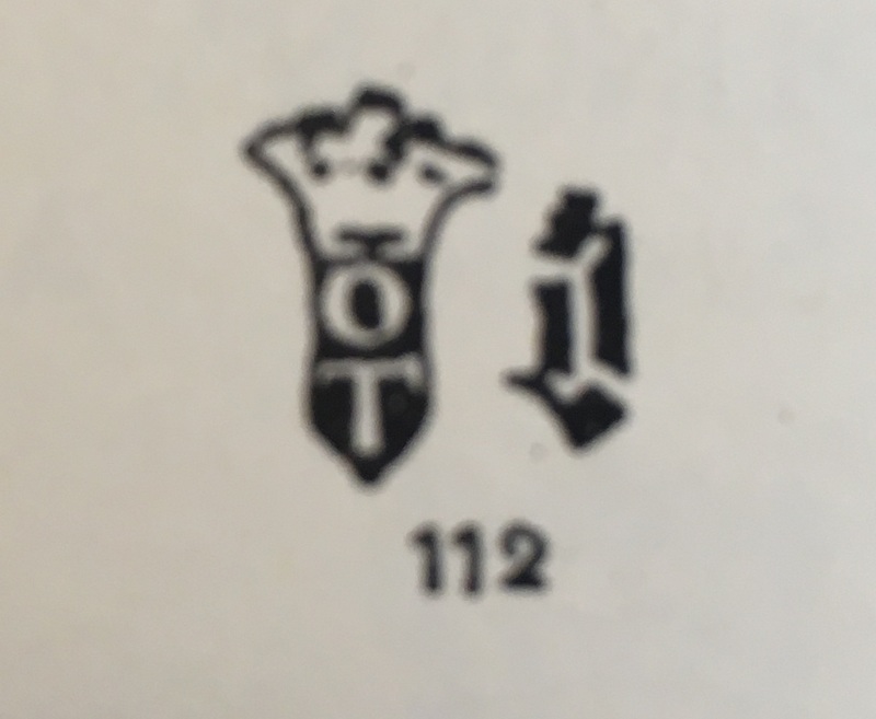

In looking at Palomares chart, it seems there are so many duplicate punzones, for example the shield with crowned S (as noted for Perez) has 6 other similar examples with only subtle variations in crowns.
Ironically 4 of these are for the Sahagun's, another highly purloined name of Toledo, as well as the one for Juan Martinez!
Another thing I am curious about is why the TO always appears as OT (the over the T) and in the Perez example with S, it is topped by an O in the same manner.

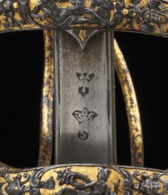

the one you posted has the same OS mark but as inscription the full name OF Alonso Perez;
A.L.O.N.S.O. P.E. on one side
R.E.Z. E.N. T.O.L.E.D.O at the other side.

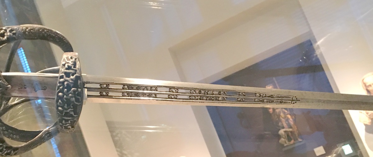

The style of horsemen on V&A rapier came 60 year later on equestrian small swords of around 1650.
they have a similar chiseled style with horsemen cut in high relief and were used extensively in the Netherlands.
however, it is not known where this type was made, perhaps by the medal cutters in Paris because of the very high and detailed quality work or maybe in liege. attached an equestrian hilted small sword from my collection
best,
Jasper

So why OS?
And why is the TO seemingly reversed (if it is to mean Toledo)? on the so called Toledo export mark as shown in Marek.

Jim, i am glad that you stood with me in the Alonso Perez mark enigma, as to comfort me for not having visions, something potential with my pharaonic age.
As for the Toledo punzon, Jose Maria Pelaez Valle questions himself on this issue and takes a guess that the different positions ot the two initials and their shield could indicate the different period (year) in which the blades were produced, like in silver hallmarks of certain countries; as also that the non applying of such TO mark in blades could mean that some masters were so reknown out there that they would see no need for such quality contrast.
It is a fact that, the abundance of the letter S on smith's marks which names appear not to contain such letter, needs some enlightenment; other than the fact that period Latin phonems could cause erroneous situations, besides cultural perceptions. Remember the great master Tomas de Ayala was illiterate. On the other hand and subject to double check, marks being usually correspondent to the initial of the first or family name, were not necessarily so; allegory to the smiths place of origin (toponimic) could also be taken into account. It seems as the S for the Sahagun family was so attributed because they actually were from Sahagun.

So why OS?
hi Jim,
I do not understand the question, can you explain it please?
Is The question why Alonso Perez used OS ?
best,
Jasper

... Now it is clear to me why the first rapier is attributed to Alonso Perez while there is only ALONSO EN TOLEDO as inscription on the blade (no PEREZ)...the one you posted has the same OS mark but as inscription the full name OF Alonso Perez;
R.E.Z. E.N. T.O.L.E.D.O at the other side...
Yes Jasper, the second example having the full name makes it clear that both blades were forged by the same smith. Now we only ignore the reason why he apparently changed his mark... and why in both cases he uses the letter S. If it weren't for the discussed S 'mania' and trying to unveil the criteria used by (Toledan) smiths in their names, the little o over the S in the the Vitoria examples might be that of ALONSO and the vertical line crossing the S in Palomares nomina could be the l of ALONSO. But this only giving wings to imagination.
... attached an equestrian hilted small sword from my collection...
Superb .
I tell you what; next time you come over to the peninsula for kite surfing you bring this one with you for, say, your self defence ... and tell me which hotel you will stay at .

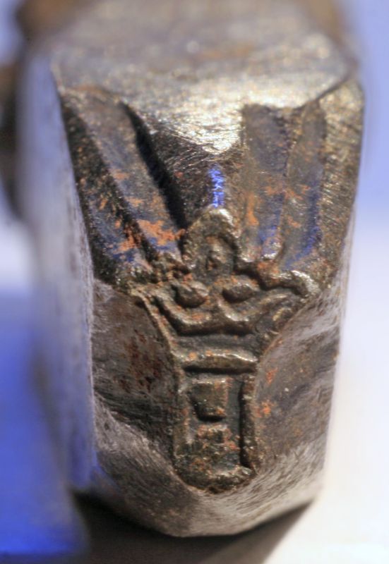

as known, some German blacksmiths from solingen used hispanicized marks.
For example, Clemens Stamm used the toldedo mark and an IS crowned together with the crescent. see nr 45,107 There is even a rapier described with a Spanish inscription
CLEMENS.STAM.ESPADERO.DEI.REY. ( A. Weyersberg solinger schwertschmeide p.44)
Clemens Tesche used crowned S, Peter Tesche a crowned B and Toledo mark, the crowned OT. etc. see nr111,112
It seems that for geographical determination, a mark in itself has subordinate value and should always be considered in conjunction with the inscribed name of the blacksmith.
best,

as known, some German blacksmiths from solingen used hispanicized marks... It seems that for geographical determination, a mark in itself has subordinate value and should always be considered in conjunction with the inscribed name of the blacksmith...
Absolutely, Jasper.
Actually the inverted stiuation, as you know, is also not reliable. Often we see blade smiths name inscriptions, some times even 'supported' by the To symbol, that are a fake; Ayala, Sahagun and other.
Palomares is a good starting point, but it must be remembered that the Toledo blacksmiths use multiple marks while Palomares has only indicated one.
Palomares has made the list in 1762, by then the heydays of blade making in Toledo were over.
Actually there were hardly blades made in Toledo in the 18thC anymore, it was almost all taken over by Solingen. The newly established fabrica de armas in Toledo did not change this.
Furthermore there has no proper investigation done by Palomares. There is no indication when the blacksmiths have worked in Toledo, mentioned By Palomares under the chart list of names .
He has only listed 5 names with a year.
there are 99 marks and only 94 names, multpiple times; el viejo, the elderly, el mojo, the younger, son and brother are used.
