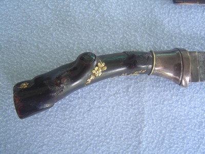

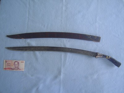

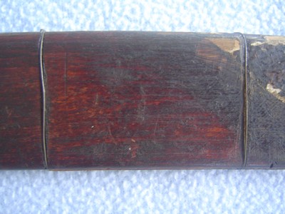

My family have this a Persian Sword for a long time, and I don't know that how does my family get it? And I will explain about this Persian Sword :

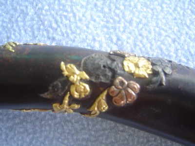

1. A holder made from a Coral (The holder 's original I think it 's not coral)
2. In the coral holder was decorated by gold copper and silver.
3. In the 2 side of sword was write as some alphabet and symbol.
And in the past 300 years ago, my primogenitor came from Astrabadi, Persia, he was name "Sheikh Ahmed", This time is in Ayuthaya period.(I reference from The Ship of Sulaiman and a book record by my family.
Please Tell me that you knows something about this Persian Sword.
Thank you so much.

Your sword could well be a re-hilted example of one of these :
http://www.vikingsword.com/vb/showth...highlight=jens
Lovely handle ; almost Japanese in the style of decoration .
Black coral that thick is very hard to come by these days .

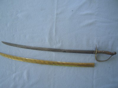

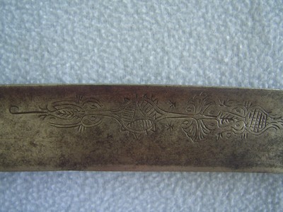

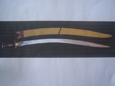

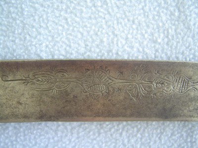

Why do you only comment on the first sword, and not on the second, the one with the Indian hilt?

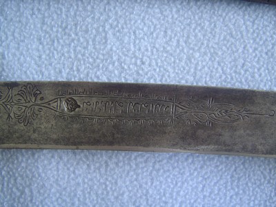

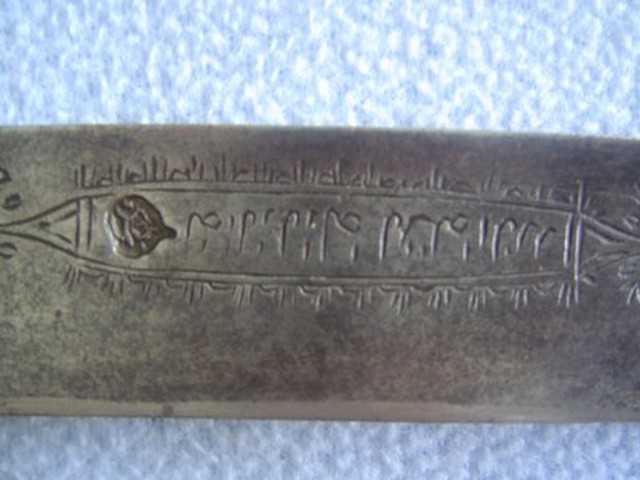

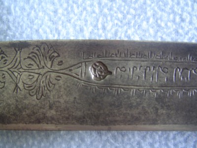

Is the inscription on the blade from the first sword? The inscription looks more like Thai or one of the languages used in that area, the way the hilt is fitted to the blade too, like Rick writes.
Is it possible to get better pictures of both swords with details of the inscription(s)?
Does the two blades have a T spine?
The first sword could very well have been/be a rehilted Sailaba/Sossun Pata, the second one with the Indian hilt surely is a Sailaba/Sossun Pata, but the inscription is a puzzle.

Default May be a Yataghan Blade??

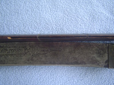

The second sword is definitely a Sailaba/Sossun Pata, as correctly stated by Jens. The first one, I am afraid is a re-hilted Ottoman Yataghan blade. I rather prefer to think that it is a Yataghan blade and not a Sailaba/Sossun Pata blade as there is no ricasso on it (Which is so common to the Indian blades). I suggest that the inscription is in Arabic letters (up-side down) and that the mark is a maker stamp so very common on Ottoman Yataghans. When where and why it was re-hilted is a mystery I guess.

Sossun Pata is a sword from India. Exactly the type you have in the second picture that I believe is a scan from a book.
Yataghan is an Ottoman sword. It is what you have in the most pictures minus the hilt. The inscription is with Arabic alphabet that it was used in Turkey before 1920. The blade is typical yataghan blade of mid 19th century. I suppose that the person who fixed the new hilt on it had no idea how the yataghan hilt looks or he wanted to have something unique.
The third sword looks like from China or Indochina but there are more experts here to say. I hope that this helps.

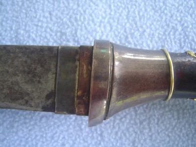

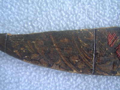

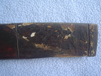

Yeah, the third one looks Vietnamese? The coral handle is interesting. It is an unusual piece of jewelry utilizing the natural shape of the coral; thus I would not read anything ethnic into the handle shape, but would perhaps look to the bolster/ferule (which seems somewhat peculiar and yet somehow familiar) and the flowers for regional ID. I would not assume this is a rehilt if it comes from an area where this type of blade is usual.

I don't know, I tried looking at that writing the other way, and although it looks superficially like Arabic script (which of course is also used in Iran and Afghanistan as well as Turkey before 1920) I can't actually make out letters.
I'll show you what I mean:
I can't make out any of those letters. I wonder if it is an Indian script.

The third one is a Thai "krabi." They became popular during and after the reign of King Mongkut (Rama IV, of "The King and I" fame), mid-19th century, though they were probably around before then.
