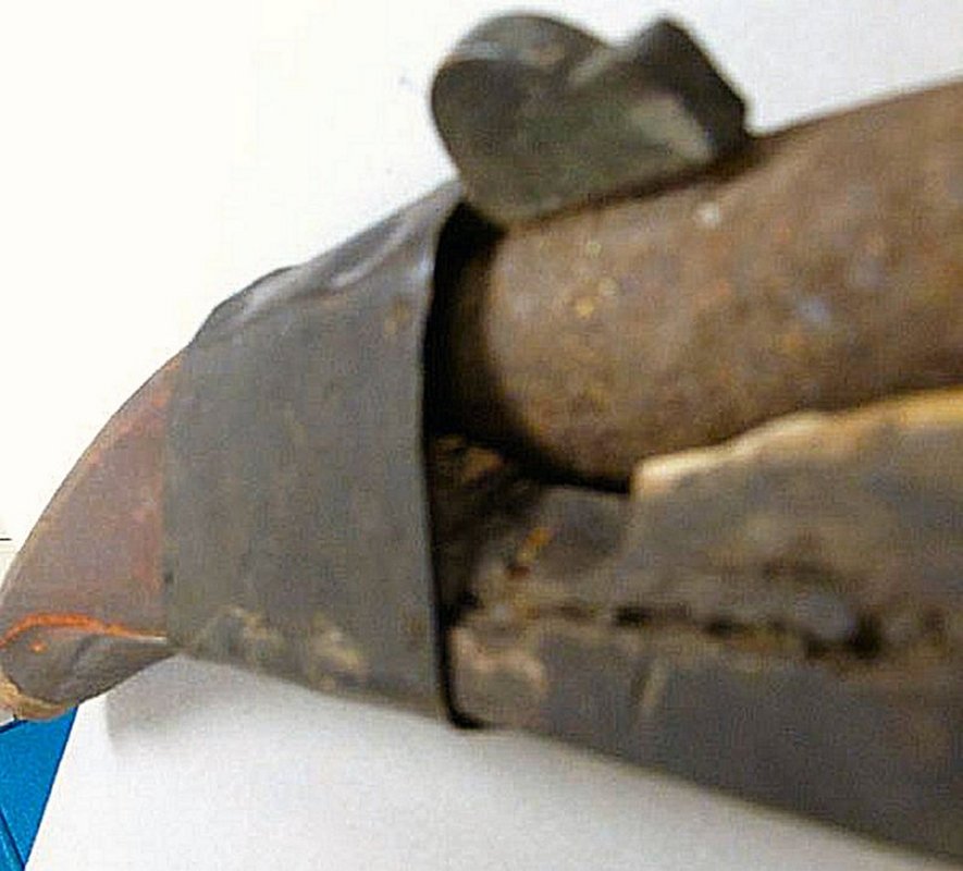

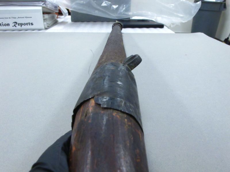

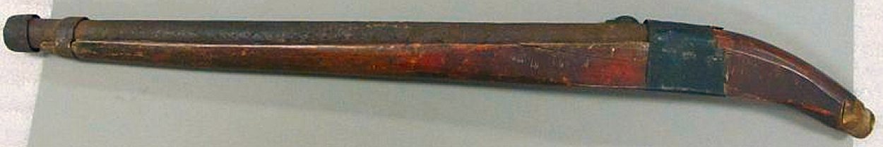

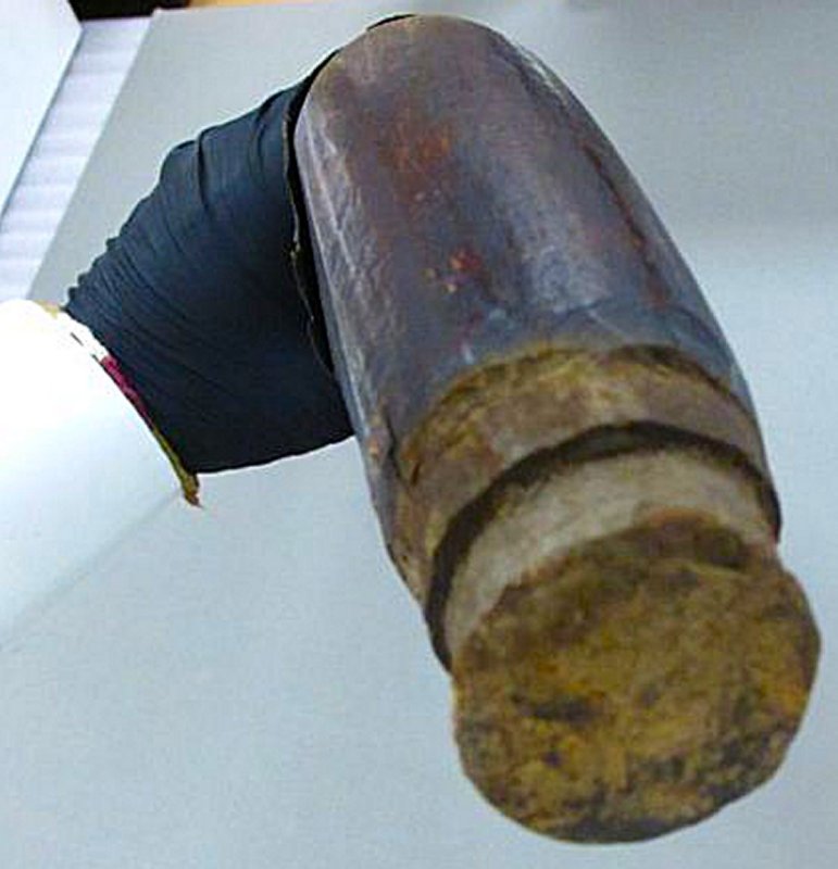

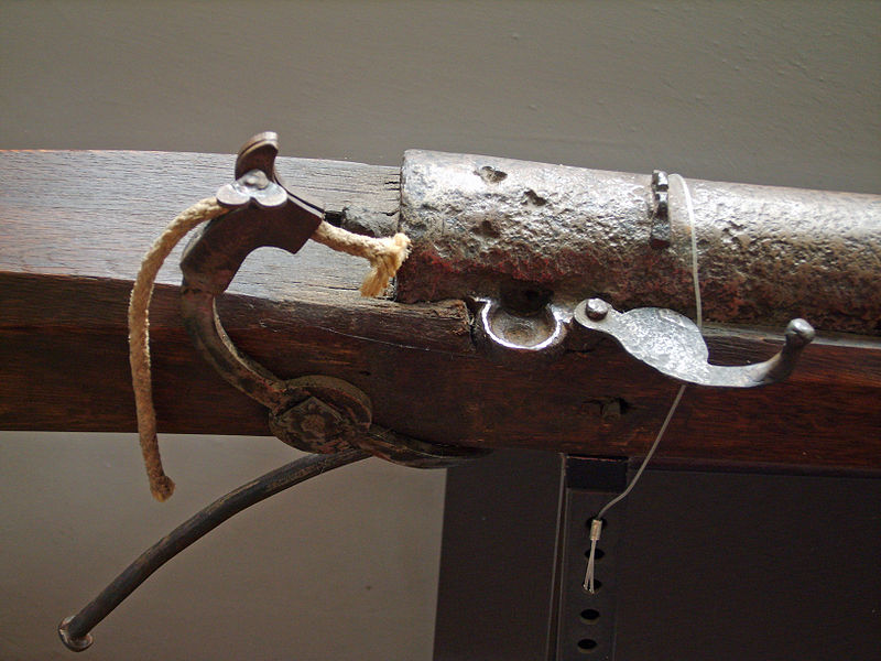

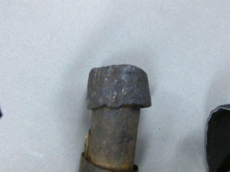

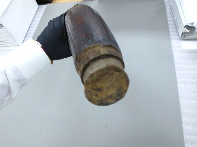

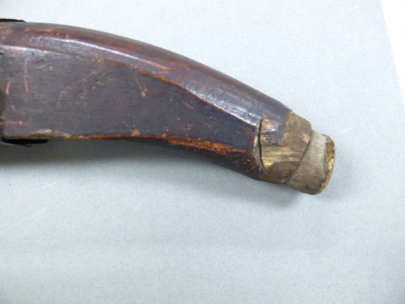

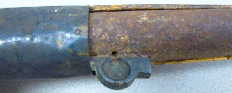

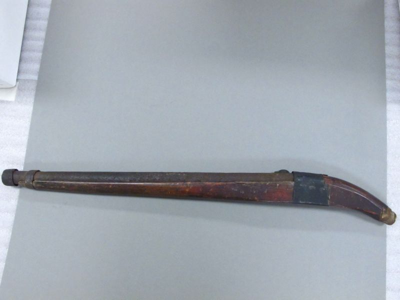

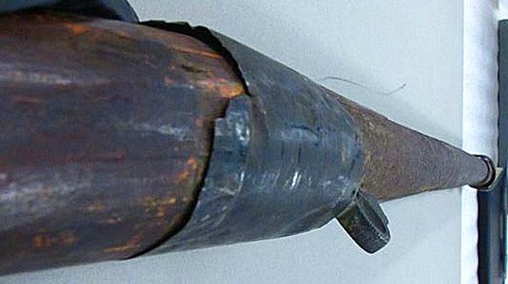

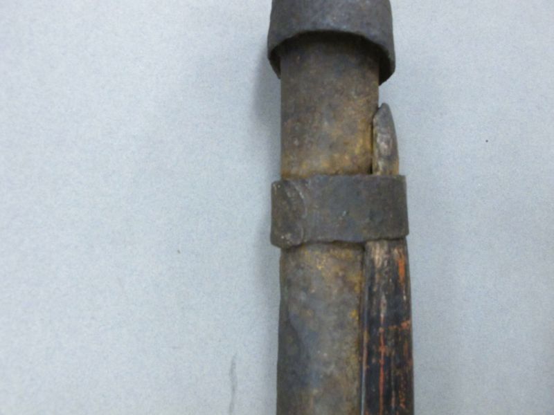

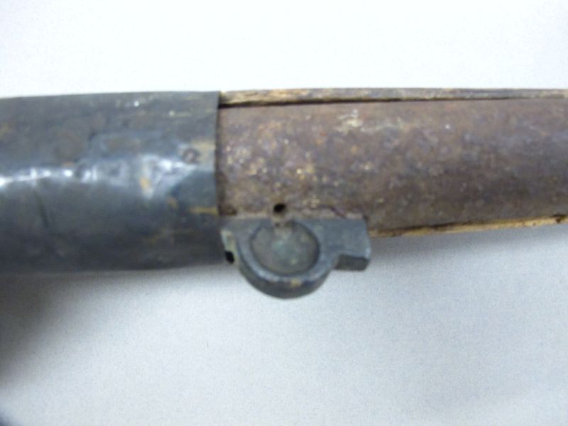

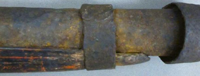

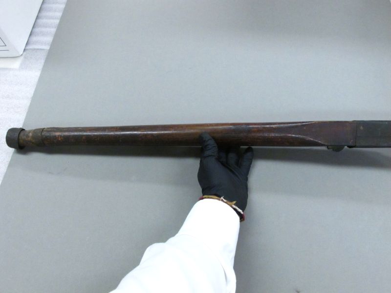

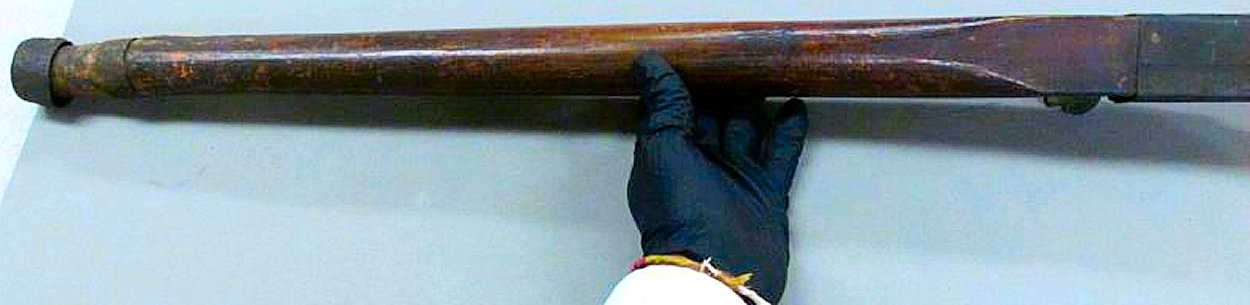

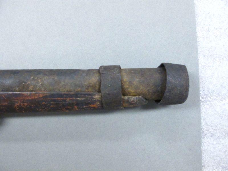

Hello all,
I am a new member, and this is my first post. I have been trying to identify an old gun for some time now, and although I have a degree in history, I am in no way an expert on firearms history. The gun was attributed as a "flintlock ball and cap type blunderbuss" of Spanish origin that is missing the lock, trigger, and stock. When I saw the gun, I doubted that assessment, because there does no appear to have been a flint lock ever attached, and there is no place for a trigger either. I think that it is probably a matchlock. I can't tell if it is a Spanish Blunderbuss (Trabuco) or not, and there are no maker's marks or any other distinguishing marks on the gun. The muzzle has a diameter of about 3/4", or 1 and 9/10 cm. Any help in identifying this old weapon or information in general would be greatly appreciated! Thanks in Advance

This looks like a early 20th century, perhaps earlier, hand cannon from south east Asia, a cigarette would have been the fire source.
This is just my uneducated opinion, hopefully some of the people with more experience may have an opinion.

Very impressive Aptheo, nice advance research before posting, and welcome to our forums!
I agree this is SE Asian, and though I am far from having any experience with firearms in general, this would appear to be one of the crudely fashioned 'Saturday night special' type guns used in Viet Nam. These seem to be versions of the so called 'Tonkin guns' used by highland tribes north of Hanoi, and other tribes collectively known as Montagnards.
There were many of these in the expected spectrum of variations brought back by forces in Viet Nam in the 60s, and while pretty rough, they are intriguing examples of the ersatz weapons used by these tribes in those times.

Thanks for the info guys! I am wondering, what exactly tipped you off that this is SE Asian? I am interning with a museum in Southern California, and they asked me to photograph the object for our records. When I saw the details, I began to question them. Aside from what's in my first post, apparently the donor told us that the object was found in Trabuco Canyon. Trabuco Canyon is so named because apparently a friar that was travelling with the Spanish Explorer Gaspar de Portola lost his trabuco while passing through. This would have happened around 1769-70. Since the gun is definitely not a flintlock, I was almost positive that this was not the trabuco of Trabuco Canyon (as was implied by the records) and thought it might be older, since it seemed to be some kind of matchlock. As I looked at older weapons, however, nothing really seemed to match. My guess was that it was some kind of home-brewed thing, or some kind of serpentine matchlock, but I had no way of dating it. If you could recommend books or sources that I could cite for research, I would be extremely grateful. The attached picture is from a Wikipedia article. It's a matchlock from Germany that I thought seemed a possible match. But since you both seem to agree this is SEA, should I re-post this in another section of the forum? Sorry my posts are so lengthy, this project has plagued me for months and I'm excited to finally get some answers.

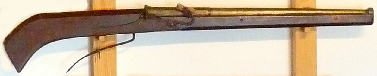

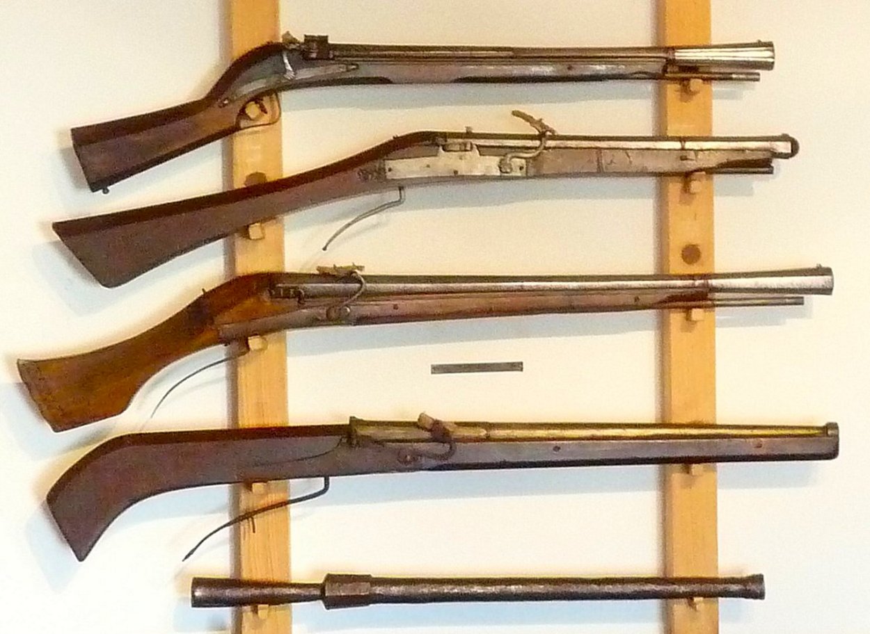

I have seen this style of wall gun used by the Japanese.These matchlocks were sold to them by the early Portuguese traders; as the Japanese evolved, it is not unimaginable that an obsolete weapon would be traded, sold, or stolen by another bellicose people of less martial sophistication.
The gun is a poor reflection on it's initial glory, however as a thing of great worth, it was modified, repaired, and patched, by various different owners painting a mural of many different owners and as such it is a beautiful canvas on which many wonderful stories can be inferred !

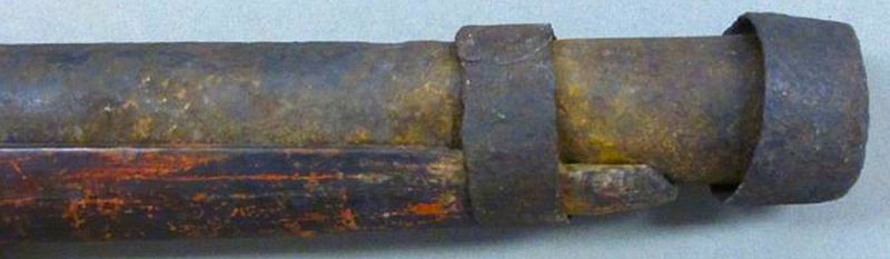

Hi Aptheo,
Sadly, it was only this morning that I only noticed your thread, and the highly interesting gun.
I am absolutely convinced that this is a late 15th century (the period of Columbus !!!) or early 16th century 'military' gun mounted with a wrought iron barrel, and stocked in a way which, just like the form of the barrel does - especially the form of the igniting pan and the muzzle - , that all point in the said direction.
This old piece has certainly seen service over maybe hundreds of years, and in the course of time has undergone some alterations and 'modernizations'.
I will comment more on this soon.
For today, I reattached your images, after some photshopping done.

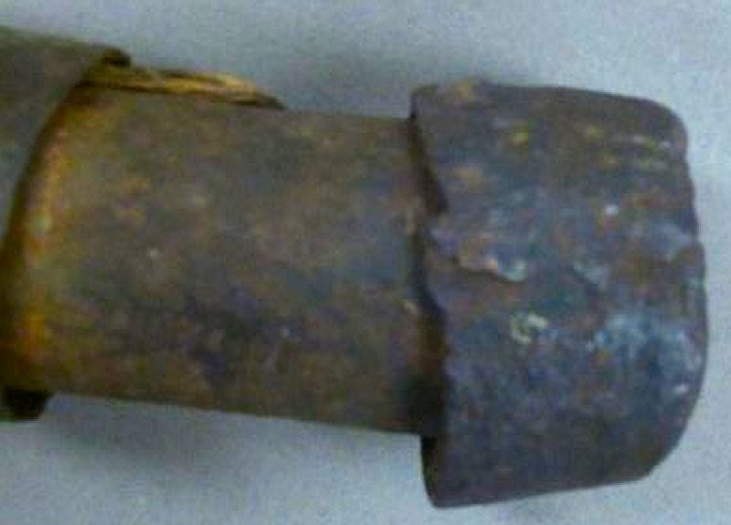

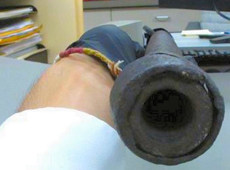

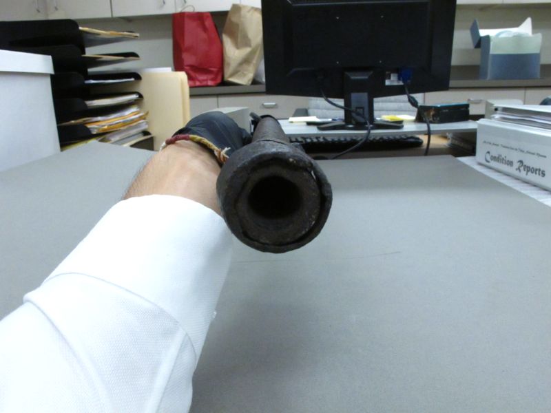

Basically, I do not exactly share your opinion that that arquebus in question originates from Asia, and was made there. The general shape of the gun, and features like the absence of a lock mechanism, all make me tentatively assign a very early date, and a European, maybe German, Bavarian/Franconian (Nuremberg?) background to it.
Before assuming that provenance with sufficient probability, though, I definitely need [[/B] needle-sharp high-resolution images of the gun, with a minimum of 7 MB per photo.
I also need to know the bore!
The brass pan is a later addition, and of Asian type - without a provision for a cover; the dovetailing for the original wrought iron pan, fitted with a pivoted swiveling cover, is still clearly visible.

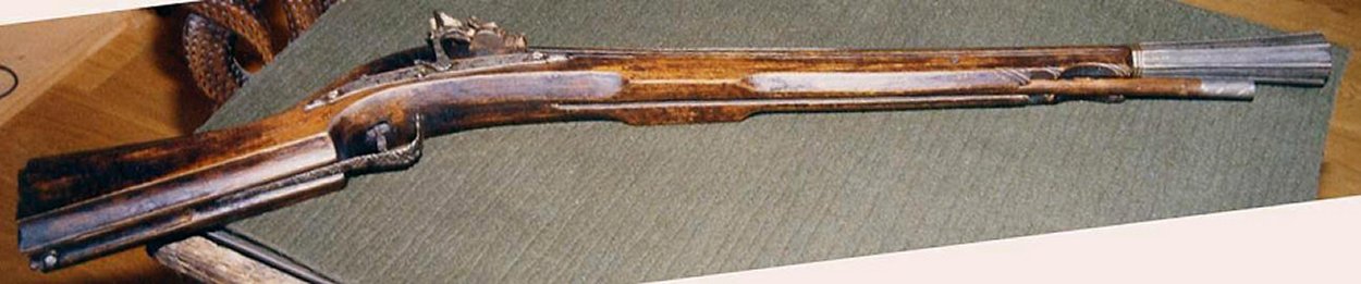

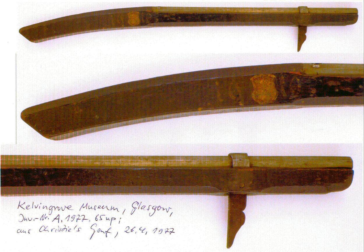

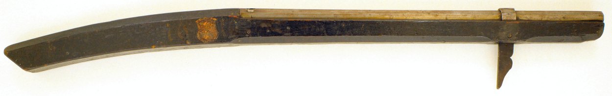

Arquebus is the correct term for this small 'long' arm, its overall length of only 33.5 in, equaling 85 cm, and making it longer than a fine and important German (Nuremberg manufactured) Landsknecht arquebus or Halbhaken, with a recoil hook, dated 1516?, preserved in the Kelvingrove Museum in Glasgow, inv.no. A. 1977.65 up, measuring only 74 cm overall (topmost three attachments):
http://www.vikingsword.com/vb/showth...ingrove+museum
For example, a fine Central Italian (Tuscan) Landsknecht arquebus of about 1520-30, in my collection (see three attachments), is 82 cm long, cal. 14 mm smoothbore:
http://www.vikingsword.com/vb/showth...necht+arquebus
