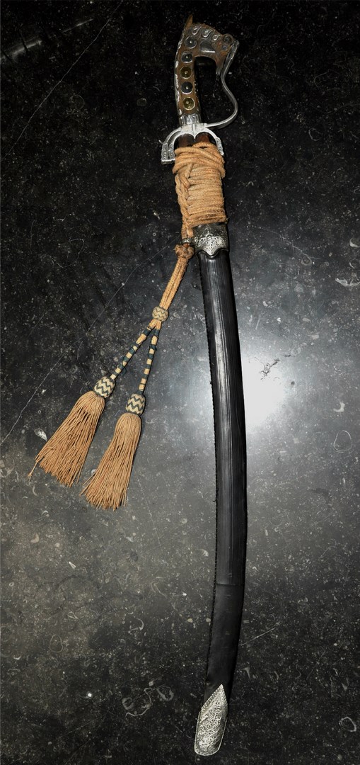

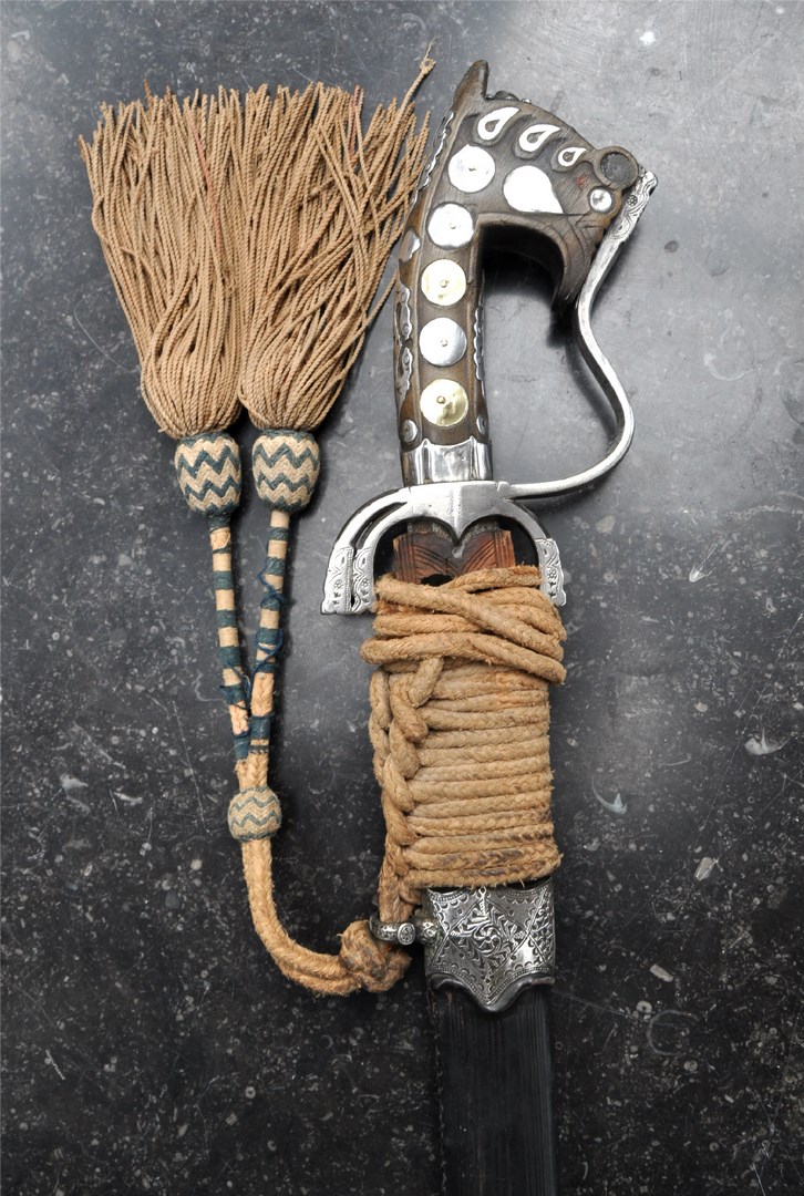

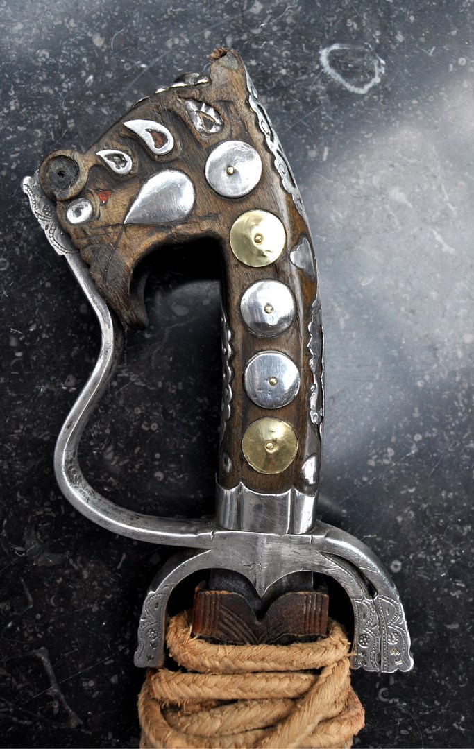

Hello to all members.
Can you help me to learn more about this "nice" saber that i've find 1 month weeks ago in a flea market in " La Louvière / Belgium ".
The flexible blade is marked (European mark may be). The handle appears to be rhino horn and silver. Traces of red lacquer in the etched silver patterns. the scabbard is in wood covered with skin. I seem to be in good condition. The rope is faded but it was red and blue.
93 cm long for all
68,8 cm long for the blade
Thank you for your help and see you soon
Fabrice

Belgian1:
Welcome to the Forum.
That is a nice looking nimcha that you have shown--a nice find at a flea market.

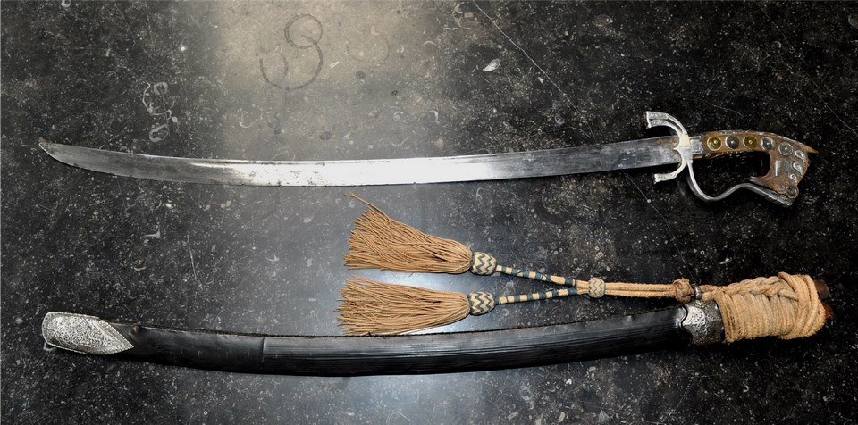

Would you also post a picture of the complete sword outside of the scabbard. That will help the experts on this Forum to better identify its origins and style.
Ian.

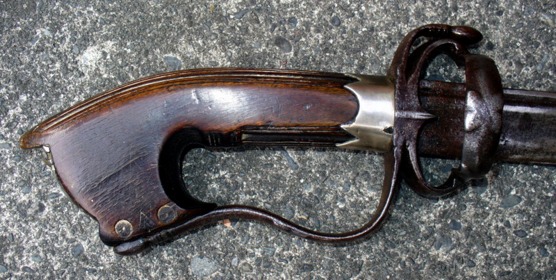

Posts: 2,833
Default Welcome
Hi Fabrice, and welcome to the Forum.
A VERY nice NIMCHA sword. Not necessarily from Zanzibar. The so called "Zanzibar" Nimcha usually has a D shaped "guard" as shown here.
Stu

Old 14th August 2015, 08:13 PM   #8
Belgian1
Join Date: Aug 2015
Location: Belgium
Posts: 52
Default Arabo-Ottoman sword
Hello to all, from Belgium :-)
I hope that this pictures can help you
Merci beaucoup Ian and Kubur :-)

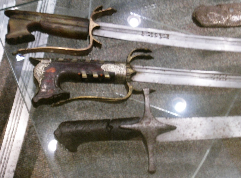

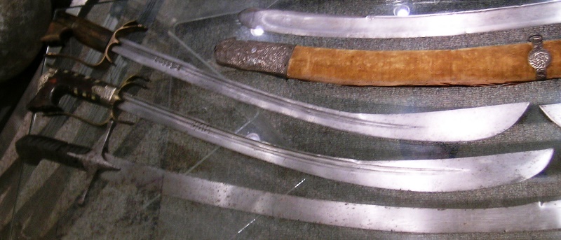

North African, possibely Algeria or Tunisia. Note a similar one (fitted with an earlier cutlass blade, and a plain guard), from the captured weapon section in the Palace Armoury of Malta.

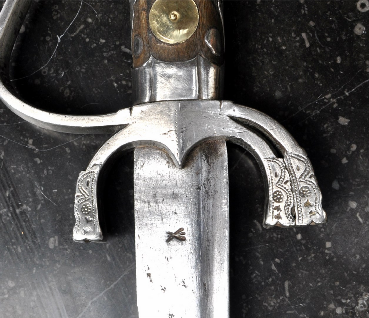

Actually these fascinating sabres with this characteristic type hilt and the guard system with downturned quillons are of an apparently broadly represented form which are from 'Arab' regions and cannot be classified to a specific one aside from based on individual merits of each example.
The plates in Buttin (1933) illustrate numerous examples of this spectrum of examples of these sabres, which are invariably captioned as Arab swords, sa'if, by him in his text. He has identified them with date ranges as early as end of 16th century and through 18th, but no specific identification toward a 'Zanzibar' attribution is made, and particularly not with reference to the noted 'ring' projection from the guard. This in my opinion is a European influenced element which appears to have derived from developing rapier guards in Italy, and has been added to the guard system which had already evolved from other Italian forms earlier (16th century as noted) .
In my opinion, the 'Zanzibar' attribution derived from probable misassociation from individuals who read text in the Buttin reference regarding actually items numbered 1032 and 1033 (plate XXXI). These were pogniards which had been classified in error by Burton (1884) to Zanzibar, following an earlier error by Demmin (1877). In actuality these were s'boula daggers from Morocco (as well known by Buttin from his many years there), and he well footnoted detail in his 1933 catalog. Unfortunately this detail toward the 'Zanzibar' issue with these daggers was footnoted on the same page as sa'if #1034 (plate XXXI) which coincidentally HAD the noted ring on the guard.....and directly below the text.
While such a simple and unfortunate proximity error could result in such a broadly noted assumption seems almost bizarre, but as can be seen, this is how arms lore becomes legion.
I think Ibrahiim well illustrated how one example with apparently distinct decorative motif can isolate in degree, and by singular merit, at least one of these sabres to likely Zanzibar provenance by using the comb's motif compared to the grip on the example.
As far as the broader spectrum of these hilts, I think that the Arab denominator and sa'if works best, and that examples should be classified based on specific qualifiers such as motif or any other distinguishing elements attributable to certain areas or cultures.
With note to the related etymological dispute over the term 'nimcha' which has become standard collectors nomenclature for these sabres as Moroccan, this has been well explained by Louis-Pierre some years ago as a dialectic variation essentially meaning 'small' or 'half' sword. This apparently may have come from, once again, association with the shorter, flared tip examples with these kinds of hilts (993.994.995, plate XXX) which were indeed of cutlass form, but are classified only as Arabian sa'if. While it is tempting of course to associate these with nautical weapons by the size and form of blade, this can only be a presumption unless otherwise proven (such as examples from Malta shown by Broadaxe in #16, which are of course likely from maritime use).
The 'dragonhead' terminals are traditionally regarded as of Ottoman influence. As noted the cord is typically associated with North African mounting affectation (i.e koummya and others).
The mark at blade forte seems to be more of a 'chop' mark which may emulate the well known European 'twig' type marks often seen on Italian and Styrian blades.

Salaams Belgian 1 The mark on the blade... Oddly enough this is a very similar mark to the Omani Emblem but is in my opinion not related at all...since it is ...I believe ....the fly mark (or twig mark) seen on European blades and seen at http://www.vikingsword.com/vb/showth...=anthony+North
I recall this mark being attributable to Peter Cull... Wheres Jim?.... although a lot of marks were also copied or used by a lot of different craftsmen ..
Ibrahiim al Balooshi.
