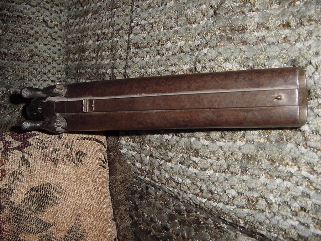

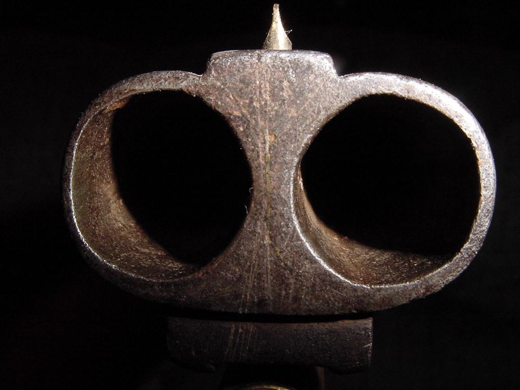

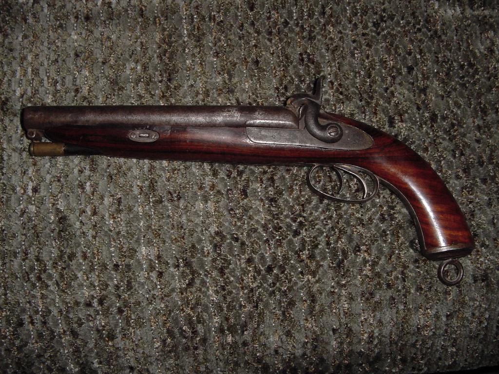

First, congratulations Bill, your in for some shooting fun. I got this one in the 60s in Kohat pass in what was then Northern West Pakistan. It's stock was broken as was one hammer,etc. No makers name but lots of British proof marks.
It's been shot a lot with a black powder load equal to a twelve though the bore is about 5/8 on an inch. They push hardily but, not like a 454.
Unlike yours this has an odd oval bore. they cut two rounded lands in it that spiral the ball. It may have been Naval as at one time it had a swivel ramrod. British Officers favored a big a bore as they could shoot, in controlling the locals. Thanks for the reminder it needed dusting.
Steve

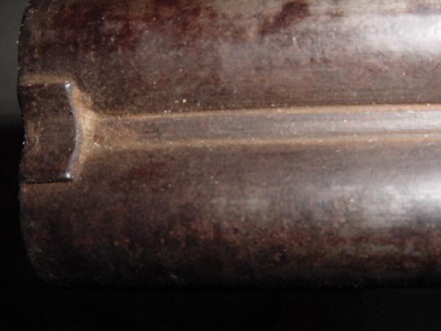

Neat pistol! A few questions,
What is the lug near the muzzle?
Was the swivel ramrod exclusively naval, or did cavalry also have them -- so as not to loose the ramrod while re-loading on horseback?

Or could the lug of this 'howdah' have been for a resource bayonet ?
... just my fantasy

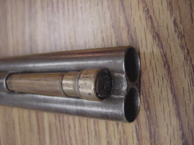

Default Howdahs
Gentlemen, Each of you brought up good points, swivels for single barrels were simple. Double barrels used single ram rods but had a second swivel of sorts to facilitate reaching both barrels. I wasn't able to find a clear example. Here are shots of double shotgun barrels where they use a bridge between barrels to act as a catch for their rods. The third shot of Bill's gun doesn't seem to have that feature so as a guess I'd say that the button like thing in the brass stock fixture is some sort of locking detent. Steve
