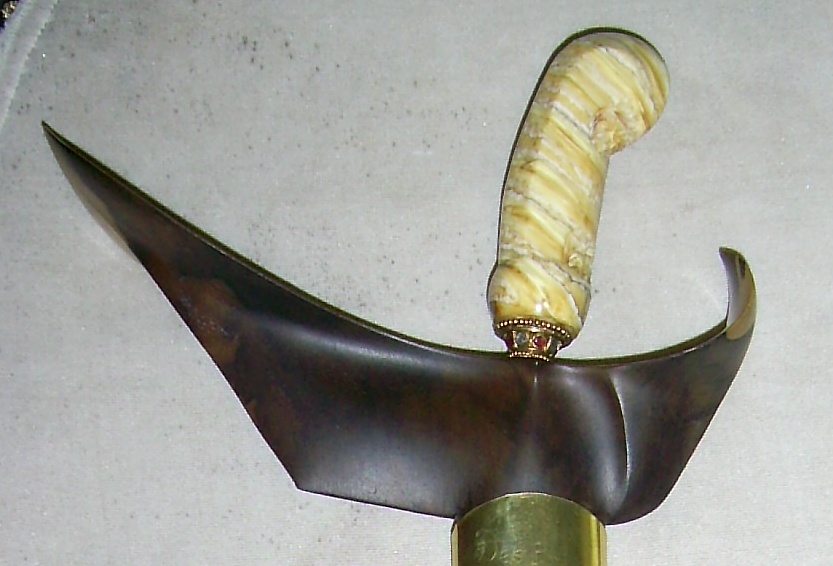

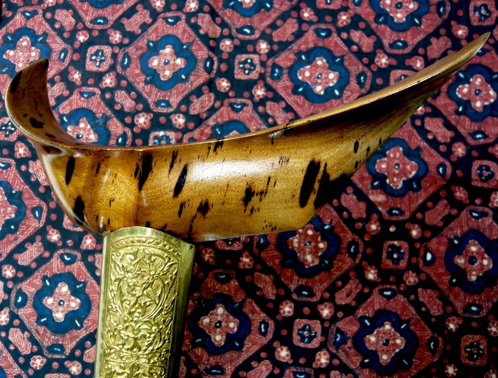

Hi...
According javanese people that believe about good timoho wood for keris sheath is that wood has pelet. What is pelet actually? Is it those black spots on the wood?
bre

if most part of sheath is dominated by pelet, what its motif name?
warm regards, OeS

Yes, and there are other names as well---some invented on the spot because they will either A)--help to raise the price, or B)-- help to raise somebody's prestige.
In my notes I do not have an example precisely the same as the wrongko you show, but if we look at this wrongko, essentially it has dark in the center of the body, and light on either side. Perhaps this conformation could be classified as timoho slempang---a slempang is a strap that is worn over the shoulder.
Or maybe the dark area is too wide for timoho slempang, maybe we should call it timoho sidi---but really, that would be stretching it because the white is in the wrong place. Pity it has those two light spots on either end, without those we could give it as bosokan.

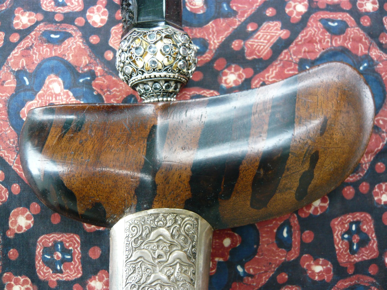

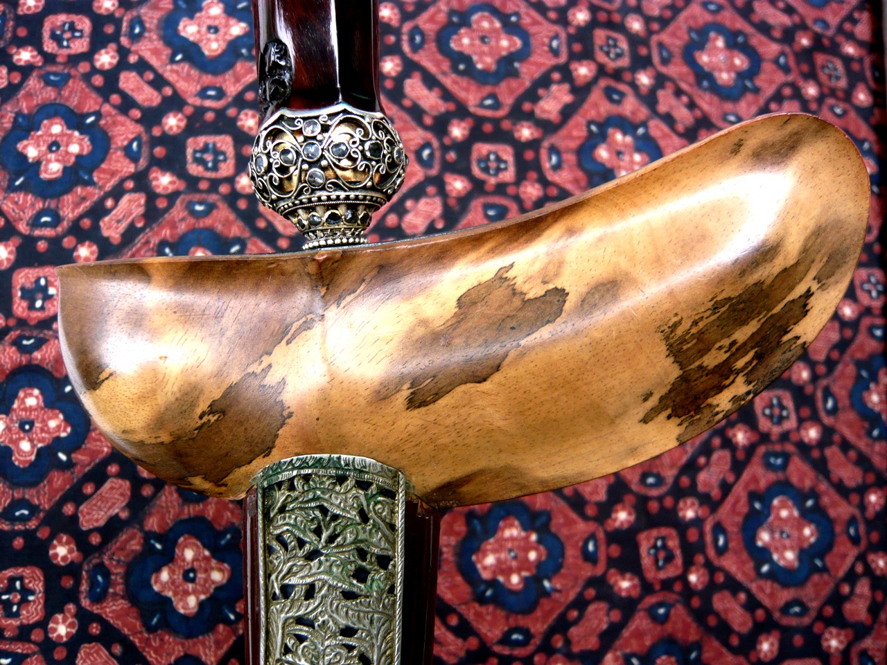

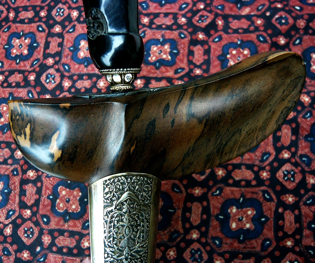

Some timoho sarongs with different patterns....

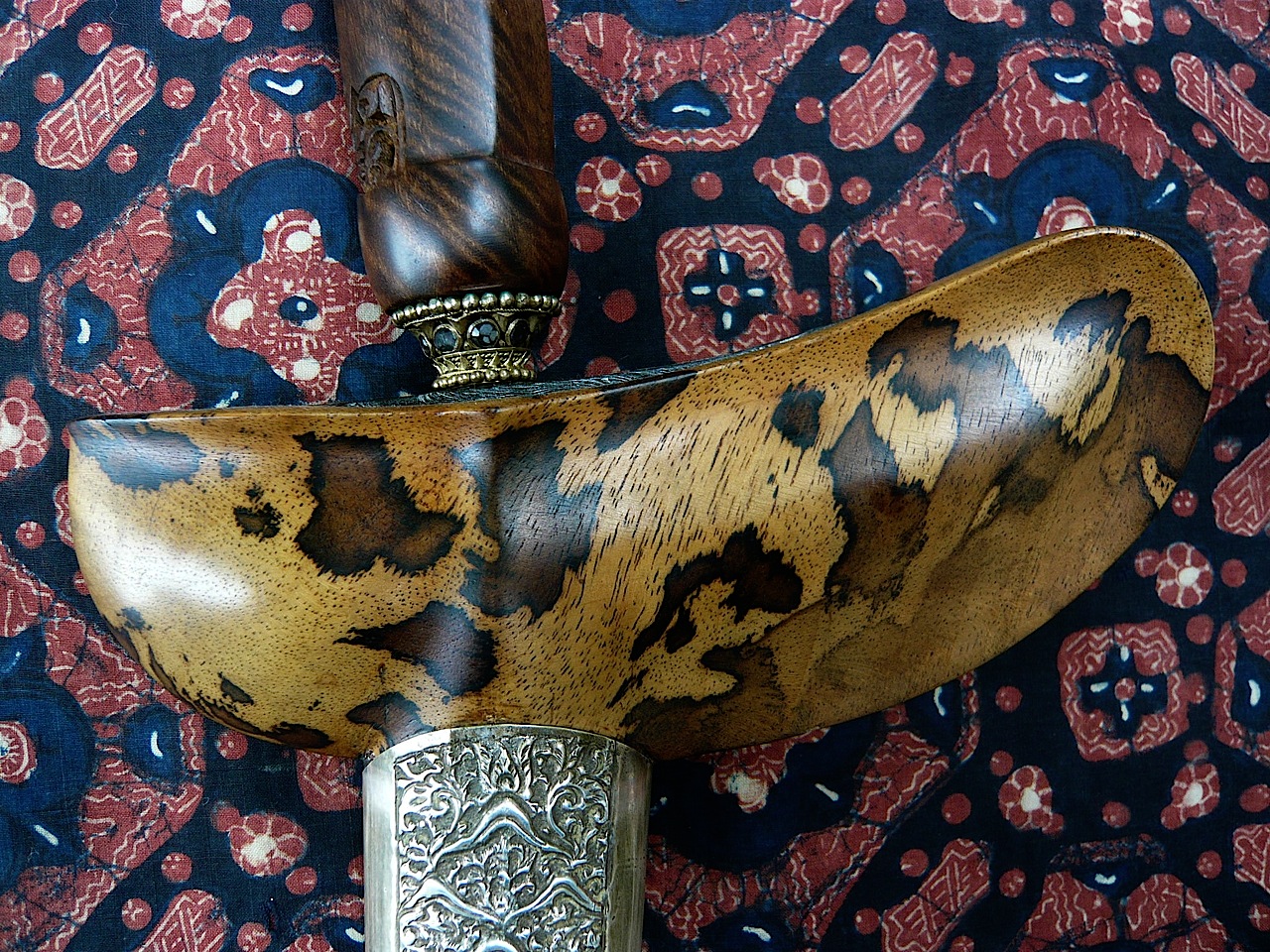

Marcokeris's Avatar
Location: Italy
Posts: 928

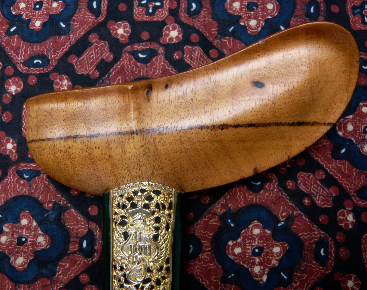

....others

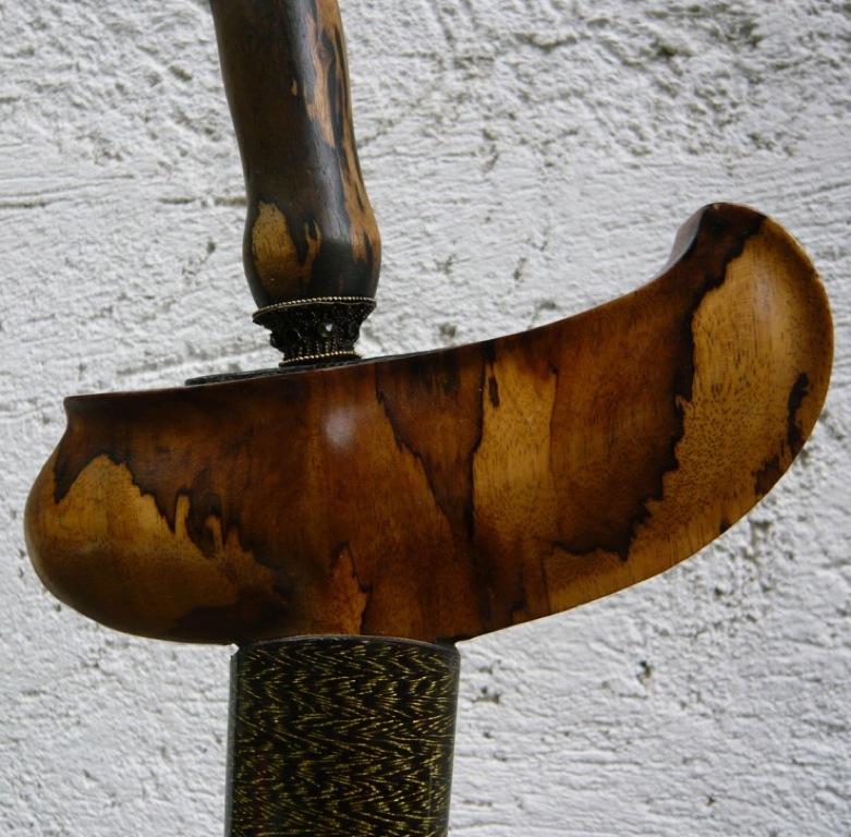

Marcokeris's Avatar
Location: Italy
Posts: 928

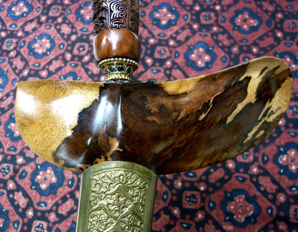

one more

To Marcokeris...
By the way..love the mendaks on the pics.
