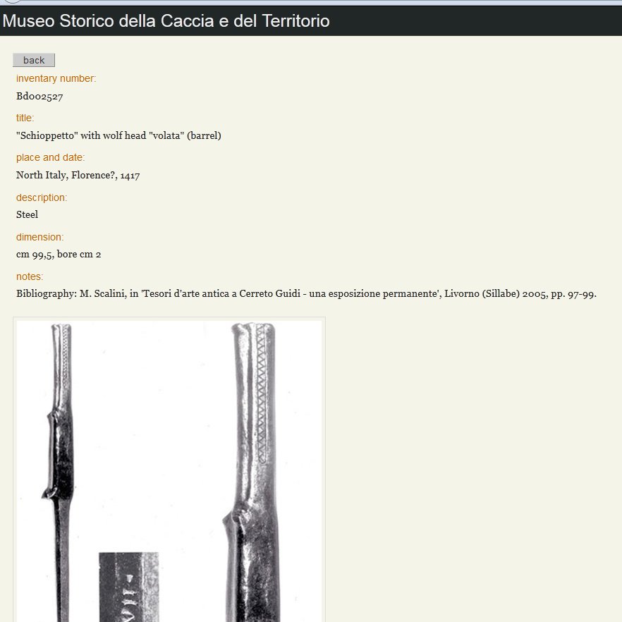

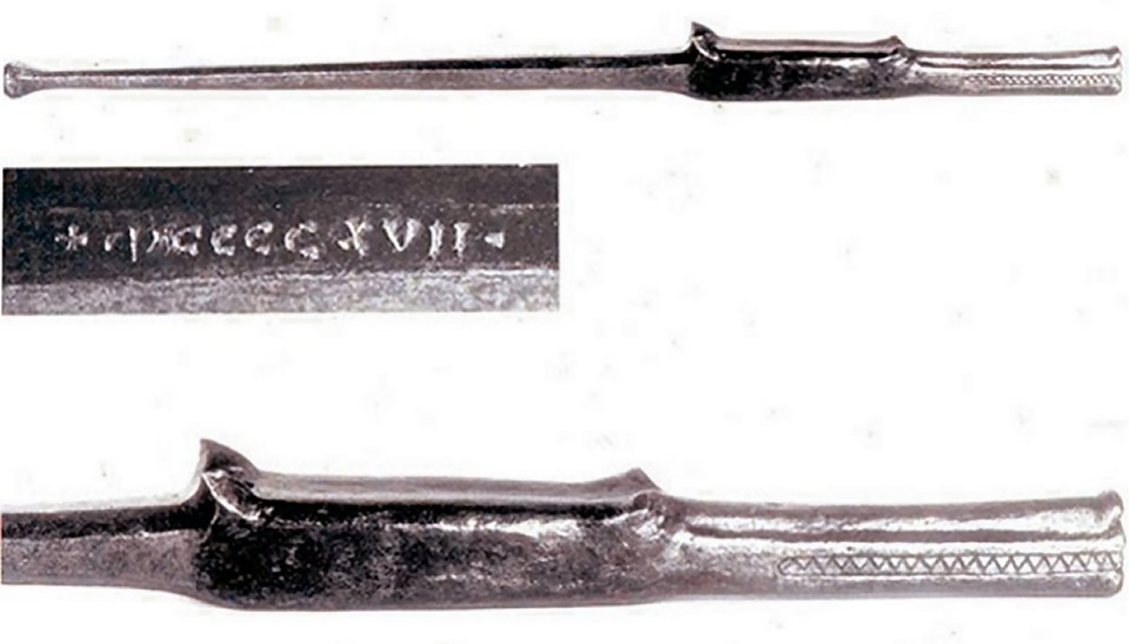

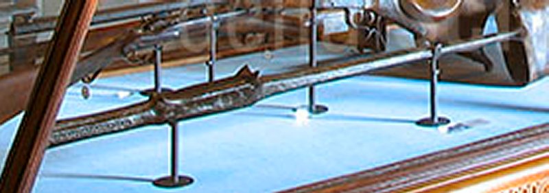

This highly important and finely wrought iron tiller gun is preserved in the Museo Storico della Caccia, Villa Medici, in Cerreto Guidi, near Florence, Northern Italy.
It is hardly known in weaponry and shaped like a fire breathing sea serpent or dragon in the characteristic Italian taste over all its length, the wrought-iron tiller terminating in a swamped knob. The barrel is wrought as the serpent's head, with ears, eyes, teeth and mouth all clearly defined!
The museum interprets its shape as that of a wolf's head. Given the fact though that the muzzle of a gun would literally breathe fire, the embodiment of a sea dragon or monster is much more probable.
Its length is 99 cm overall, the bore is 20 mm.

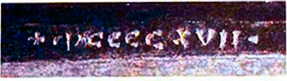

The date 1417 is, due to its late High-Gothic period of manufacture, at the very threshold to the Italian Early Renaissance, still represented by Gothic miniscules in the Latin tradition of writing numerals, becoming obsolete in the early 15th century:
+ m c c c c x v i i -

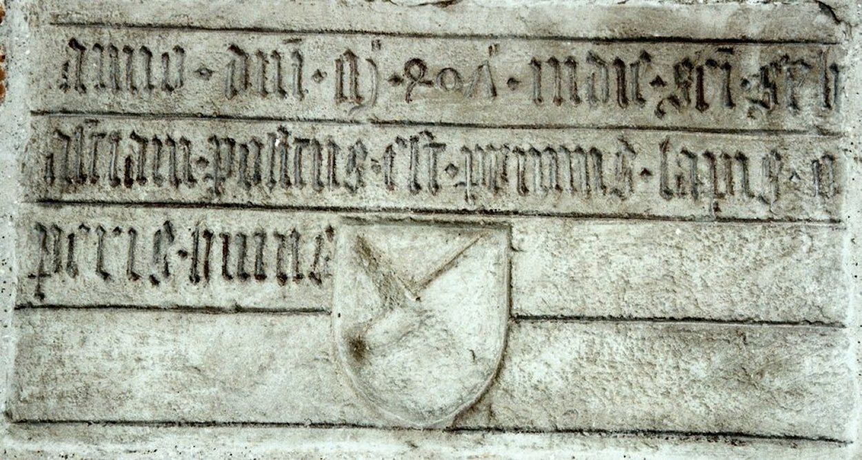

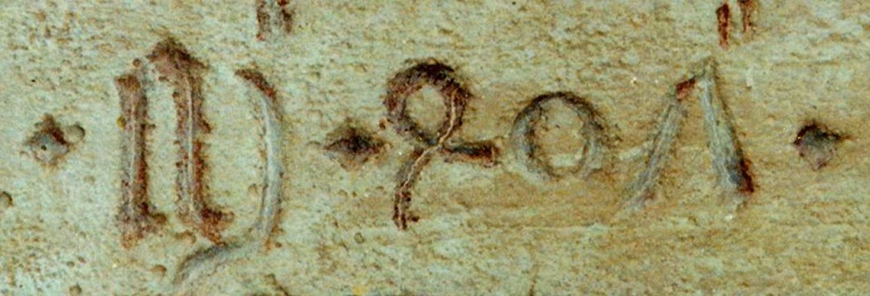

Also note a frequently employed mixture of the Latin and Arabic numerals in the early 15th century; attached is the sample of the founding inscription of the Church of the Holy Spirit (Heilig-Geist-Kirche) in Landshut, Lower Bavaria, where the founding date 1407 is composed of the Roman m for the cypher 1 while the rest is written in Arabic numerals!
