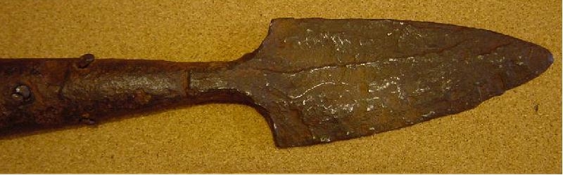

Having posted this piece over two years ago in the Forum, its identification wasn't conclusive.
Then i showed it to someone with knowledge in antique weapons, although not necessarily on this type of pieces; he has dated it 16th century and called it a hunting lance. I didn't ask his opinnion on its provenance, as i had previously assumed it is Portuguese; at least it was acquired by the seller in a street fair, in the interior north of the country.

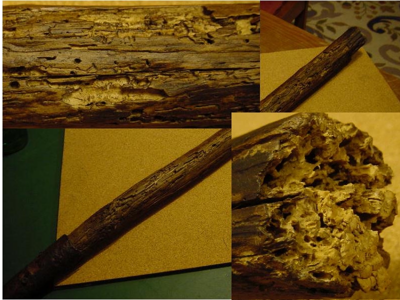

I empiricaly found the date quite plausible, due to the blade rusticity and the incomplete haft, all damaged by worms and with an intense patina, which i stupidly washed out with the overuse of worm killer liquid .

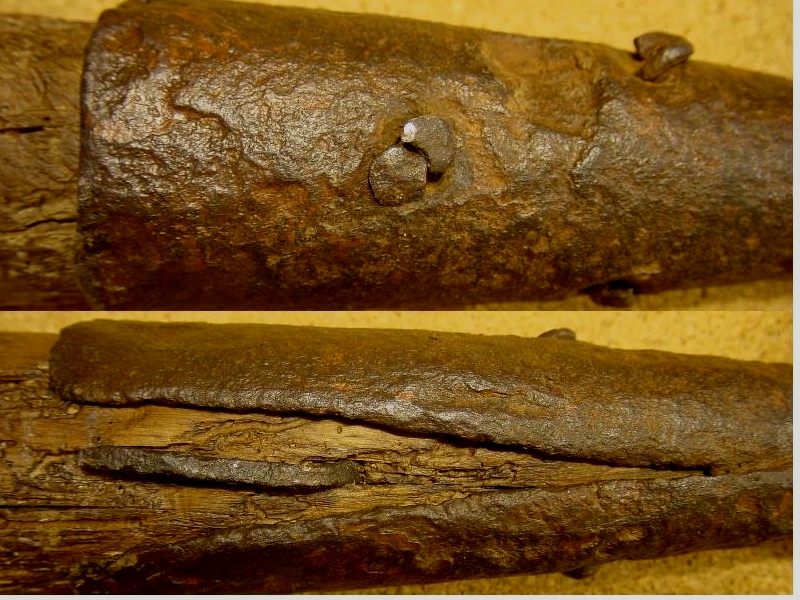

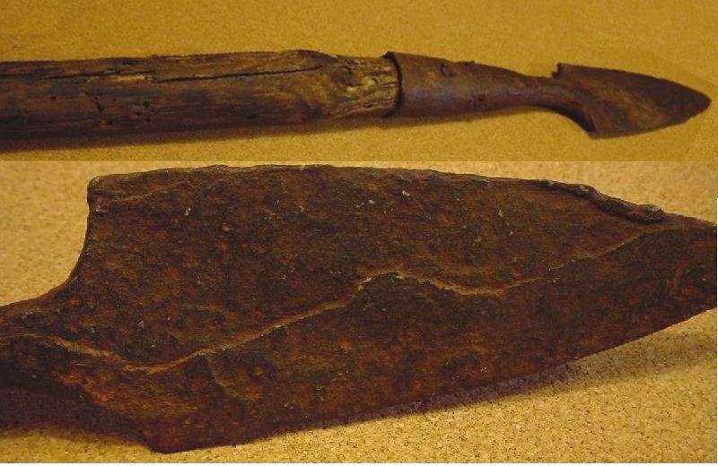

The most amazing part is the way the blade is made; it is reinforced with an extra longitudinal plate, heat welded to the basis, but only in half of it. Each face is reinforced in the contrary half side.
Anyone here familiar with this type of items ?
Could this actually be an ancient Portuguese home made Ascuma (hunting lance)?
Coments will be so much wellcome.
Fernando
Blade length 34 cms. including socket. Width 7 cms. The haft stump is 4 cms. in diameter and still measures 67 cms. in length.

At the base of the blade they used to attach pieces of cloth, with flocks or hair tufts, to protect the hand from sliping with the animal's blood. It could be that the small nail like pins on this blade socket had that purpose.

What in fact i keep expecting to learn is more on the metalurgic side ... like whether the particular way this blade is constructed may be 'classified' and considered an indicator of its age ... assuming it is indeed so old as XVI century.
