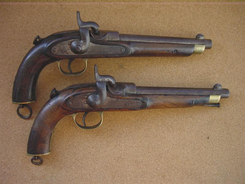

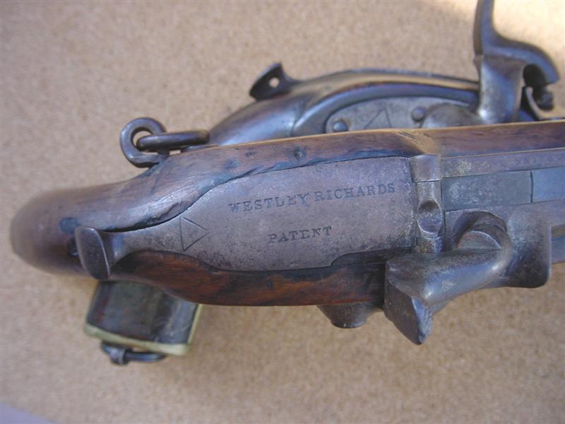

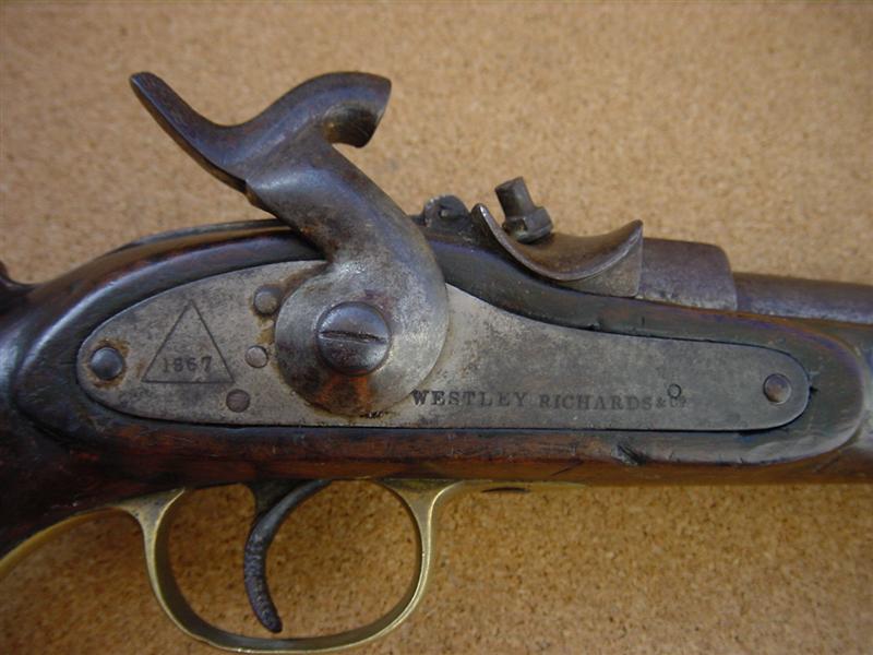

Yes. No more than a thousand of these were made by Westley Richards for a Portuguese contract, in 1867.
This pattern, called monkey tail, due to that peculiar breech lever, was already obsolete, when it was supplied and distributed to the Portuguese cavalry regiments. When this famous gunmaker introduced this breech loading system for percussion guns, some ten years prior to this date, the idea was revolutionary, but soon front loading and ignition cap were condemned, in favor of modern systems, like the metalic cartridge and center fire.
Apart from some pistol prototypes, namely the ones presented to British Ordnance ( without success), it seems as only rifles were produced with this system, except for the said 1000 pistols ordered by the Portuguese Government.
Fernando

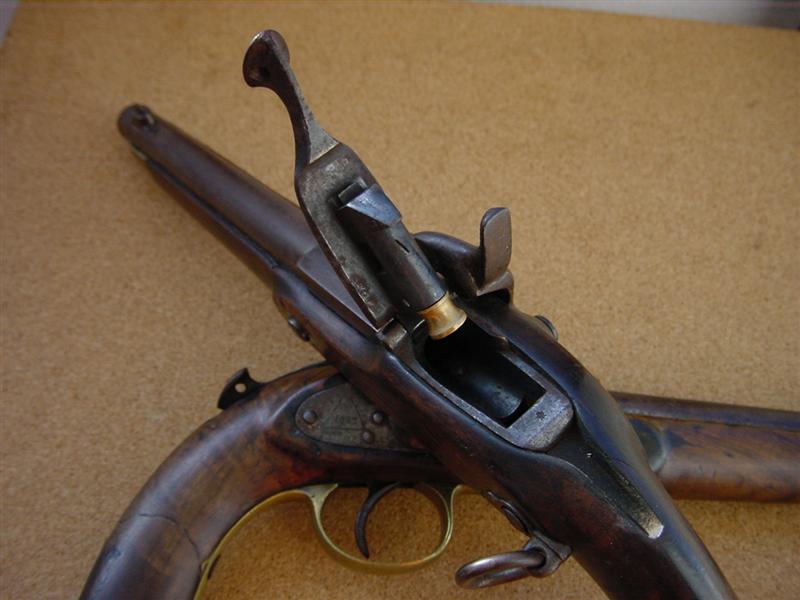

How did you load those guns? Is that sort of a preloaded reloadable cartridge. within the chamber?
Old 20th September 2008, 12:50 AM   #6
Allright guys, those words brought me some confort
Manolo, these guns were loaded with paper cartridges (with enclosed bullet), that were placed at the breech chamber. The nipple holes had a capillary section, so that the percussion cap flames passed through like a jet, strong enough to perforate the cartridge covering, and ignite the charge. These cartridges were first made of skin (intestine) and later with combustible paper; in both cases covered with a disposable (tear off) outer layer. When placing the ammunition into the breech and closing the block, a bronze plunger placed under the lever pushes the cartridge into the barrel, at same time acting as a seal to prevent gas from escaping through the breech. But the revolutionary concept in this system is that the cartridge itself carries a wad, gummed in its bottom so that, when shooting the thing, the wad completely seals off the gases, optimizing the shooting power. And when you shoot the second round, the prior wad is expelled through the barrel, acting as a bore cleaner.
