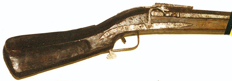

The one on top with the snap-matchlock was made in Tusco-Emilia, Northern Italy, ca. 1520, the finely carved barrel bearing an E mark also found on cinquedeas of early 16th century date. This one my well have seen use in the Battle of Pavia in 1525. For comparison, I attach a detail of a ca. 1540 Brescia/North Italian harquebus of three in the Royal Armouries Leeds, inv.no. XII.5315.
